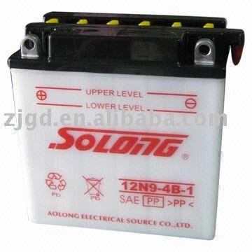

First thing you'll want to do is to check the level of the electrolytes in the cells
https://p.globalsources.com/IMAGES/PDT/B1091578118/Lead-Acid-Dry-Charged-Motorcycle-Battery-12v-9ah.jpg
If any of them are below the lower level mark, top them up with distilled / deionised water which you should be able to get from a garage, a moderate sized supermarket or at a pinch Halfrauds.
Next, while it's charging, get yourself a cheap multimeter and work out why it's flat. I'd take a wild guess that the charging system is hosed, and the seller just charged up the battery enough to get rid of it.
Don't just start throwing random parts at it, you can easily turn a simple fix into a very expensive one.
Once the battery is charged you should get a voltage of about 12.5V across the terminals. With the engine running, it should rise to about 14V, maybe a little more if you rev it. Much above or below that and you've got a problem, and we can take it from there.
