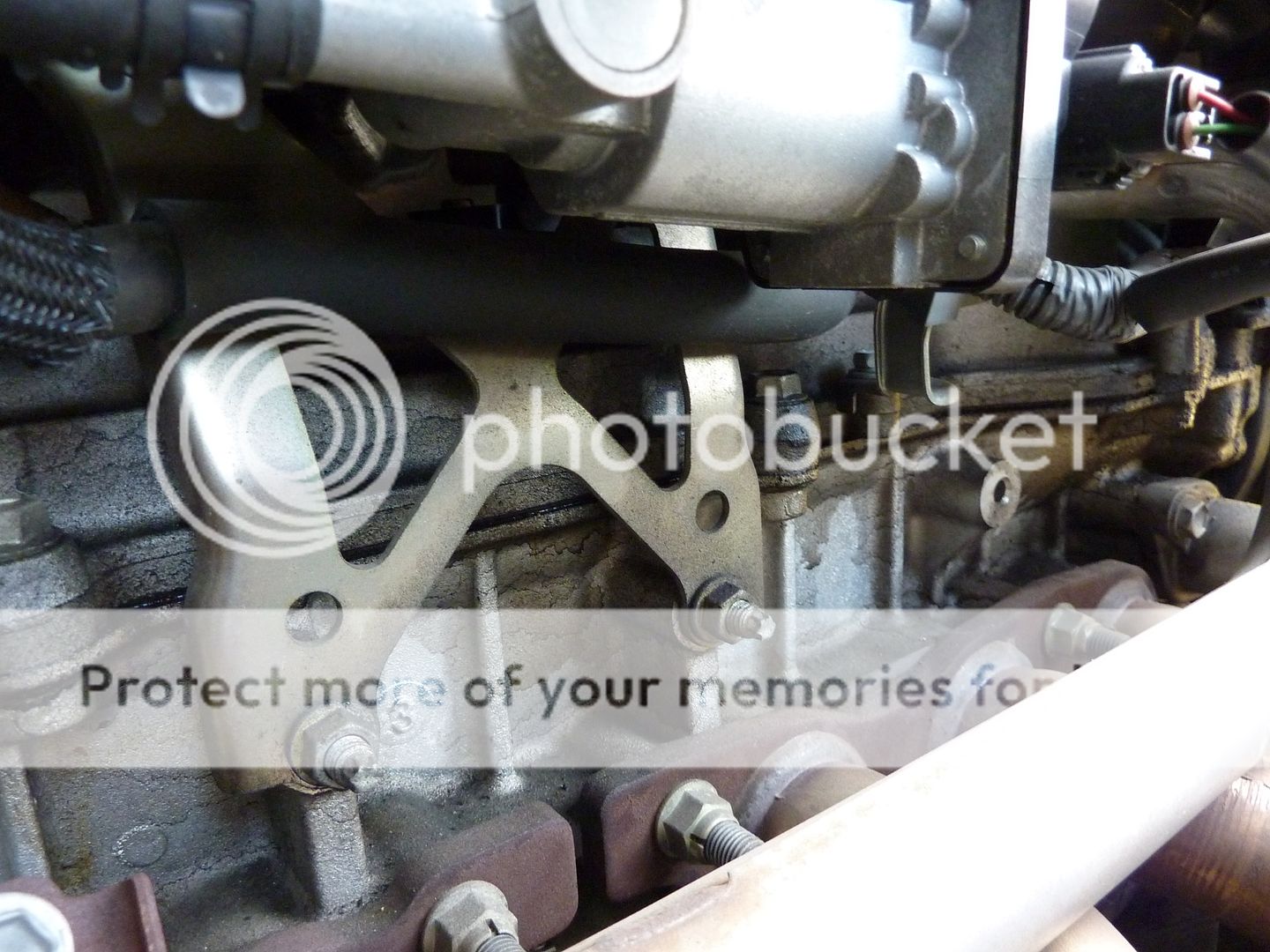

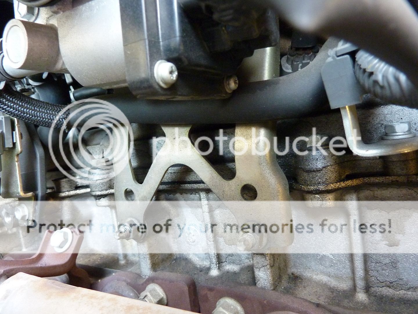

My 2005 toyota brevis (59000miles) is going to MOT(shaken) 2 weeks later. Toyota dealer suggested me
-timing belt change
-water pump change
plus
-cylinder head cover gasket change(oil is seen on the cover)
I am going to ask belt and pump change,
but I am wondering if I should ask gasket change too or not.
I read somewhere that changing gasket sometimes worsen oil leak.
Would you ask gasket change too? Engine looks like this now.
Clearly it leaking past the gasket. So how would not changing it make it better?
Maybe cleaning the surfaces and reseating may help. But for the cost of a new gasket, is it worth the risk of it having to go back to be replaced again if it still leaks afterwards.

iooi wrote:
Thanks iooi, I will ask gasket change too. I couldn't tell how not good this was.
I'm thinking of driving this car till 125k miles, so added cost is negligible Thumbs Up
Maybe what I read was the case done by dodgy method, I think genuine Toyota dealer will do it properly.
Total MOT fee estimation will be from £1500 to £1700.

PostPosted: 10:23 - 03 Sep 2016    Post subject: Reply with quote
I personally wouldn't bother changing the gasket at all. It's a very slight misting of oil when all is said and done. If it got more severe I might think about it. There is WAY more oil on and around the engine block of my work van and I don't give it a second thought.
There again, I don't much care about cars anyway.
Thanks stinkwheel, this time I decided to ask gasket too, went to the dealer and asked them to change gasket which I canceled on the phone without watching the engine yesterday.
At first I thought I may postpone gasket change till around 85k miles, but decided to do it earlier this time, cause I'm aiming to drive this car till around 125k miles which is double of present 59k miles.
