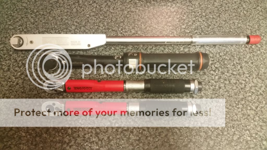

PostPosted: 11:51 - 01 Jun 2017    Post subject: Reply with quote
Teflon-Mike wrote:
As such, MOST useful torque wrench for M/C mechanics will be a LOW RANGE, 0-25Nm sort of region, ad that will likely be on a smaller 1/4 drive rather than larger 3/8 or 1/4".
For the likely use, a 'cheap' £30ish example from Machine mart aught be more than good enough;
The cheap £30 machine mart one in this range is actually £39.59 On the other hand the Teng 1/4 is on Ebay for £44.25 and I recently got one for £34
Teflon-Mike wrote:
I bought a real cheap and nasty (high-range) one, when I was about 18, as didn't have a borrow in a hurry; Twenty years later, I won a rather fancy Teng one,
See comments above
Teflon-Mike wrote:
But, as said, great for dong car cylinder head bolts, or disc brake mounting's; 25-250Nm torque-wrenches really aren't needed very often on a motorcycle; 1/4" drive 5-25Nm low range wench is far ore useful, far more often; ad that £30 Clarke fro Machne mart s an K example; get a couple of rails of 1/4" scokets to go with it, and keep just for the tQ-Wrench; £50 job-jobbed.
I agree a 25-250Nm torque wrench is next to useless on a motorcycle BUT torque wrenches aren't rated by the socket fitment size and the range of use can vary enormously.
I have 4 torque wrenches as follows
https://i945.photobucket.com/albums/ad297/750RK/Odds%20and%20ends/20170601_111717_1496313144525.jpg
Britool EVT 600A 1/2 10-50 lbfft 12-68Nm
Halfords 3/8 6-45 lbf.ft 8-60Nm
Teng 3892AG-3/8 E1 4-18lbs.ft 5-25Nm
Teng 1492AG-E 1/4 4-18lbs.ft 5-25Nm
So to say 3/8ths as you later do is neither here nor there is incorrect.
A 3/8ths is likely to be more useful than a 1/4 of the same size, most people would at least have a decent range of sockets in 3/8ths rather than a cheap set of 1/4 that someone got them for Christmas.
So when choosing a torque wrench the first thing to do is look at the range you need and then look at the drive sizes available.
