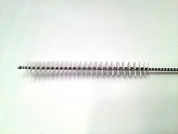

A pipe cleaner, perhaps?
https://images-na.ssl-images-amazon.com/images/I/91m8soF%2BTaL._SX355_.jpg
