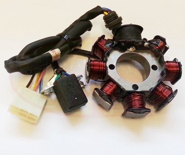

Not sure I trust that diagram as that shows a DC powered CDI ignition
not an AC powered type
An AC powered type would have a source coil at the stator
Ebay says this thing below is an Hn125-8 stator and you can see the source coil at the top and the black box to the left is the pulser
https://i.ebayimg.com/images/g/n-cAAOxyzi9Smg-R/s-l1600.jpg
A stator that conformed to your diagram would only have the charge coils and pulser
You need to establish what it is you have before you can start to debug it
AC source coils usually have a resistance of say 200-400 ohms

I have taken the stator off, and it looks the same as that, with 300 ohms.
The wires were nicked and showing the core on 3, I taped them all up.
I've rubbed the frame down, and put the original coil on and nothing else other than cdi, and its now running off the kickstart.
I am going to had each electrical part back and see if it falls over again.
