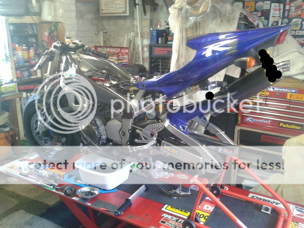

Love my 5JJ R1
https://i666.photobucket.com/albums/vv23/WiNot_Rhencullen/Honda%20750/My%20bikes/Picture110.jpg

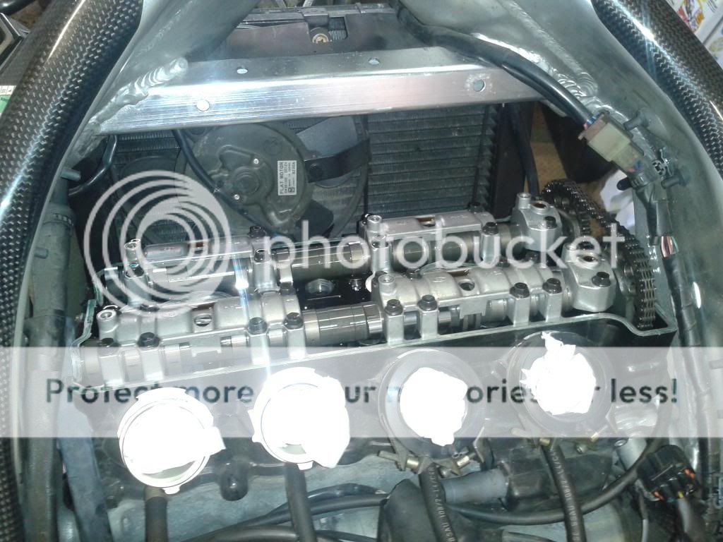

As said,the valve clearances will need doing around the 24k interval but they are easy to do
https://i666.photobucket.com/albums/vv23/WiNot_Rhencullen/Workshop/2013-04-16173658_zps6dc46b75.jpg
https://i666.photobucket.com/albums/vv23/WiNot_Rhencullen/Workshop/2013-04-16173638_zps93a3b3dc.jpg

i have gone over this R1 and filled all the connector blocks with electric grease to prevent any water/moisture getting in and causing any problems
i have done just over 5000 miles since the reg rec issue and my modification and have had no problems since.
Fizzer Thou has done over 15,000miles with the same mod and no issues since either
