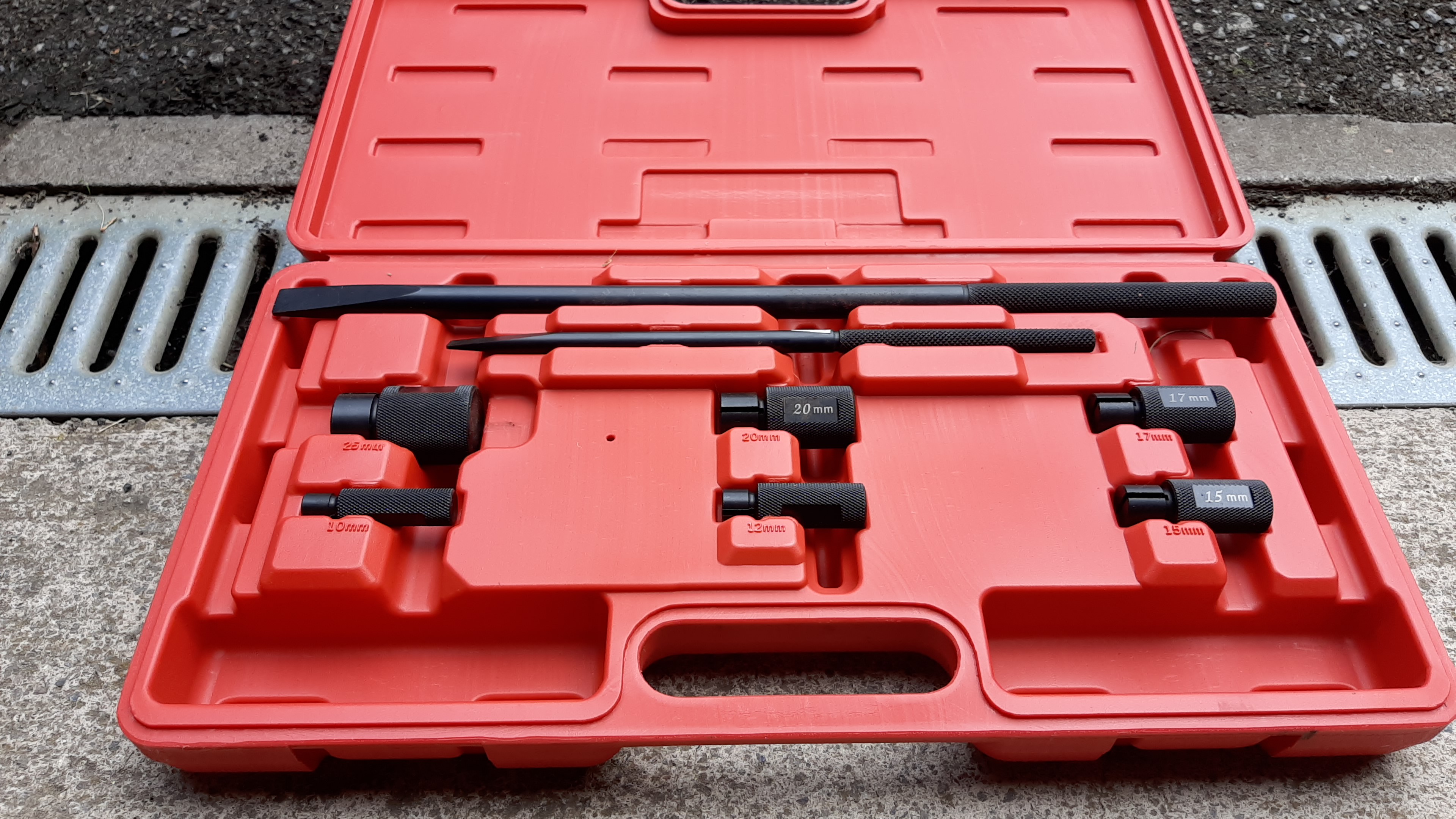

PostPosted: 14:48 - 03 Jul 2023    Post subject: Reply with quote
With this.

PostPosted: 17:38 - 03 Jul 2023    Post subject: Reply with quote
Assuming they're like other Hondas of the era, there should be no circlips, just a bearing each side pressed as deep as they will go, with a sleeve in between to prevent side loading.
The wheel can corrode around them, making a tight fit into an even tighter fit. It is also hard to get purchase at first because the sleeve stops you getting a good hit on the bearing.
Make sure the wheel is well supported on wooden blocks, use a suitable drift (and old flathead screwdriver to start off) and use a big hammer. 5lb lump hammer tends to work.
Heat can help, but you're more likely to damage the paint/powder coat on the wheel. Penetrating oil will help.
When you do get them out, clean off any corrosion before fitting the new ones. Do this gently or you'll make the hole too big for the bearing.
