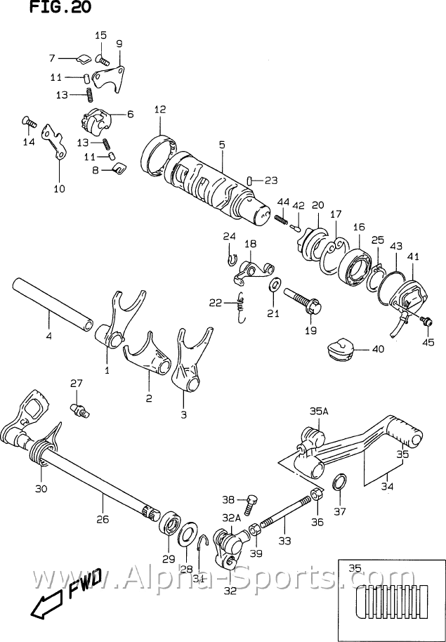

https://alpha-sports.com/spst/1999%20GSF600S/31.gif
where the pedal (34) pivots on the footrest and where shaft (26) comes through the sprocket cover.
You'll need to remove bolt 38 and pull the knuckle off the splines, then take the sprocket cover off and make sure the hole is clean (fine round file) and use fine emery to get any corrosion/muck off the shaft itself.
