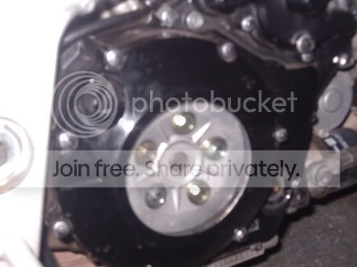

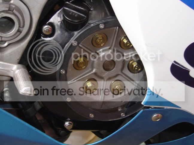

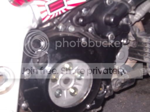

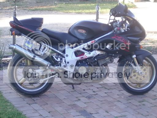

what you want is lexen here is mine tls been done now for close to 15000klm and still as clear as the day it was done
https://i37.photobucket.com/albums/e75/davetls/IMGP1100.jpg

mate i dont sorry but it was milled down to fit but also had a lip of about 20mm that was still inside for the glue for memery it was
8mm thick lexen but the clutch cover was only 4mm thick so it was milled down to fit flush with the face of the cover and was over hanging on the inside good luck with it you now you can allways cut the face out of your cover and leave a 10mm ring of the face there and fix the lexen to the face the billet ones they make for tls/tlr are made like this
