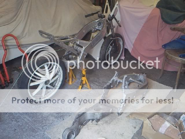

Whilst in the middle of one of my other projects (honda vfr400, see sig).
I decided to pull out an old frame that was given to me a long time ago.
The only RGV parts i have are the vj21 chassis and the bottom yoke.
Not needing the VFR front end i had just pulled off i was surprised to see that the VFR forks fitted the RGV bottom yoke.
And so starts 'Project HONDZUKI'.

Parts I have for the project;
RGV vj21 chassis
RGV vj21 bottom yoke
Honda FMX650 engine and loom
Honda VFR400 complete front end
Honda VFR400 rear wheel
Honda VFR400 grp race seat unit
Honda VFR400 swingarm and hub etc
Parts i need;
RGV vj21 top yoke
RGV vj21 fuel tank
Honda VFR400 grp race fairing
This is a project built from all the parts I already have and with the intention of building a budget race bike. All parts donations accepted Wink

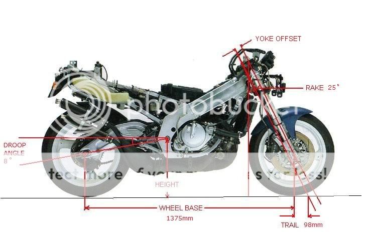

Because I am changing all the rear shock mounts for VFR linkages I want to be careful to keep the nimble RGV geometry. These are the dimensions I will be using.
https://i475.photobucket.com/albums/rr119/Timon1983/RGV%20Hondzuki/untitled-2.jpg
Does anyone have the swingarm pivot height so i can jig the bike up?
The RGV vj21 also uses an 18 inch rear wheel, this means I can keep the 8 degrees swingarm droop angle (although i might raise it to 9 degrees to get jack the rear of the bike up slightly)
Last night i also found out the VFR swingarm spindle diameter is perfect for the RGV frame, machined the frame out slightly and the swinarm is in with gaps either side so i can centre it later on with spacers.
Also trail fitted the seat unit. Will get some pics up soon.

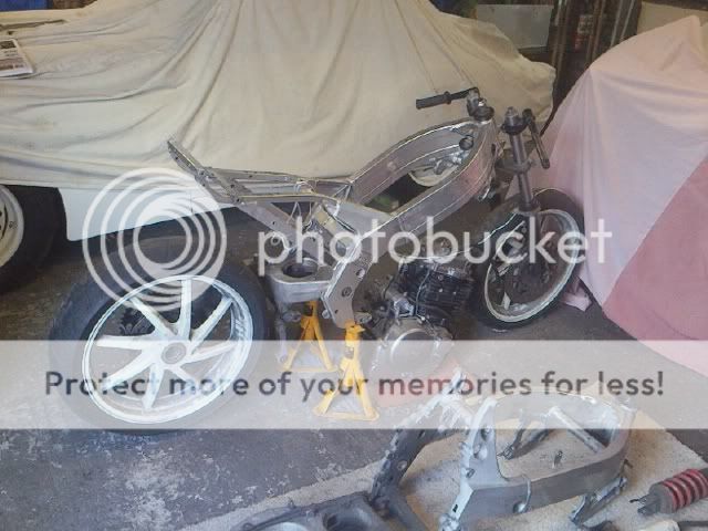

Swingarm is in and aligned, measured the whole bike to get a good centre line. Then 'stringed' it (gotta love the old school) just to check. Just need to get the spacers made up and that will be the swingarm done.
https://i475.photobucket.com/albums/rr119/Timon1983/RGV%20Hondzuki/Photo002.jpg
The shock and linkages, however, is a whole other saga to be tackled.
Also pulled the motor out to offer it up, its going to be quite a squeeze to say the least.

How will you over come chain alignment issues?
Tim..

The chain runs past the frame fine, there is quite a nice gap.
As for the engine, i'm not 100% on the positon (weight distribution calcs etc) yet but the general idea is far back as I can get it. May have to raise or tilt the engine slightly to get the chain alignment right.

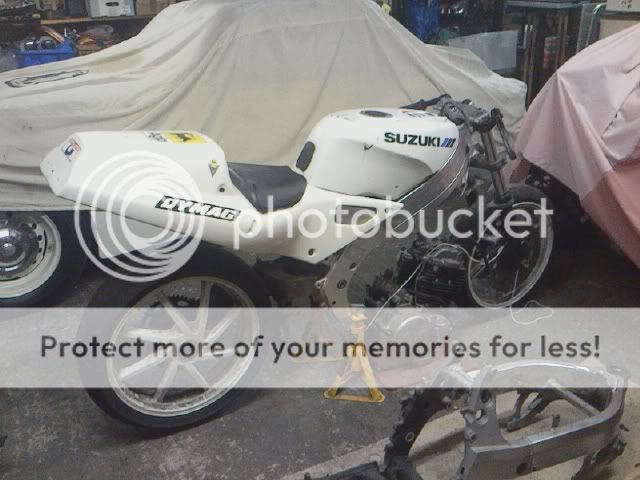

Swapped some of my other parts just hanging around for a RGV tank (with only one small dint that easily filled) and a RGV top yoke.
https://i475.photobucket.com/albums/rr119/Timon1983/RGV%20Hondzuki/Photo0024.jpg
Trail fitted the seat unit, i think it works well.
As for the name its going to be 'Hondzuki RFX650R' (Rgv + vFr + fmX + 650cc + Racing)
