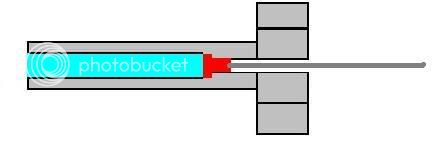

Doesn't have to be rod activated, you could use a cable with a bit of threaded bar soldered on the end. In fact, I did a picture showing how it could be attached using a drilled bolt. Nipple is red, solder is blue.
https://i48.photobucket.com/albums/f216/stinkwheel/brakethread2.jpg
EDIT: It's only on the "wrong" side until you need to fit the brake for a right hand sidecar by the way. That's historically why Jap and Brit bikes have it on the left and European bikes have it on the right.
