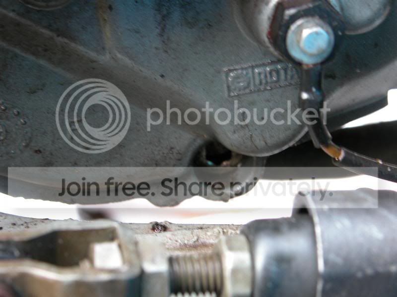

Got the Mikata Kit through post today and the company who sent were really helpfull too, ill dig there name out.
Anyways, just preping the engine at the moment, scrapped off all the old gasket and about to fit the new set, but just want to flush it out first ...
I have these two options that are the screw to be able to flush ... I also want to flush out the gear box, so i rekon each one is on of those options, but just need hep as to which does what Very Happy ...
Here they are:
https://i14.photobucket.com/albums/a317/taazzukcb/Pegaso%20Barrel/LeftSide.jpg
https://i14.photobucket.com/albums/a317/taazzukcb/Pegaso%20Barrel/RightSide.jpg
I think after the flush im just going to build it as i think thats all i need to do to prep it.

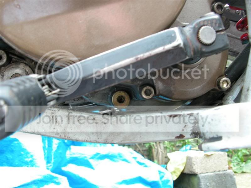

Also can i just clarify that this is DEFFINATLY the gearbox filler cap ...
https://marci.over-clock.com/DSCN0002Small.jpg
Thanks alot, sorry for the questions yet again, but im getting twitchy as im actually doing this, but enjoying every minute Razz ...

I have absolutely no idea what you are asking about for the 1st 2 pictures? They just look like the bolts / studs that secure the covers to the engine? A gasket should fit flush and when the covers are secured the gasket will take up the shape between them and form a tight seal as long as the surfaces are clean and smooth.
The 3rd picture does nt look like the filler cap to me, more like an electrical connection for the neutral light or something along those lines.

Noo ... i just want to flush any deposites of piston ring that might still be sitting at the bottom waiting to mess things up again ... I want to flush some light engine oil through it to get them out, but i dont know which of the 2-screws above let it out ...
Then i also want to flush the gearbox and re-fill that, so thats all good ...
Also that is not the neutral thingy as you can open it up and see engine inside and that tube just doesnt go to anything ... Something can go in ther,e but just want to check that its for the gearbox oil ...

The picture you say is the filler has the breather on it so you could put the
oil in there no problem,you just need to know how much.

Splitting the cases is a pig on the Rotax engines. You will need pullers to reassemble the engine (unless you want to be rebuilding it with new main bearings within 1000 miles).
Neither of those 2 bolts are the one you want. The bolt to drain the crankcase goes in almost vertically, and is just in front of the starter motor.

Paddyblake: Im not confident enough to take the whole engine out, so i cant use your method.
Okay, i tihnk i know which bolt you mean then ... It's about 225 [Degrees] from 12 o'clock if you get me from the left hand side ... Right up front ...

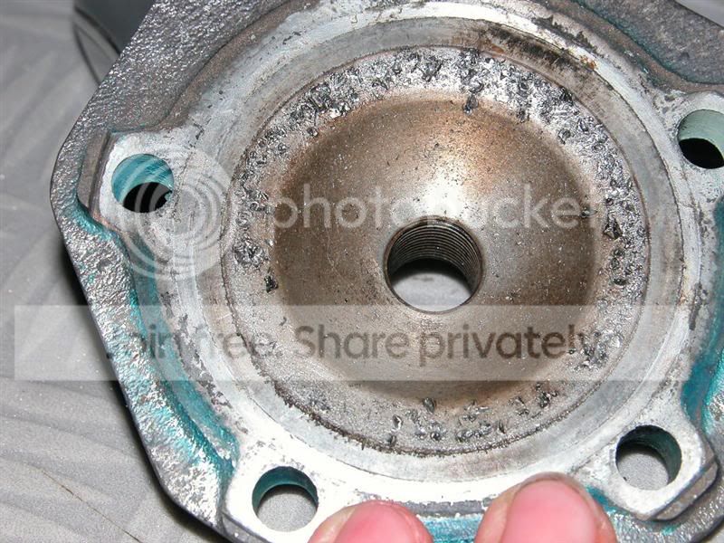

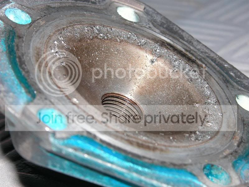

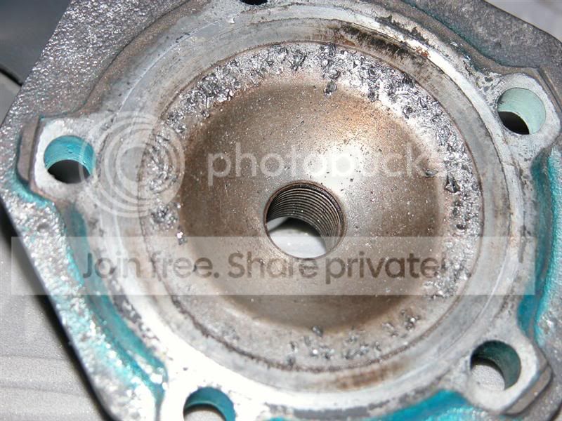

Right, piston head, perhaps i mean the cyclinder head? Not too sure Razz ...
But anywho, is this in anyway re-useable for saveable? Can the lumps be filed down or sanded down?
It's just a new one is out of my price range of £0!

PostPosted: 22:04 - 01 Oct 2006    Post subject: Reply with quote
it is salvagable, but it will cost, you cant just sand it down. it needs machining on a lathe to get the pits out and keep the correct squish profile. the gasket face will also need machining down to compensate, and you may need plain nuts (or extra washers) if the bike has dome nuts, as they wont do up fully after its been machined.
if your mitaka barrell is a big bore, you will need it reprofiling anyway.
alien.46.uk
Joined: 24 May 2006
PostPosted: 22:15 - 01 Oct 2006    Post subject: Reply with quote
No, i havent gone for a big bore kit, it's the normal 125cc ...
Im guessing this will end up costing more then a second hand head?
& then ya have the chance of the piston closing the plug gap... Wink
