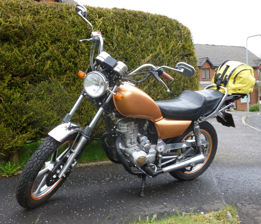

£550 Chinese bike-in-a-box + liberal application of ACF-50 out of the crate and each Winter + 3 years of all weather use with the occasional bucket of water thrown over it =
https://3.bp.blogspot.com/-kuy3l8b8Lo8/T4BgMxdZlPI/AAAAAAAAAMo/qattQ4l9sFU/s1600/1.jpeg
I'm a believer. In fact, I've bought a litre bottle of the stuff. It's expensive, but far better value for money than the spray cans, and will last multiple bikes for years.
