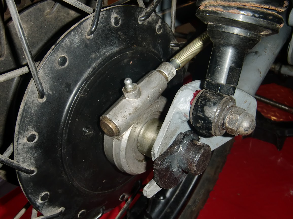

Took the back wheel out again so I could fit the speedo drive. This is how they did it in the 60's. Just needed notches cutting in the end of the hub and the wheel spacer filing down 6mm so it slots into the fork-end of the swingarm to allow for the extra width the drive adds.
https://lh3.googleusercontent.com/phdu8aOX0ePL4zUhsYX88vNbSzr0ZQ3Y2-GF0Lra3I_AtZ6qkrFBn0nGy9LycL48HjCRiShulGgeWHSRrPtdS2oMrK258V9qms4uBf73Z7-J072cLTh-hEWaBiWRDb4PjCT69-6ciw=w1155-h866-no
https://lh3.googleusercontent.com/chpZ6qMcee0N3zI4N2Oc1pRIiQbFCbifHhIrf9Uos1YlaFqjcv3S6rvNYDnaPyHheu4RTBOBkCtBCW7m1q3CMC0WRBjVtO0bCGoXkpizHICOq3ebqajZYTreZlm5t1SD_oyhLhMZZQ=w1155-h866-no
It's as well I did because the wheel bearing fell out. Looks like it's spun-up in the hub.

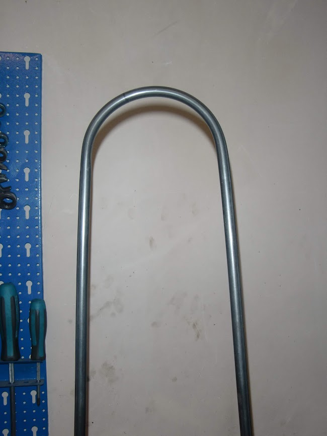

Steel for the mudguard stays arrived today. I've never bent steel tube before and this went amazingly well.
Got some 10mm diameter by 1mm wall mild steel tube. I filled it with silver sand and packed it well down with a bit of round bar and a hammer. Just used duct tape on the ends.
https://lh3.googleusercontent.com/mss-0syJX02CW_6Xe2jvbcauD64_RNNde8ao0cQ3Sj_L-jrH9eEAd1SFxFUfBCtZKpA8-PqEzGDtFb6jz8Rpsm-k1wYA_-_Seme8CyJRwtxRfOlZw38Efbgf1q6586ibhuR4rZz7VQ=w1155-h866-no
Clamped a bit of scrap alloy tube of roughly the diameter I want the bend in the vice as a form (badly clamped) then clamped the tube to the outside of the form with a mole grip. Then I just bent it.
https://lh3.googleusercontent.com/3N3XNL2tC1vSgSfBsQt1anQ5np8lqI82xty6BVM5hSSwHVQZlHTTw8_nUZ7LWk40q_nODzgPq672ZCK0aEAQ0StRvxsGYNLrn6F6ceqBwX8J25YzOoG-RpdMmtj-1WyM6nxXODUJ8Q=w1155-h866-no
I'm impressed with how well and easily this went.
https://lh3.googleusercontent.com/mUaOZCCvO_0hoaDtPqq6ohp2mBFKdpuWOd__ZXiG-7LkJ1OMb98EEleBca4GqrVb4F3PD3ZtngaxhIYkiuWHSsadEaWcDn5zjEx2xuwNriZ_eQ6xC_o62p61jT-Wj1daF1O1YWtwdg=w650-h866-no
I didn't use a mole grip on the first attempt and that was a mistake because it tries to bend elsewhere at a single point but I was able to straighten it and have another go. Not quite as neat a bend but passable so I'll make that the back one.

Welding? Don't breathe ANY fumes regardless of plating. Yes Zinc is nasty but metals often have coatings from storage after the mill/factory and it's not nice stuff. It's usually the waste oil and grease and if China is giving it away with products then it'll contain things even they deem as nasty..
Well done with the bends - Delboy fails miserably with basic metal forming on everything he does but you nailed it with this.
One thing though (with tube and all other profiles of stock) is to use a form of a slightly smaller size to bend around. The reason being that bit of spring back making the bent metal a bit bigger than the form. Smaller forms take you to where you want to be.
Either way that's a great lesson for people - you don't need pipe benders all of the time. If you go down the rarely used tools route you'll waste so much money. Keep things simple.
