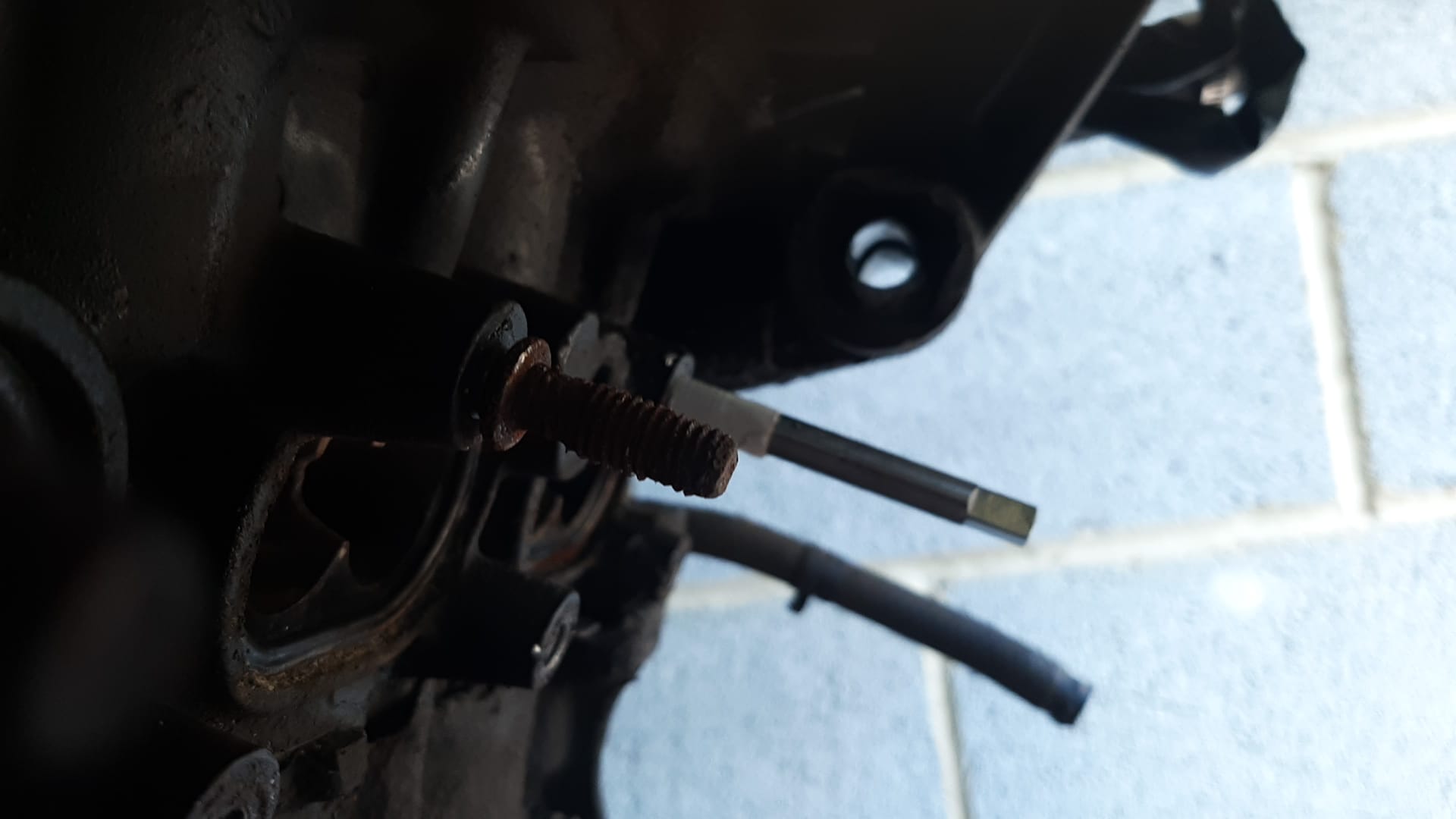

Tap and drill marked with suitable depth markings
https://www.bikechatforums.com/files/2_210.jpeg
I found that at slow speed the drill kept snagging/biting even with copious oil so wound it up full in the end.
Plenty of oil added to the tap when it seemed to get slightly tighter (it was relatively effortless and I had to consciously use the back/forth rotation approach because it seemed so easy.)

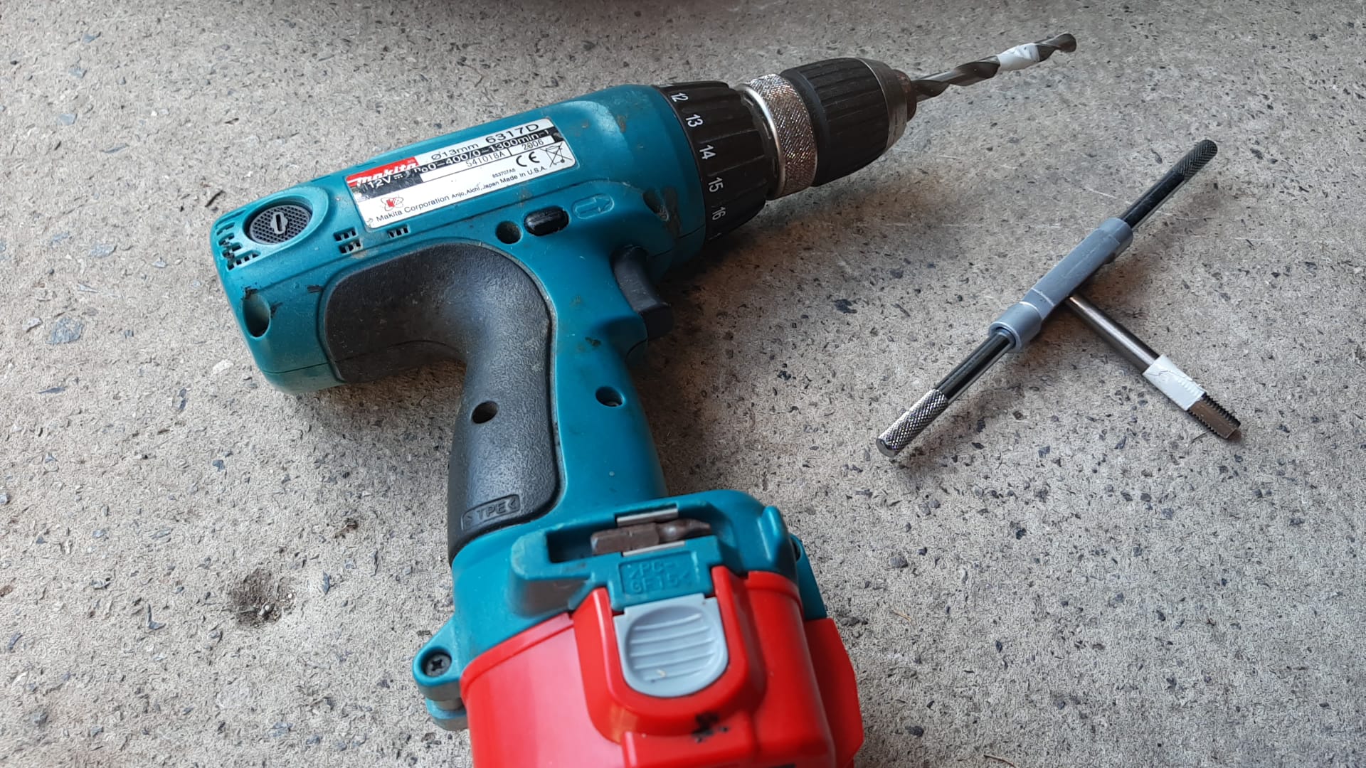

https://www.bikechatforums.com/files/whatsapp_image_2024-09-16_at_4.16.29_pm.jpeg
Thread insertion tool with thread. It literally just screwed it with the depth limiter adjusted for the insert so that it was flush or as near as damnit.

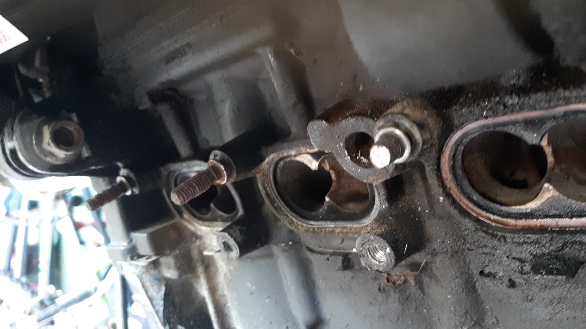

https://www.bikechatforums.com/files/3_159.jpeg
Thread inserted, with tang still in place.

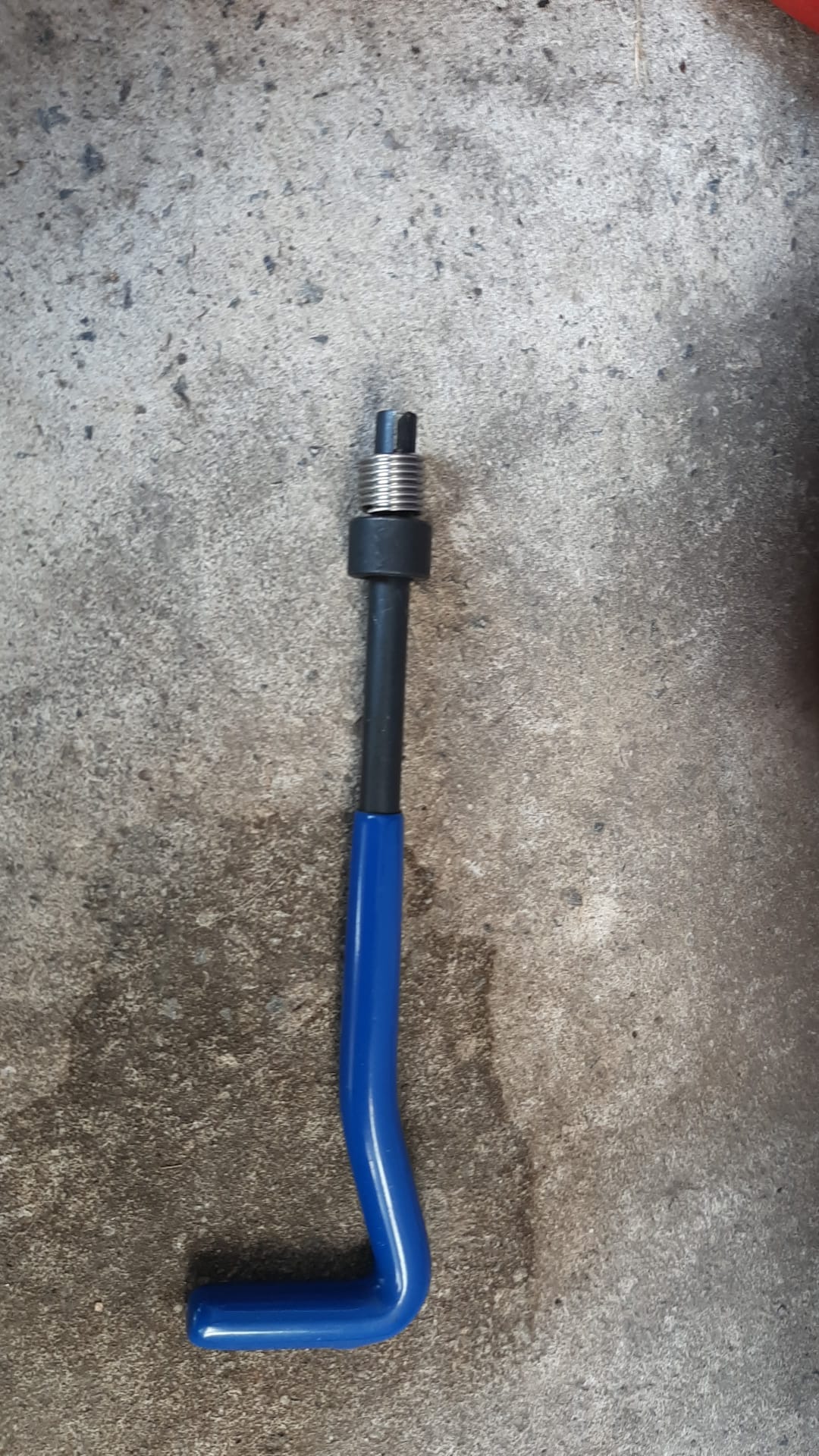

https://www.bikechatforums.com/files/4.jpeg
Which was dealt with by these.

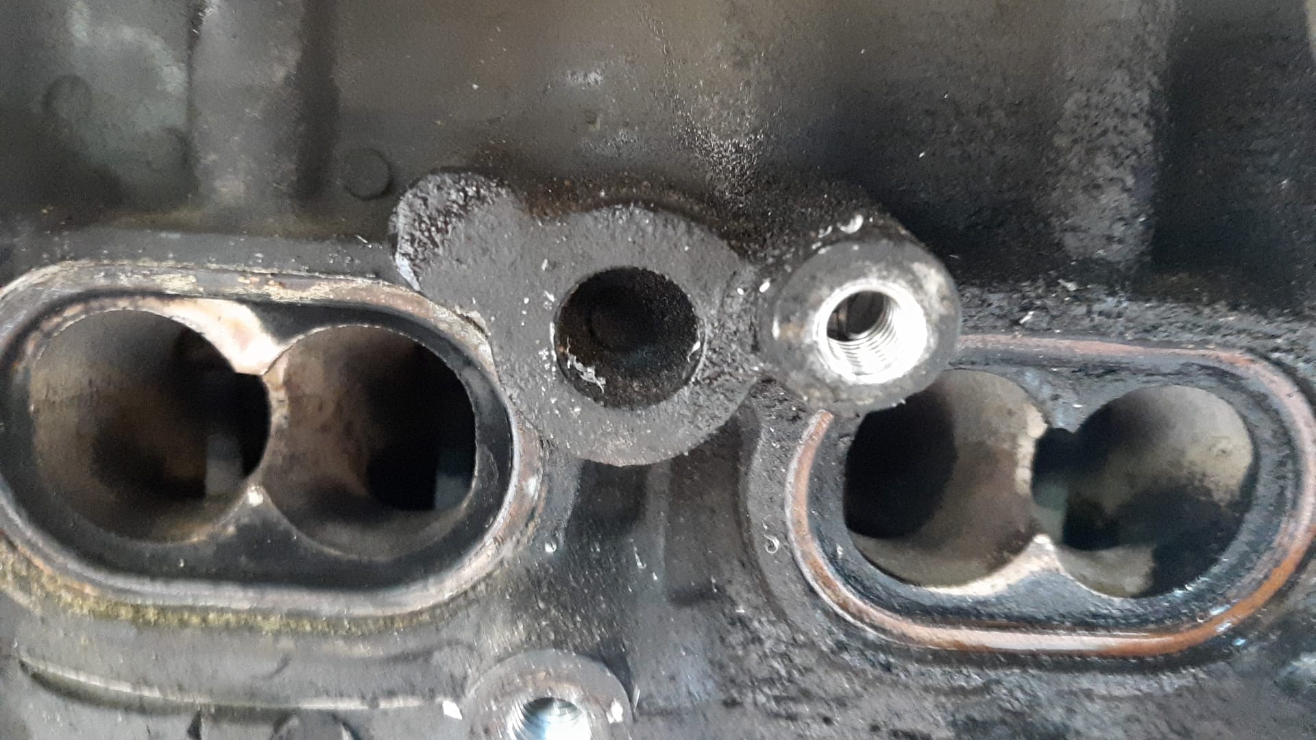

https://www.bikechatforums.com/files/5_213.jpeg
Finally checked my work by inserting one of the snapped studs.
https://www.bikechatforums.com/files/6.jpeg
