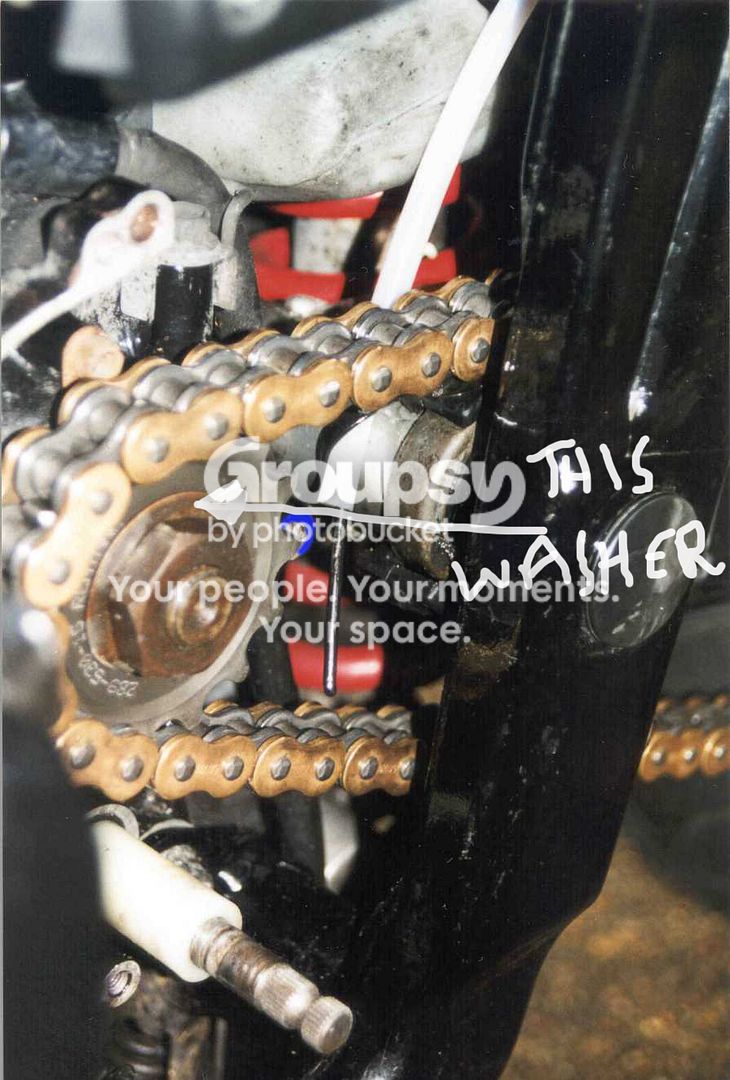

Yesterday I managed to snap the chain on my XJ600 (*slaps self*) and the chain seems to have taken the washer thing that goes on between the nut and front sporcket to stop the sprocket from coming loose with it.
Is it super mega dangerous to ride the bike without this washer in place or will I be ok? Is it possible to make one out of an old washer and bend it over the nut?
I'm off to the bike shop to get a new chain in 5 mins so I'll ask if they have a washer while I'm there but if not I feel I may hve to be a bit creative as I need my bike almost everyday for work but luckily I have a day off today.
(this is the washer I'm talking about (this is not my bike, just a random image from the net), you have to fold it over the nut that holds the sprocket in place)

The sprocket retaining nut is more likely to come off if you do without creating another problem if it comes off.

Right, so don't ride it without one? Will I be ok to make one from an old washer if the bike shop doesn't have one? (I somehow doubt it's the kind of thing people usually stock)

Check the sprocket and see if the washer is stuck to it.
I cant see how the chain could remove the washer.
Paddy.
PostPosted: 16:36 - 28 Nov 2007    Post subject: Reply with quote
As above. Likely the centre of the washer is splined to match the splines on the output shaft of the gearbox. So the washer is locked in place to the shaft and then the edge bent over to lock the nut to the washer.

The bike shop (Woods in Abergele) had one of the washers in stock and it cost me £1.38!
But upon returning home to fit my new chain and washer I noticed a tooth missing from the front sprocket so I'm going to have to go back there tomorrow for some sprockets now Evil or Very Mad Christ knows where the money is going to come from!

Most likely reason is that the last person didn't realise it was a lock washer and didn't replace it.

Agreed - to me it seems impossible for the chain to have removed it.
