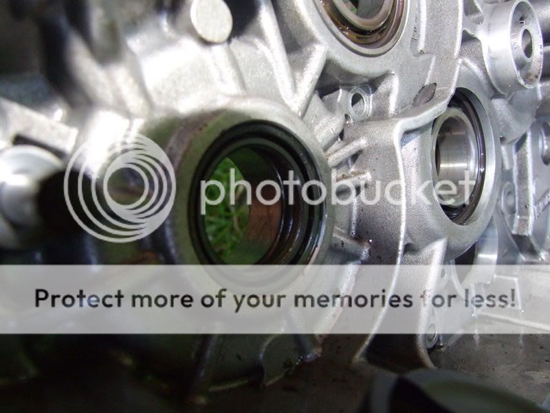

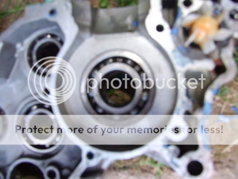

This is it.... i cant get in behind the bearing to give it some welly. I heated the case and the bearing.

No reason why it shouldn't come out. I would make a stepped drift to press it out from outside. If you have a socket that will fit through the hole in the casing and catch on the inner race, you might be able to use that as a drive. Probably will have to sacrifice the seal, better yet remove it first if possible.

The inner race is like inline with the case so i doubt a socket will get on it. I dont mind about the seal really i will take it out tomorrow and see how it goes.

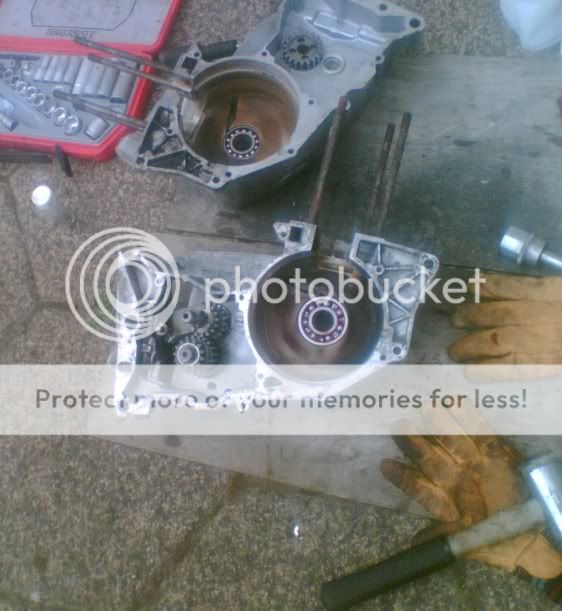

I was doing the reverse of that job this weekend. Cases in the oven, bearings in the freezer. Didn't even need my hammer, they dropped right into place. Note leather gloves, hammer and socket and extension bar "drift" on standby.
https://i48.photobucket.com/albums/f216/stinkwheel/engine3.jpg
EDIT: Remember to remove any circlips. Wink

Incidentally, I can even see from your photo that if you remove the seal, you'll be able to see both the inner race and the balls. Plenty of room to get a drift on there, as said, a big 1/2" drive socket is usually ideal. And plenty of heat.
