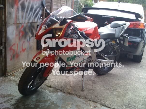

My bike, it's the same as a Derbi GPR125R:
https://i176.photobucket.com/albums/w182/OllieePaul/GileraSC125.jpg
As much as I love the bike, as flickable and fun as it is I just find it lacks power. I enjoy being able to turn my right wrist and something to happen, whereas if you're in 2nd gear or above on the 125 you just don't get that.

And lastly - anyone care to post some pictures of their own models, and your thoughts/stories of such little beasties?
Photo..
https://i244.photobucket.com/albums/gg19/Mordoklej/RS125_640V1.jpg
