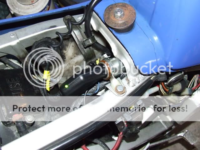

Fitted and working.

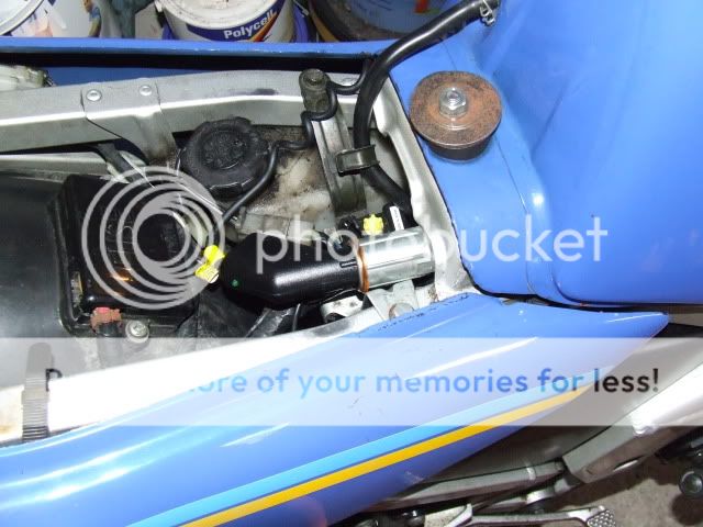

Mocked it up and checked I could still close my seat:
https://i15.photobucket.com/albums/a376/ms51ves3/DSCF1791.jpg

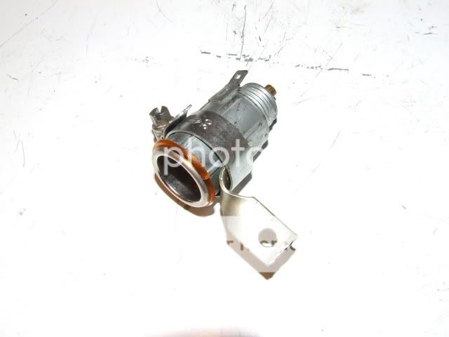

Then found a bracket which I cut, twisted, bent and attached to the socket using a jubilee clip:
https://i15.photobucket.com/albums/a376/ms51ves3/DSCF1793.jpg
That doubled up as the earth.
Found a ring terminal in my toolbox and crimped that on to the wire and attached it to the battery with the 5amp fuse in-line.
My PDA on charge:
https://i15.photobucket.com/albums/a376/ms51ves3/DSCF1796.jpg
https://i15.photobucket.com/albums/a376/ms51ves3/DSCF1801.jpg
Even with the PDA on charge the PV still cycles when the ignition is turned on Thumbs Up
