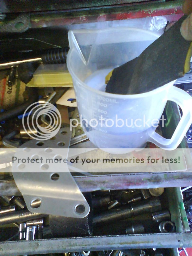

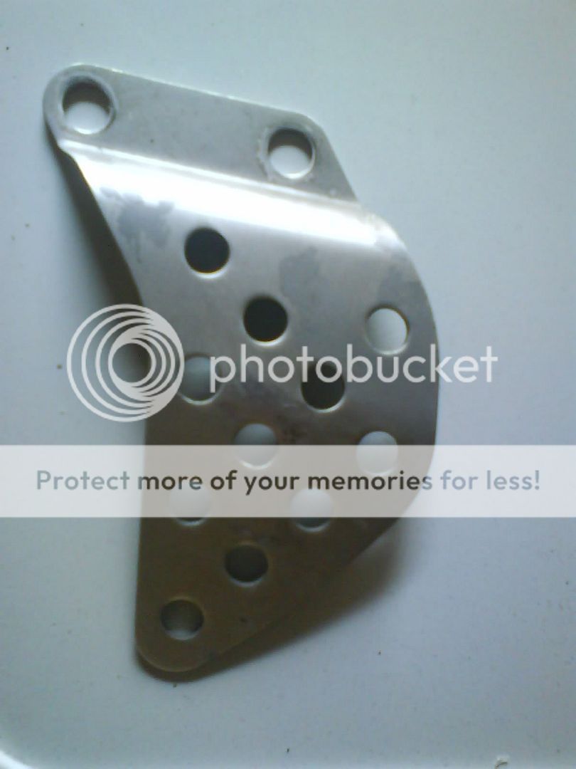

First hanger part stripped off
https://i123.photobucket.com/albums/o297/Gfxs/DSC00059.jpg
Wet sanded with 120 grit to smooth and remove dirt
https://i123.photobucket.com/albums/o297/Gfxs/DSC00060.jpg
Washed and degreased with white spirit and tissue
https://i123.photobucket.com/albums/o297/Gfxs/DSC00061.jpg

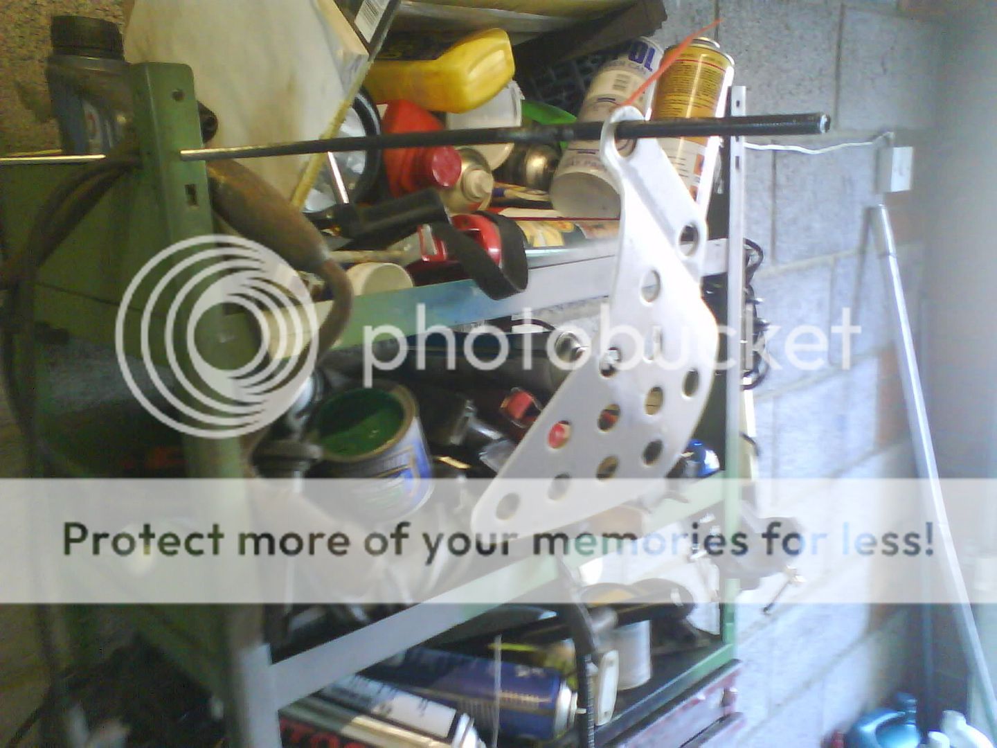

Hung on some threaded bar and preheated with heatgun
https://i123.photobucket.com/albums/o297/Gfxs/DSC00062.jpg

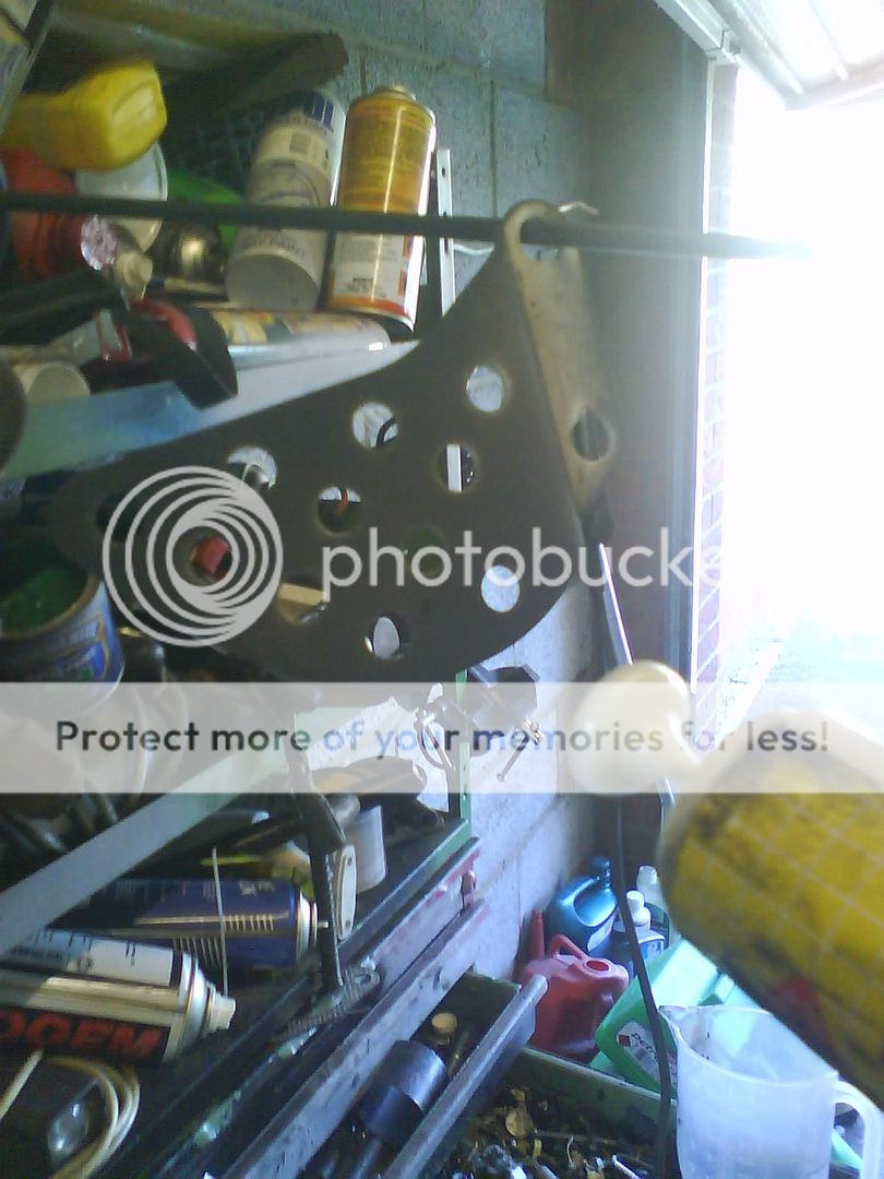

Then shot the colour on, unlike paint once youve got enough power coating on it won't carry on sticking it will just fall off.
https://i123.photobucket.com/albums/o297/Gfxs/DSC00063.jpg

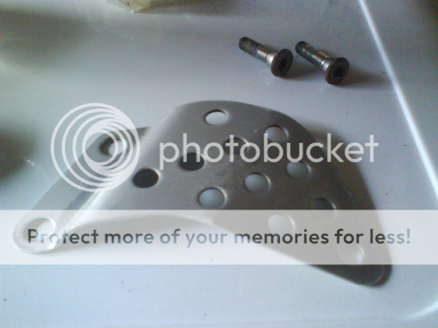

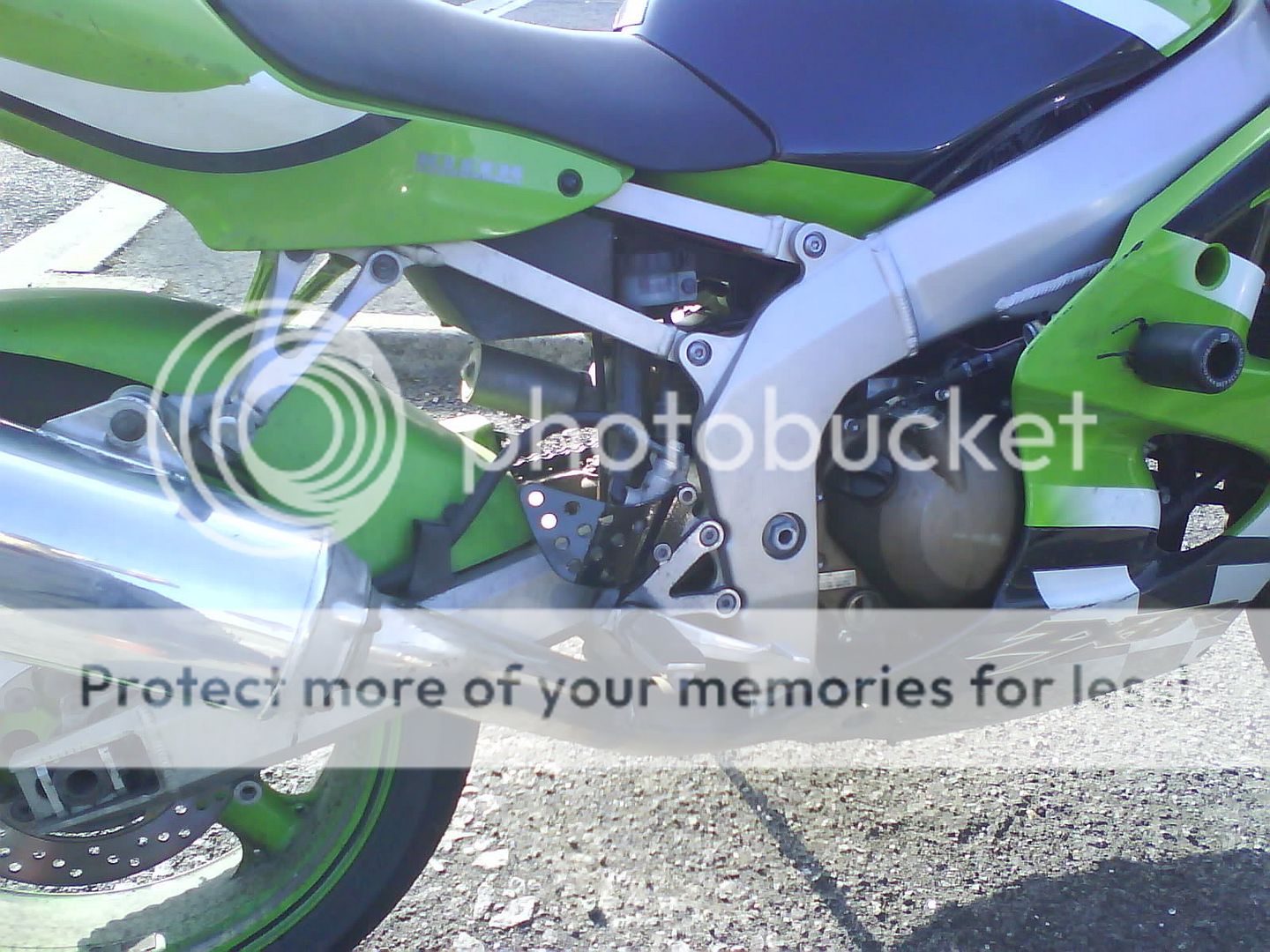

Finished result
https://i123.photobucket.com/albums/o297/Gfxs/DSC00068.jpg
https://i123.photobucket.com/albums/o297/Gfxs/DSC00070.jpg
Would of got a better finish on them, if i had baked them in a suitable sized box and not used a heatgun for the heat source (suggestions on what to use as a box welcome) and also if i had not spilt most of the power on the floor then scooped it back up!

heal plates look good have you tryed hot soapy water on the rest of the bike? i guess not...lol

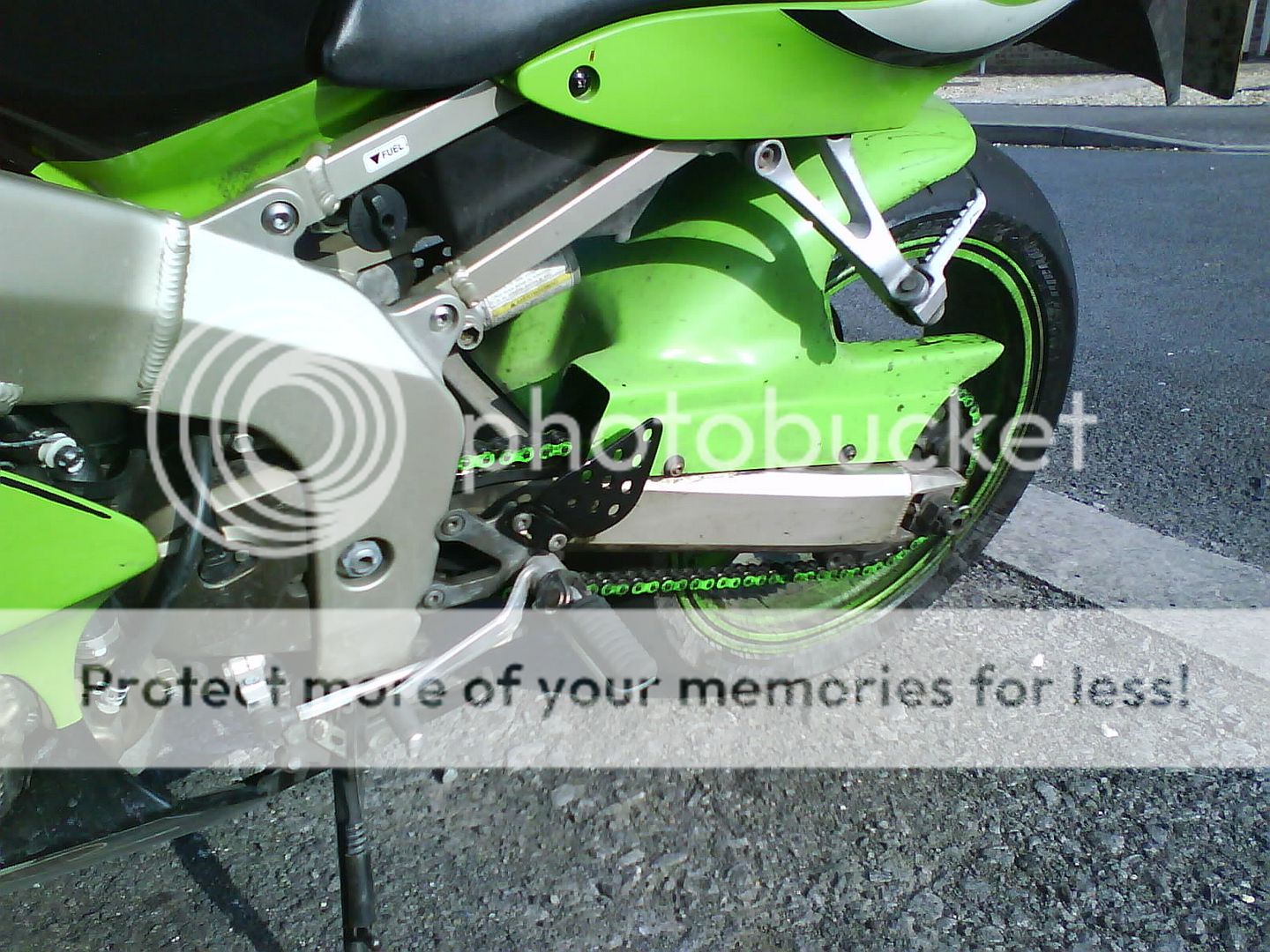

and madforit, im a believer of seasonal cleaning, and it only looks that horrific at the back as id oiled my chain with some valvoline wet lube and its sprayed it all over the rear, will clean her up tommorow maybe....
