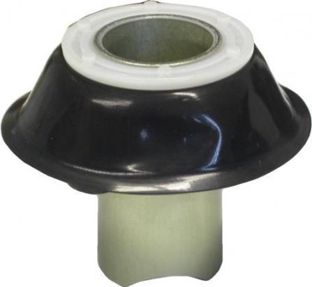

Bandits dont have a fuel pump, it's a gravity fed fuel line jobby.
Anyway now youve posted this across a variety of forums I dont know where to reply to Thinking lol
But you say you looked for restrictors. They would be on the other side of the carb going into the engine. And would not necessarily be discs. Mine uses diaphragms as restrictors which look like this and go into the top of the carbs:
https://images.wemoto.com/full/CARBURETTOR_DIAPHRAGM/10008505.jpg
But if you say its pulling well then it probably isnt restricted.
And these 3:
check for crap in the float bowl,
check for crap in the jets and air ways (blow through with compressed air,
after all this check the float valve is clear and the float height is correct.
Require stripping down the carbs. And I believe youve checked everything else. Tis a strange one!

Well basically, in this pic you put up:
https://img155.imageshack.us/img155/6241/dsc00243w.jpg
Underneath those black caps with the 4 screws is one of those diaphragms. The standard one just had 2 small holes in the bottom for the needle, but the restricted one has 4 more at the top near the rubber bit to allow more airflow, hence restricting the power.
When restricting this way you replace those diaphragms with the restricted ones.
Although saying that I would have thought they would all be standard, as its a bit cheap to sell you a bike with the restricted diaphragms and not the standard ones!

Youd have to lift it out, being careful not to damage the rubber and look at the metal stalk to it.
Restricted ones have 4 holes near the top by the rubber aswell as the 2 ones at the bottom. So 6 in total compared to 2 for the standard ones.

https://img231.imageshack.us/img231/1637/dsc00269d.jpg
Ditto
Joined: 26 Sep 2009
PostPosted: 16:08 - 29 May 2010    Post subject: Reply with quote
That looks fine.
Yeh well its an easier job if your doing a carb removal. It could be the case that grit has gotten into the carbs which would block the jets or flood the foat bowls.
If youve already removed the carbs before its not a difficult job to strip them. Just have that workshop manual to hand.
This way you could check the jets, and the fuel pipe and should be able to discover the problem, as all the pipes are on ok by the looks of it.
CG 125 > Bandit 600 > CBR 600 FY > Street Triple R
Misc
Joined: 15 Aug 2005
PostPosted: 16:11 - 29 May 2010    Post subject: Reply with quote
Ditto wrote:
That looks fine.
So if i've already detached the clamps on both sides of the carbs, is it just a case of unbolting them from the frame? Do i need to block the leftover holes in the engine when they're out? Always see people covering them up.
I've got some carb cleaner too. Thumbs Up
