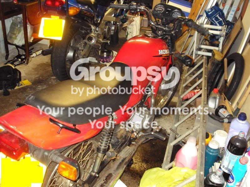

Hi.
I have a '99 CG125 with a siezed engine. It's solid.
https://i14.photobucket.com/albums/a324/david_m213/DSC00051-1.jpg
I like CGs and as this is my first bike, it has sentimental value. I suppose it could be sold as parts, but I'd like to get it on the road. It is taxed but doesn't have an MOT.
It needs new forks, stripping and bits of the frame painted etc. I wouldn't get it done professionally. I'd hammerite the bits that need done after cleaning the rust off etc.
It'll need a new engine.
I'd be wanting to spend no more than £200 getting it back on the road.
Do you think I should bother or should I just get rid of it?

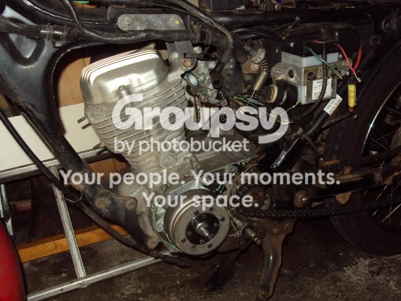

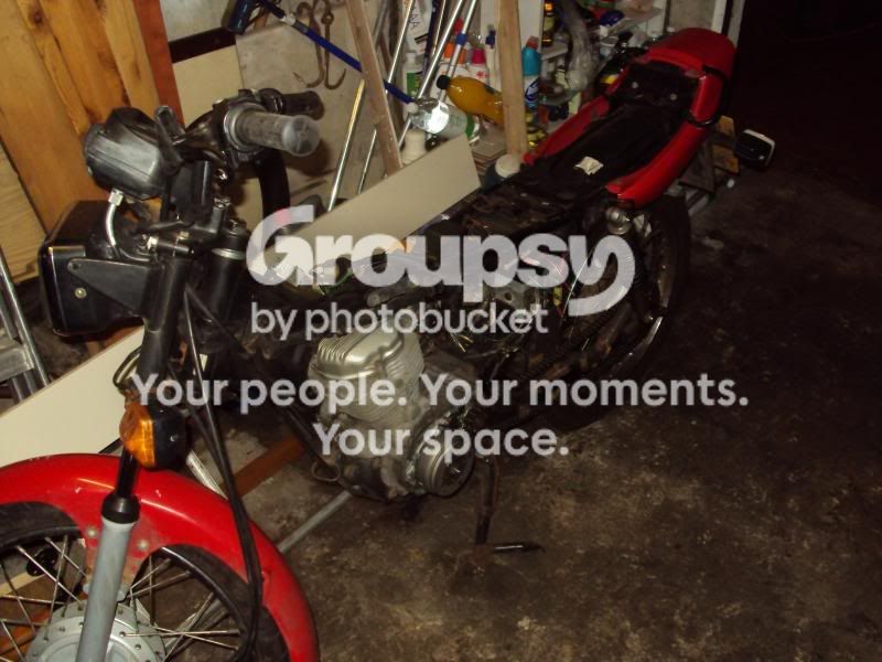

johnsmith222
Joined: 26 Dec 2008
PostPosted: 18:19 - 25 Nov 2009    Post subject: Reply with quote
and it begins...
https://i14.photobucket.com/albums/a324/david_m213/DSC00194.jpg
https://i14.photobucket.com/albums/a324/david_m213/DSC00195.jpg
TUG
Joined: 12 May 2007
PostPosted: 21:21 - 25 Nov 2009    Post subject: Reply with quote
Glad your stripping it, you'll need to fix that stand it looks too far forward, normally one of the legs snaps it's weld.

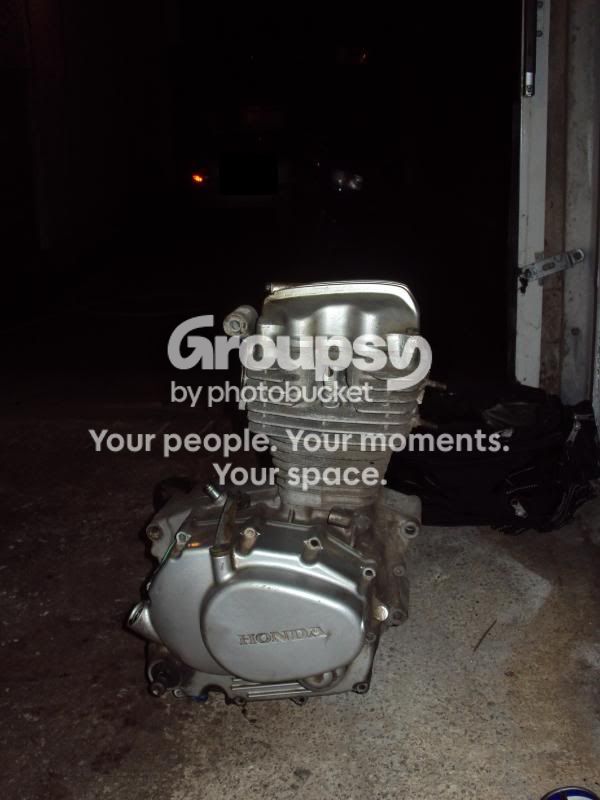

johnsmith222
Joined: 26 Dec 2008
PostPosted: 23:23 - 25 Nov 2009    Post subject: Reply with quote
Everything went smoothly, until I got to the last engine bolt!
I could've done everything I did before in the time it took me to remove the last bolt.
Here it is:
https://i14.photobucket.com/albums/a324/david_m213/DSC00198-2.jpg
The next step will be to strip the engine and see what's up. I don't know if I'll be taking photos though, my bet is the damage will be quite embarassing. Embarassed

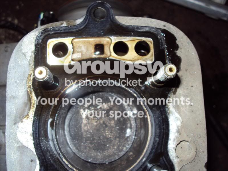

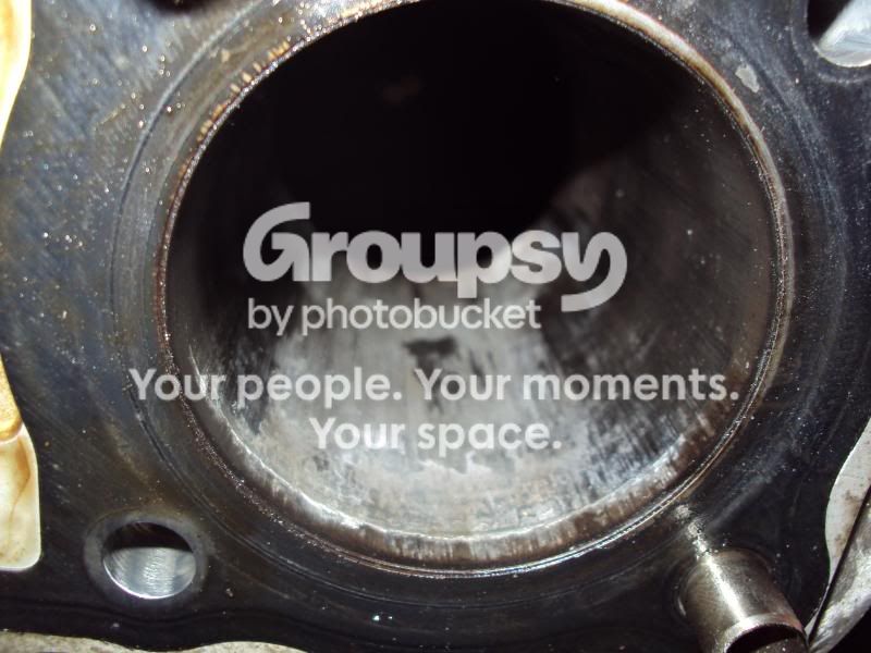

PostPosted: 17:22 - 27 Nov 2009    Post subject: Reply with quote
Cylinder head seems ok:
https://i14.photobucket.com/albums/a324/david_m213/DSC00199.jpg?t=1259342011
https://i14.photobucket.com/albums/a324/david_m213/DSC00205.jpg?t=1259342301
https://s14.photobucket.com/albums/a324/david_m213/?action=view¤t=DSC00207.jpg
https://i14.photobucket.com/albums/a324/david_m213/DSC00212.jpg
https://i14.photobucket.com/albums/a324/david_m213/DSC00215.jpg
https://i14.photobucket.com/albums/a324/david_m213/DSC00217.jpg?t=1259342484
The barell isn#t as bad as I was expecting, but it's still scored. Sad
I think I will need a replacement engine.
dextersaurus
Joined: 26 Mar 2009
PostPosted: 17:34 - 27 Nov 2009    Post subject: Reply with quote
Rebore and new piston will work out cheaper mate.

PostPosted: 17:42 - 27 Nov 2009    Post subject: Reply with quote
If it has done that through lack of oil then check the crank carefully. Would expect the crank to die before the piston siezed.
PostPosted: 17:45 - 27 Nov 2009    Post subject: Reply with quote
Looks like it has been running a bit lean.
TUG
Joined: 12 May 2007
PostPosted: 21:15 - 27 Nov 2009    Post subject: Reply with quote
As chives said i expect the same, soo its been getting extremely hot, well if you ride them like me anyway, Do the overbore like i did it will work out miles miles cheaper than you think, use your initive mate, your a biker, not a car driver, so think outside the box.
