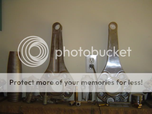

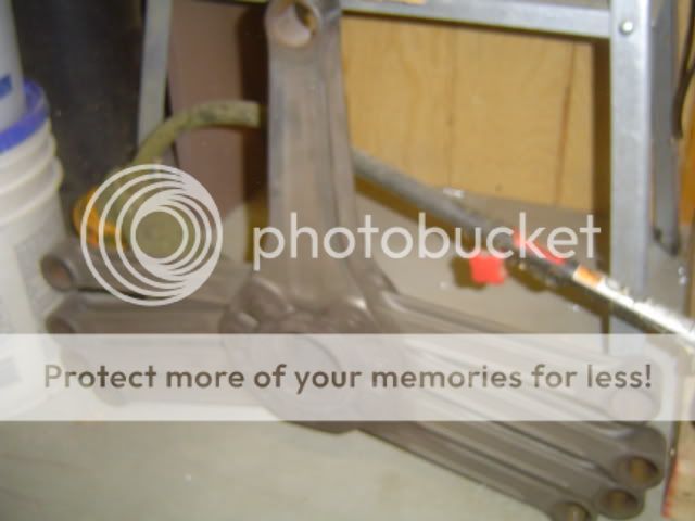

Teflon-Mike wrote:
The crank journals would have to be about a foot wide to fit thje big ends on.....
Of course they wouldn't....
but you need an odd number of cylinders, so either throw one away or find another one.. so assuming 9 the firing order would be 1,3,5,7,9,2,4,6,8 (or 1,3,5,7,2,4,6 for a 7 cylinder).
The tricky bit is the cam because radials use a ring cam that moves at 1/5 engine speed, not a shaft like inline engines...
So get yourself a master rod...or two...
https://img.photobucket.com/albums/v317/ZRX61/Warbirds/10-30-11001.jpg
It's only about 3 1/2in wide,... but almost 30in across...when it has the slave rods attached
https://img.photobucket.com/albums/v317/ZRX61/Warbirds/10-30-11002.jpg
