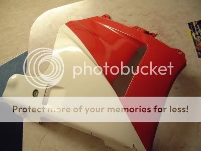

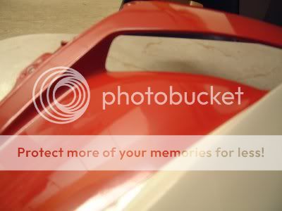

DaFrostyOne wrote:
Even then the finish is crap once laquerd, so i usually put on loads and loads of laquer (5+ coats) then once that's hardened for a week or more i flat it down with some polish. On one bike i used Autosol to get the laquer completely flat, it seriously looked like it had just come out of a showroom Laughing
It's all about the finishing off like you say, you can save even a bad job with some effort. While I didn't attempt to use autosol for fear of it removing the entire lot with one swipe I did use wet and dry and rubbing compound on the final coat of lacquer, I also used about 5 coats so there was plenty of depth preventing me going through it especially on corners.
These are about the best shots I have of a VFR panel I sprayed to match the original scheme about 6 or 7 years ago using Halfords paint, a much better finish can be achieved with a proper rattle can supplier, Halfords paint and nozzles are rubbish.
It's still not great to see but the gloss is there and the smooth finish, none of this textured stuff, it's not like glass but with the better spray cans you can almost achieve that, it's the priming and wet n dry stage that get's it completely flat. I should point out the white section is original paint so is as good as you'd get.
https://i238.photobucket.com/albums/ff264/kiowan/Misc/DSCF0069.jpg https://i238.photobucket.com/albums/ff264/kiowan/Misc/DSCF0071.jpg
