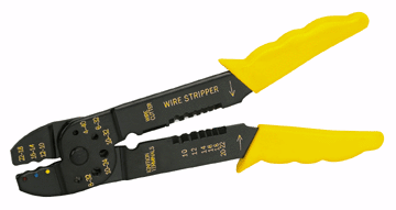

Go to a local hardware store and get yourself these:
https://i7.ebayimg.com/06/i/001/12/6a/0dd6_1.GIF?set_id=800005007
And some of these:
https://cdn.ecolightled.com/images/uploads/bullet_connectors_male_red_150.jpg
With those wire stripper things you can strip the insulation from the wire, then you slide the new bullet connector on and to secure it to the end of the wire you use the end of those pliers (it is colour coded so you know which bit to use) and squash the red bit flat.

If your going to do it, do it properly and get a proper tool for crimping them. Those cheap ones are total shit, not worth the £5. You'll just end up with dodgy connectors; The wires will pull out of the bullet connectors easier than the bullet connectors come apart.
Something like these;
https://i208.photobucket.com/albums/bb248/kojaycat/Rachet.jpg
(Found here https://www.kojaycat.com/crimping%20tools.htm)
If you don't want to spend that much, I'd suggest trying to borrow some, or getting a local garage that has the tools to do it. My friend has a pair, and they are infinitely better than the cheapo £5 tools.
PostPosted: 19:03 - 16 Jan 2011    Post subject: Reply with quote
Definately agree with the above. The ratchet crimping pliers are far more useful and not that expensive.

While I agree with the sentiment, personally I've never had any wires pull out of the connectors when using a pair of these. Having better crimps just makes it easier.
