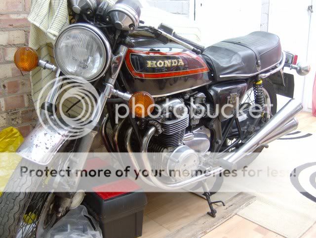

https://i156.photobucket.com/albums/t6/mike070868/side1.jpg
bike when i started
https://i156.photobucket.com/albums/t6/mike070868/side2.jpg

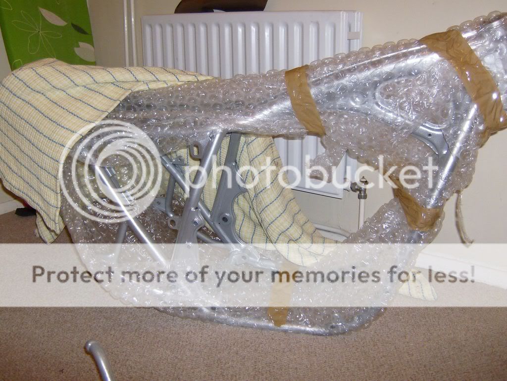

PostPosted: 00:50 - 14 May 2011    Post subject: Reply with quote

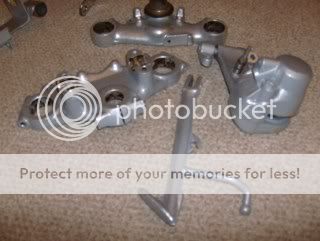

frame powdercoated in silver... not going to be original just a very nice version of it
https://i156.photobucket.com/albums/t6/mike070868/caseygoingtoparty030-1.jpg
yokes , caliper etc
https://i156.photobucket.com/albums/t6/mike070868/caseygoingtoparty028.jpg

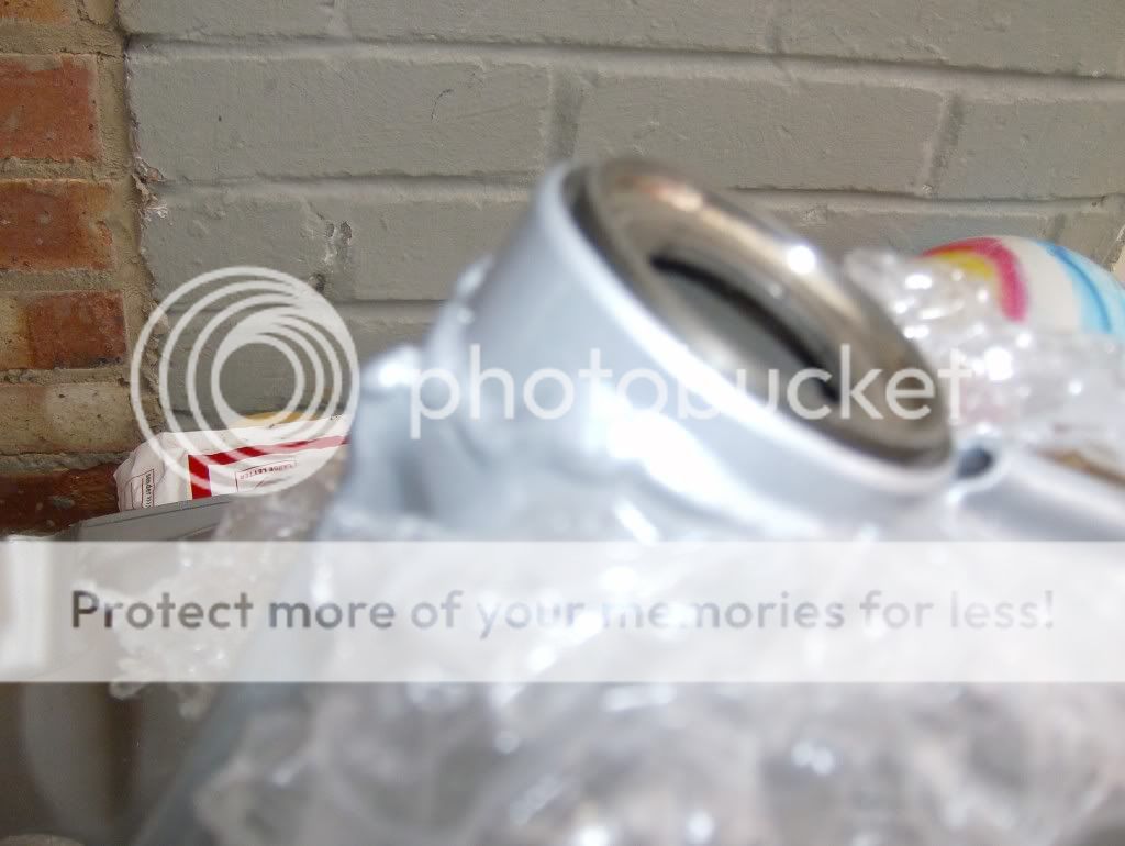

headset and bearings back in
https://i156.photobucket.com/albums/t6/mike070868/HPIM1805.jpg
https://i156.photobucket.com/albums/t6/mike070868/HPIM1767.jpg

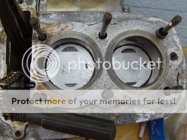

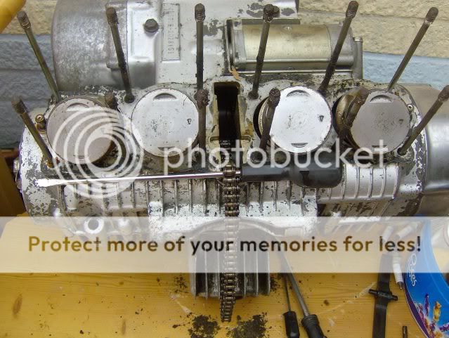

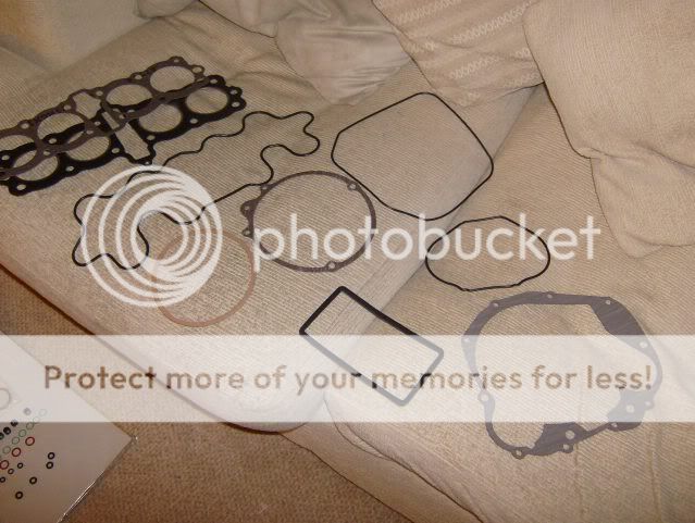

PostPosted: 00:55 - 14 May 2011    Post subject: Reply with quote

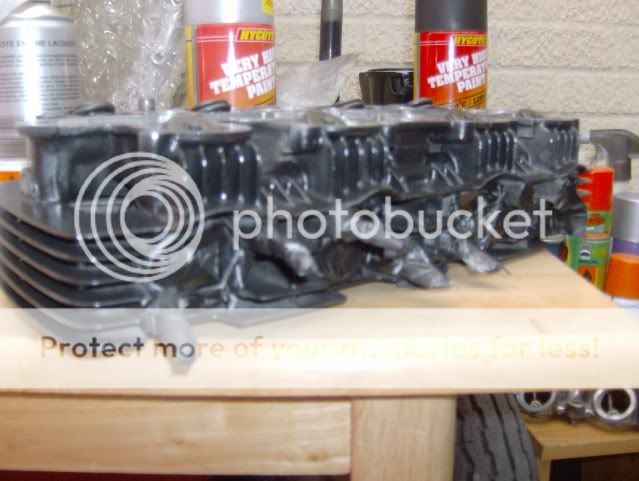

engine was stripped to base , pistons and rings were pretty good and ok to go back in ... had this checked by an ex 70's honda mechanic and gave me the green light
https://i156.photobucket.com/albums/t6/mike070868/cylinderhead001.jpg
https://i156.photobucket.com/albums/t6/mike070868/cylinderhead003.jpg
https://i156.photobucket.com/albums/t6/mike070868/gasket2.jpg

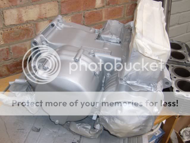

PostPosted: 00:57 - 14 May 2011    Post subject: Reply with quote
paint this time.. high temp paint
https://i156.photobucket.com/albums/t6/mike070868/engine016.jpg
https://i156.photobucket.com/albums/t6/mike070868/engine017.jpg

PostPosted: 07:00 - 14 May 2011    Post subject: Reply with quote
Looking good, but I would have taken the dipstick out before spraying the engine, that's going to flake when you undo it Smile

PostPosted: 12:05 - 14 May 2011    Post subject: Reply with quote
yeah your probably right about dipstick .. i will find out later Laughing
could always do it in black

Did you put new headstock bearings in? Its something I normally do on a full build.

yes mate i did... david silvers is loving me at the moment
if i recall bearings were loose.. now got the new tapered roller bearings.. feels much better
trying to keep it looking original as i can but if there are better safer items i am going to use them
learning as i go and you get to know the bike better as well

PostPosted: 13:30 - 14 May 2011    Post subject: Reply with quote
Embarassed
yeah good spot , of course i meant green light ,he gave it a good look over
not entirely sure what he was looking for, engines on these seem pretty tough and well built, it had good compression but did have a couple of leaks
stem seals were one of the items he suggested changing, he had a good look at pistons and they seemed fine
main problem was getting out the oil filter bolt
basically all i have done is change all gaskets down to base gasket
cam chain was also fine

i have some questions as well to ask
want to do some upgrades if possible, one being the new headstock bearings and tyres spring to mind
4 into 4 exhaust now unavailable, i have the exhausts but there like dust inside
david silvers only list a motad 4 into 1, £250 good value? any downsides in going 4 into 1 ?
https://i156.photobucket.com/albums/t6/mike070868/taper1-1.jpg
headstock going on

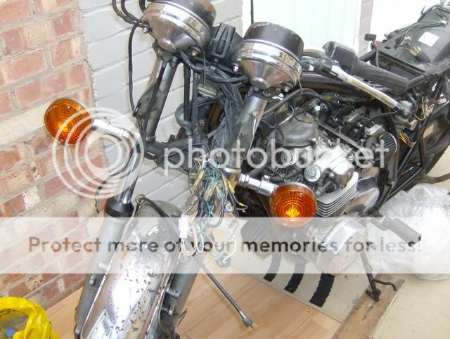

the amount of crud on it though was pretty bad
to give you an idea
https://i156.photobucket.com/albums/t6/mike070868/Picture071.jpg
after
https://i156.photobucket.com/albums/t6/mike070868/HPIM1963.jpg
still got the wiring to do which i am dreading

On the tyre front, for a bike like that it would depend on sizes. I would suspect that Bridgestone BT45s would be a good choice, assuming it has similar sizes to the usual commuter bikes.
Head bearings are head bearings pretty much. Fit the new ones, they'll be smooth and not have play in them. Sorted, that's all you need.
Exhaust wise, 4-1 is fine. Although the Motad one I had on my old XJ600 wasn't of the best quality, and didn't look fantastic. £250 is a fair amount of money, but if it's for a full system you won't find a lot cheaper.

PostPosted: 14:56 - 14 May 2011    Post subject: Reply with quote
I would try and hunt out replica four pipes.
4-1 was common 'in the day', but now, they are more atractive / desirable, with original four pipes.
Dave Silvers are good, but they are a Super Market for all things Honda, they dont always have the niggly bits a restorer wants.
There are plenty of specialists making replica chrome pipes, and even if you cant get a full system, you almost certainly will be able to get something more 'sympathetic' by way of pattern silencers, some one can bend some headers to, for you to get chromed.
Bit of research needed I reckon.
Given what you must be spending on this bike... its those 'little' things that make the difference between achieving the 'restored' look you want, or merely another tarted old up old bike.
Other wise, keep an eye on the oil seals, particularly the sprocket and gearbox shaft seals, one or other is particularly prone to popping, and I 'think' its the gear selectorshaft seal that can inadvertantly be fitted backwards!

PostPosted: 17:29 - 14 May 2011    Post subject: Reply with quote
id get the exhaust system sand blasted.
see what its like after that, if its good, get it ceramic coated, you keep the 4>4 and it looks nice.

4-1 tends to give more mid range, but less top end power, also looks wise the 4 pipes are very very nice.
