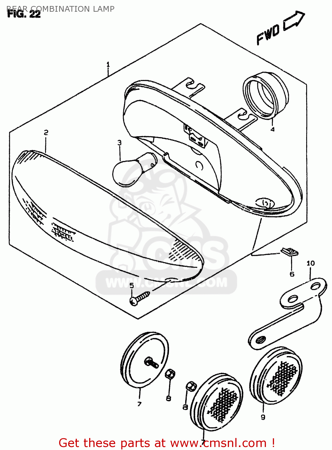

Chriss
Joined: 07 May 2005
PostPosted: 11:20 - 20 Apr 2011    Post subject: Reply with quote
Do you have a picture of it? I would have expected it to be a bayonet connector.
Is this it here? If so, push gently and twist. Also, have you changed the bulb recently? I once managed to put one in the wrong way, and so the brake light was permanently lit.
