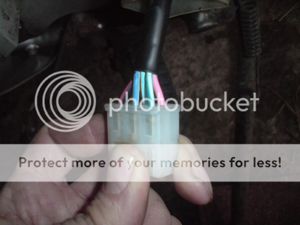

i charged the battery over night it was reading 12.65v this morning plugged it into the bike disconnected the reg/rec but the bike wont start with it disvonnected so i connected it back up started the bike tested the voltages across the terminals it stayed at 12.45v no matter what revs the bike was at.

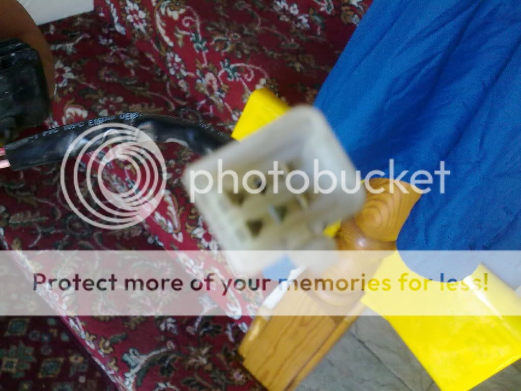

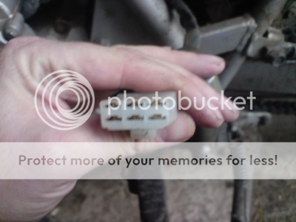

and also this is the plug coming out of my stator there are more than 3 wires in it
https://i787.photobucket.com/albums/yy156/jpderv/DSC00024.jpg
https://i787.photobucket.com/albums/yy156/jpderv/DSC00025.jpg

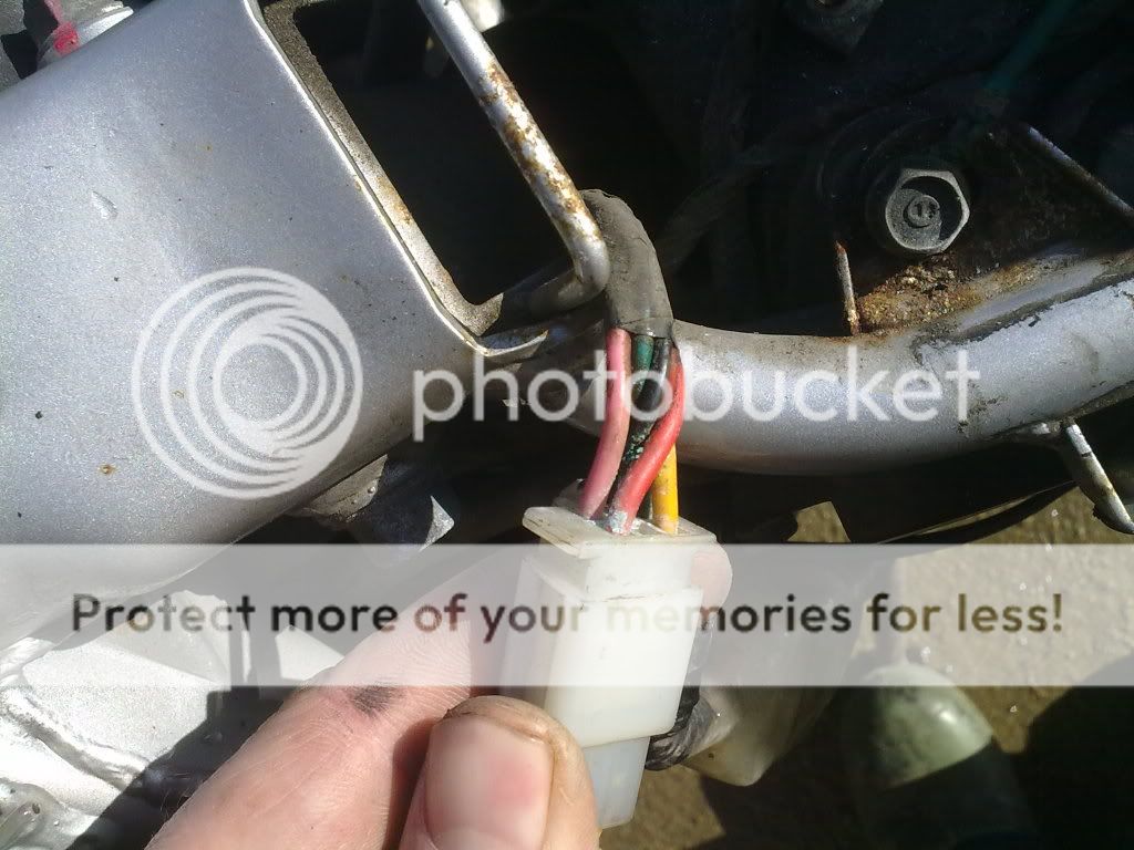

this is the rectifier theres five wires in that
https://i787.photobucket.com/albums/yy156/jpderv/18102011395.jpg
https://i787.photobucket.com/albums/yy156/jpderv/18102011399.jpg

unitynotsocri... This post is not being displayed because the poster is banned. Unhide this post / all posts.
jpderv
Joined: 11 Jun 2009
PostPosted: 20:13 - 21 Oct 2011    Post subject: Reply with quote
unitycrippledatmo wrote:
the stator wires will have two wires to the pick up/ign trigger and should have three to the charging/lighting circuit.by finding the colour codes (compare with other similar engines/models) you can test the resistance across the coils and pick up/ign trigger to see if they are knacked or not.Sometimes the insulation gets dry and brittle .before taking the stator cover off try checking the connector block contacts are clean and a tight fit.If you get a spark you can ignore the pick up/ign trigger coil.

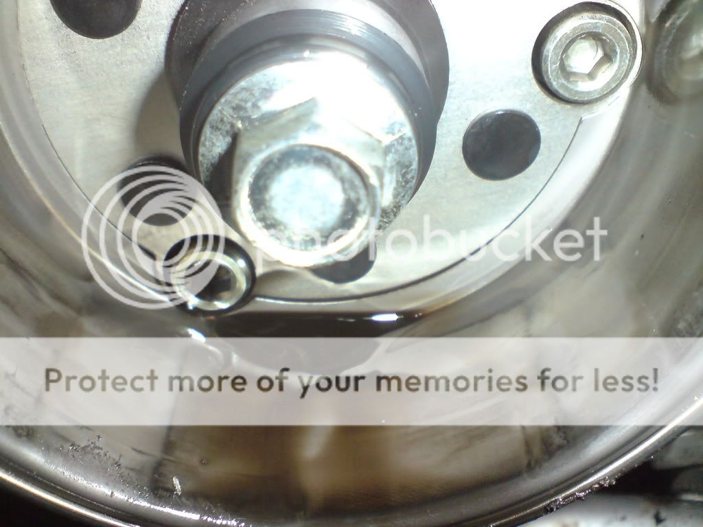

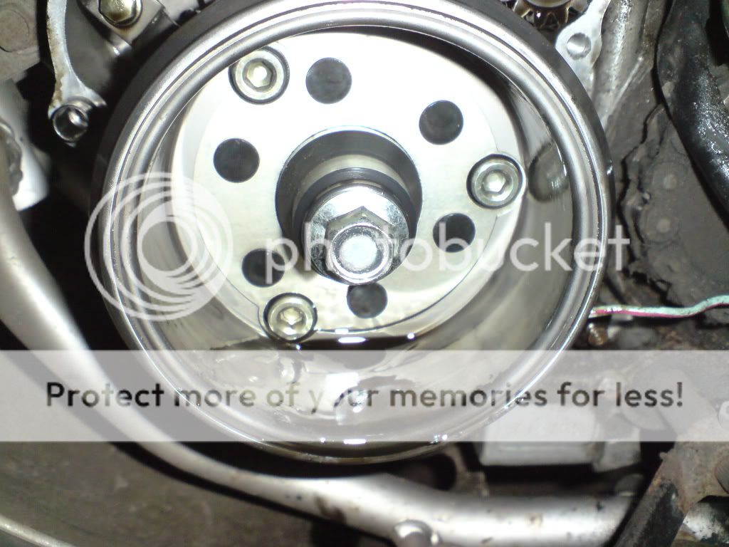

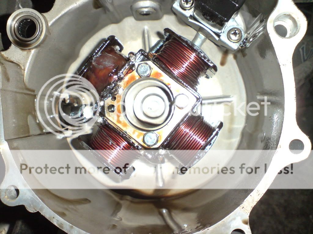

ok took the side casing off and there apeers to be oil inside there would that be anything to do with the bike not charging
https://i787.photobucket.com/albums/yy156/jpderv/DSC00029.jpg
https://i787.photobucket.com/albums/yy156/jpderv/DSC00030.jpg
https://i787.photobucket.com/albums/yy156/jpderv/DSC00031.jpg
does any off this look familiar?

jpderv
Joined: 11 Jun 2009
PostPosted: 21:13 - 21 Oct 2011    Post subject: Reply with quote
been rooting for a wiring diagram but no luck.you could try looking at alternator parts for eastern non jap bikes and see if you can find a coil set the same,making a note that one central coil is different,then,uses that as a guide to backtrack to 'resistance measurements.
many of these chinese bikes use the the same type coils

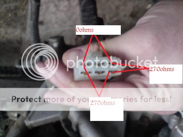

https://i787.photobucket.com/albums/yy156/jpderv/paint.jpg
i dunno if that makes any sense to you but thats the readings i got plus the ignition picup was 110ohms

Bezzer
Joined: 14 Apr 2005
PostPosted: 22:37 - 21 Oct 2011    Post subject: Reply with quote
12.65 isn't a fully charged battery but then again if it stays at 12.45 after starting it isn't too bad as it isn't receiving enough from the charging system too recharge it when running. If it won't start without the reg/rec connected it must be one of those systems that that splits the charge direct to the ignition side that can be used on the smaller bikes.
You really need a wiring diagram to work out which wires you need to be checking, guessing isn't going to help as electrickery can throw up some misleading results if you're checking the wrong bits. It's a stator, reg/rec or wiring fault but there's a lot of difference in the cost of each so it needs checking right before you have to splash out
