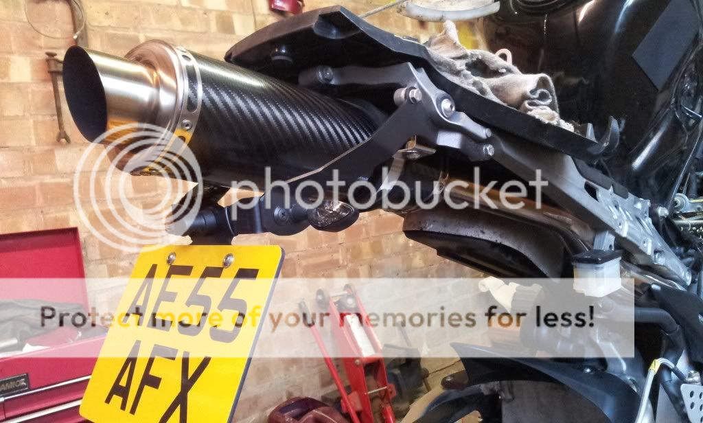

what i've fitted so far:
Moto gp carbon exhaust
evotech tail tidy
oxford mini LED indicators all round
slightly smaller plate
tinted double bubble screen
stubby brake/clutch levers

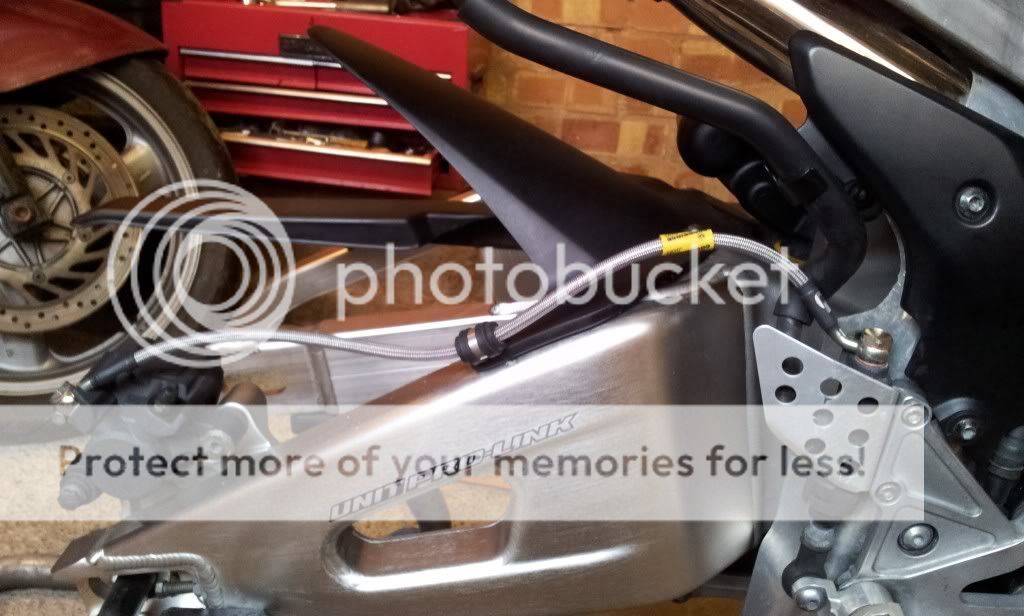

Goodridge braided brake lines all round
H.I.D headlight conversion
removed the catalytic converter (by removed i mean smashed out Laughing )
aftermarket fairing kit
honda rim stickers

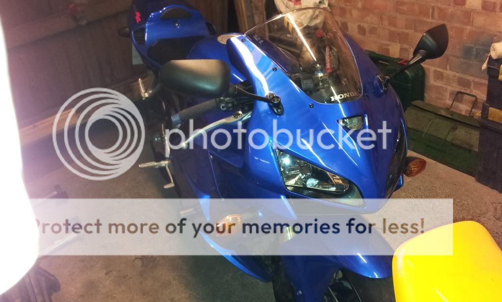

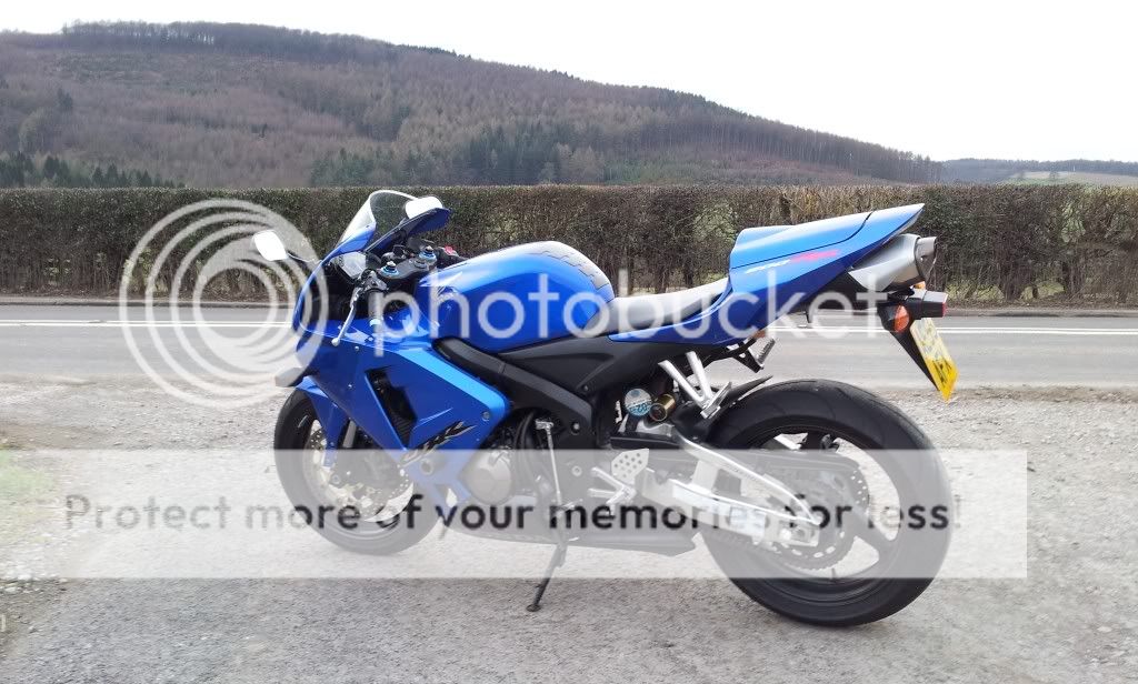

Here's how i got the bike, as you can see it is completely standard, which is nice as it means i have a blank canvas to start with.
https://i762.photobucket.com/albums/xx269/salty2121/cbr%20project/2012-02-26163625.jpg
https://i762.photobucket.com/albums/xx269/salty2121/cbr%20project/2012-02-25183512.jpg
https://i762.photobucket.com/albums/xx269/salty2121/cbr%20project/2012-02-25144947.jpg

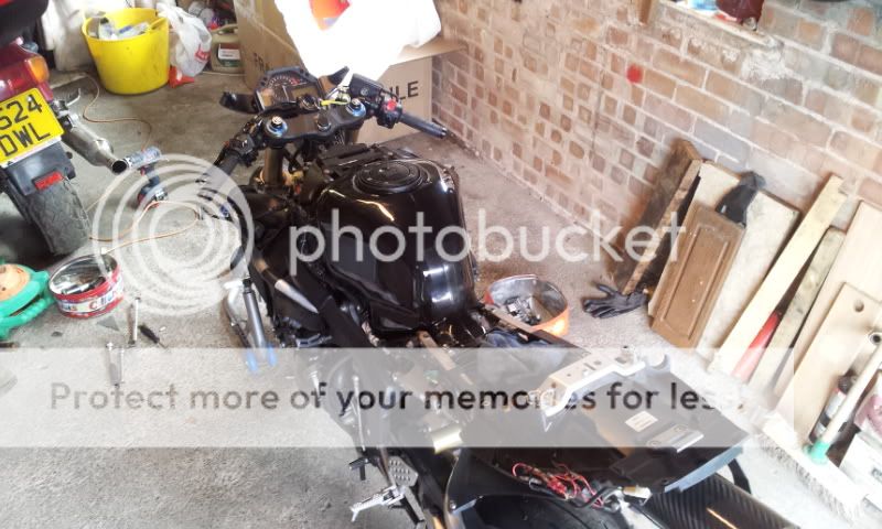

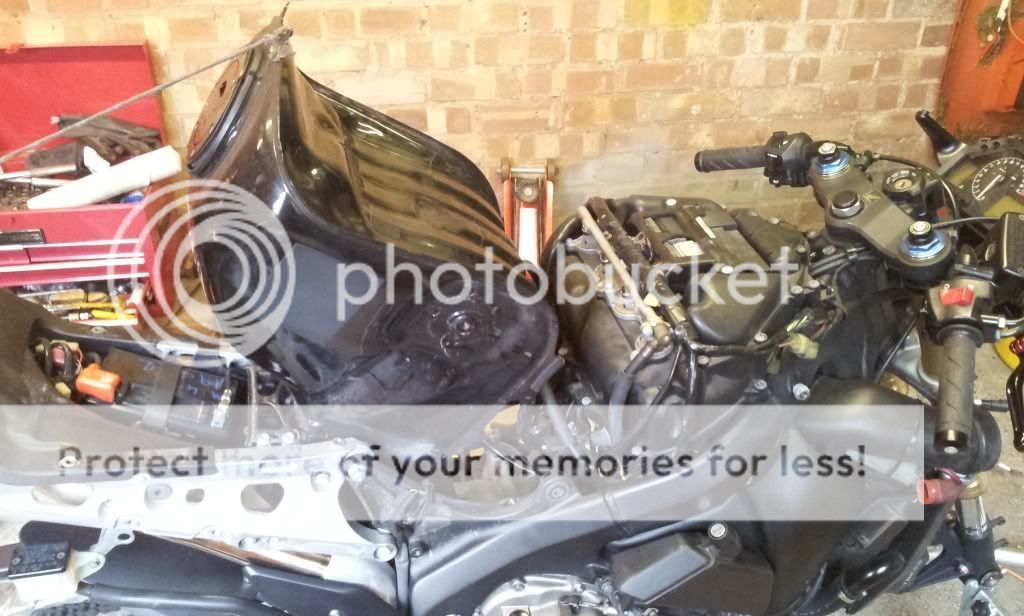

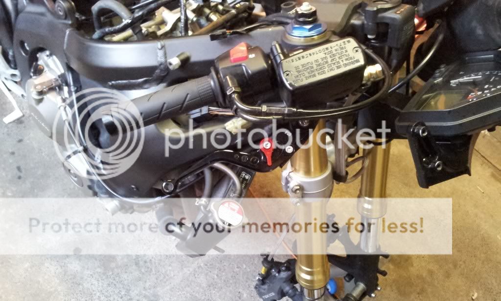

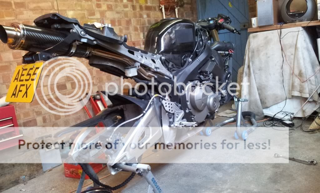

Whille i was waiting for the wheels i decided to get the fairings off and have a good cleanup behind there
https://i762.photobucket.com/albums/xx269/salty2121/cbr%20project/2012-03-31165611.jpg
https://i762.photobucket.com/albums/xx269/salty2121/cbr%20project/2012-03-31151339.jpg
https://i762.photobucket.com/albums/xx269/salty2121/cbr%20project/2012-03-31165637.jpg
https://i762.photobucket.com/albums/xx269/salty2121/cbr%20project/2012-03-31165625.jpg
https://i762.photobucket.com/albums/xx269/salty2121/cbr%20project/2012-04-04143320.jpg
https://i762.photobucket.com/albums/xx269/salty2121/cbr%20project/2012-04-04142916.jpg

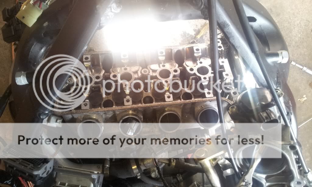

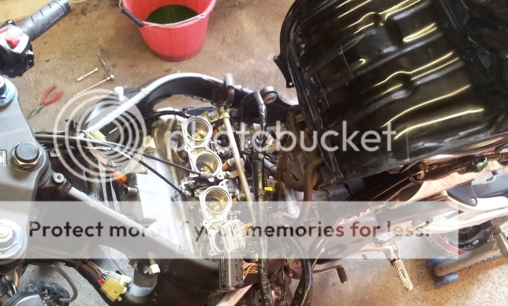

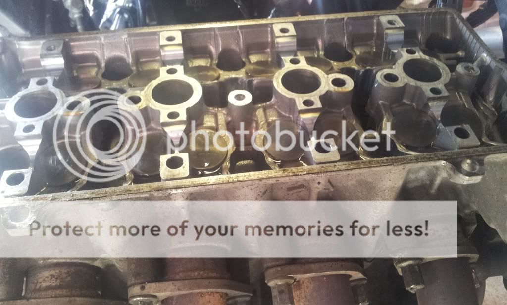

Then i thought while i was there i may aswell check the valve clearences and change the coolant so set to work on that.
https://i762.photobucket.com/albums/xx269/salty2121/cbr%20project/2012-03-31151841.jpg

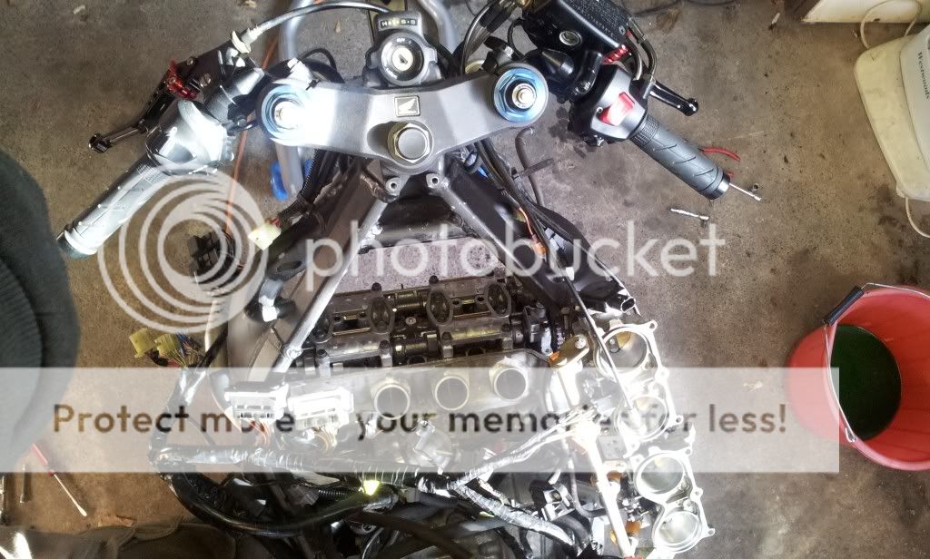

airbox off
https://i762.photobucket.com/albums/xx269/salty2121/cbr%20project/2012-04-01090452.jpg
radiator off
https://i762.photobucket.com/albums/xx269/salty2121/cbr%20project/2012-04-01090440.jpg
throttle bodies off (sort of Laughing )
https://i762.photobucket.com/albums/xx269/salty2121/cbr%20project/2012-04-01093855.jpg

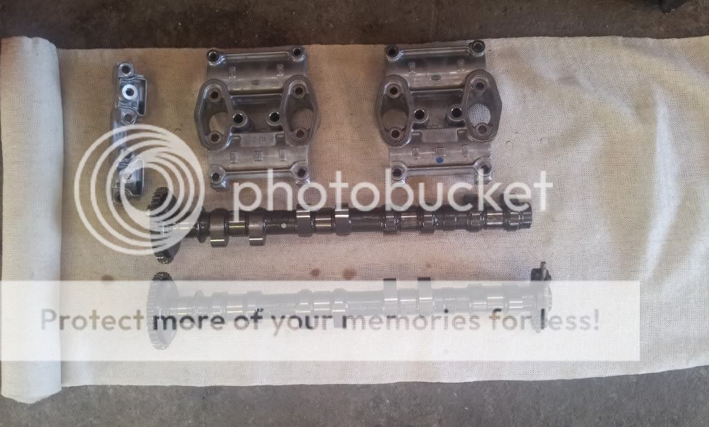

valve cover off and checked clearences, the bike has only covered 12,000 miles so was a bit suprised when i found one of the clearences was out. So off came the holders and cams.
https://i762.photobucket.com/albums/xx269/salty2121/cbr%20project/2012-04-01110607.jpg
https://i762.photobucket.com/albums/xx269/salty2121/cbr%20project/2012-04-01110546.jpg
https://i762.photobucket.com/albums/xx269/salty2121/cbr%20project/2012-04-01110528.jpg
Went and got the new shim from cmc bikes up the road where they charge £3 for a shim exchange Confused . I would have just payed £5 for a new one and kept the other as a spare but i like to get it back together while it's all still fresh in my head where everything goes and also there is less time for stuff to go missing Laughing .
the bike is now back in one piece minus the wheels and fairing but i'll update when they arrive whch should be any day now.

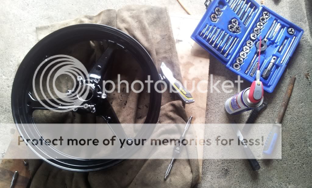

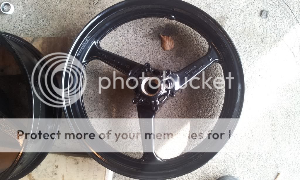

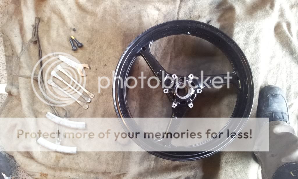

Got the wheels back from the powder coaters, im happy with the finish but despite me telling them to mask off all the bits that are not currently painted and actually standing there and pointing all the bits out they managed to powder coat all the threaded holes for the disc bolts, all the mating surfaces for the discs and was a fair bit inside the bearing holes aswell Confused
https://i762.photobucket.com/albums/xx269/salty2121/cbr%20wheels/2012-04-06112500.jpg
managed to scrounge a tap and dye set from the garage up the road and started re-tapping all the disc bolt holes to remove all the paint
https://i762.photobucket.com/albums/xx269/salty2121/cbr%20wheels/2012-04-06125911.jpg

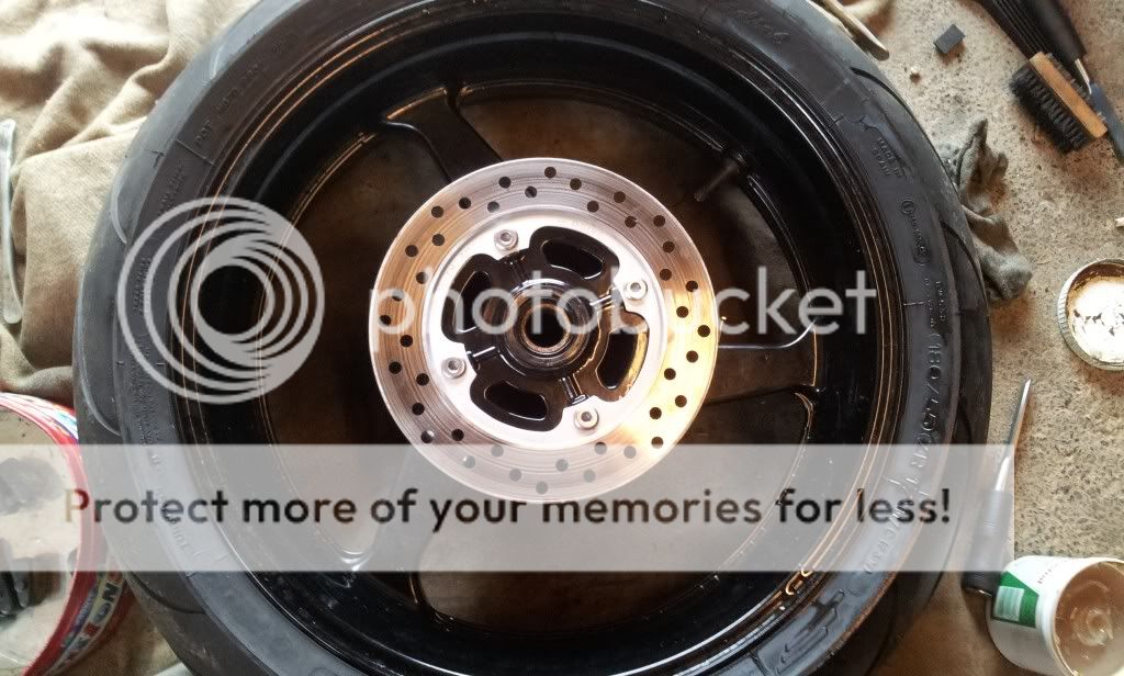

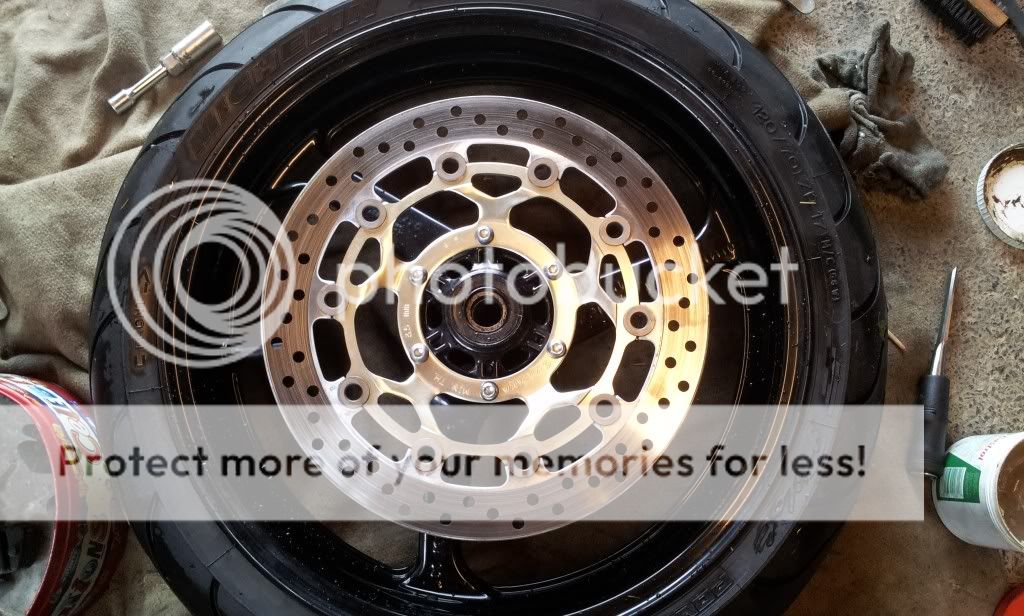

Used a sharp chisel to scrape off all the mating surfaces for the discs and got set up for putting the tyres back on
https://i762.photobucket.com/albums/xx269/salty2121/cbr%20wheels/2012-04-06141850.jpg

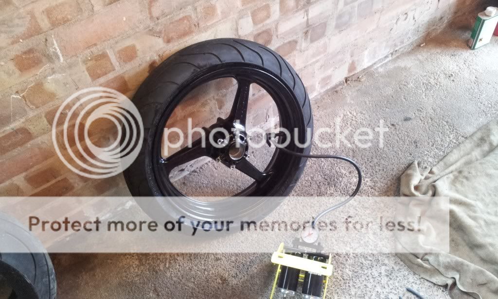

front tyre fitted and ready for pumping back up. Sealing a tyre onto a bead does not require a compressor, contrary to popular belief, my footpump method works first time everytime Cool
https://i762.photobucket.com/albums/xx269/salty2121/cbr%20wheels/2012-04-06142841.jpg

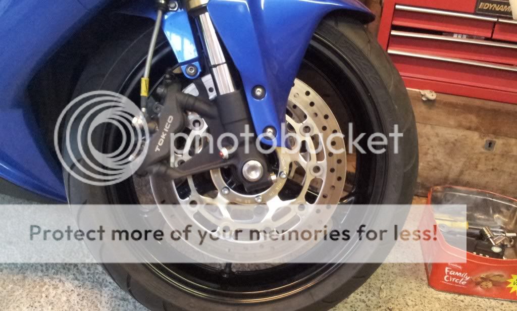

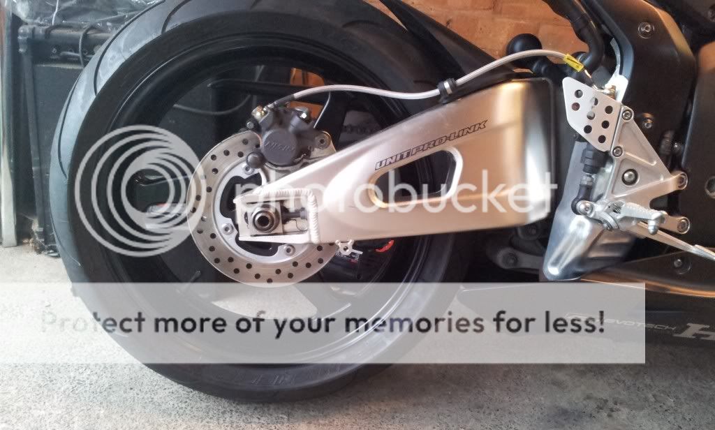

cleaned up all the discs and refitted them with new bolts all round, also refitted the bearings and dust seals
https://i762.photobucket.com/albums/xx269/salty2121/cbr%20wheels/2012-04-06153314.jpg
https://i762.photobucket.com/albums/xx269/salty2121/cbr%20wheels/2012-04-06154110.jpg

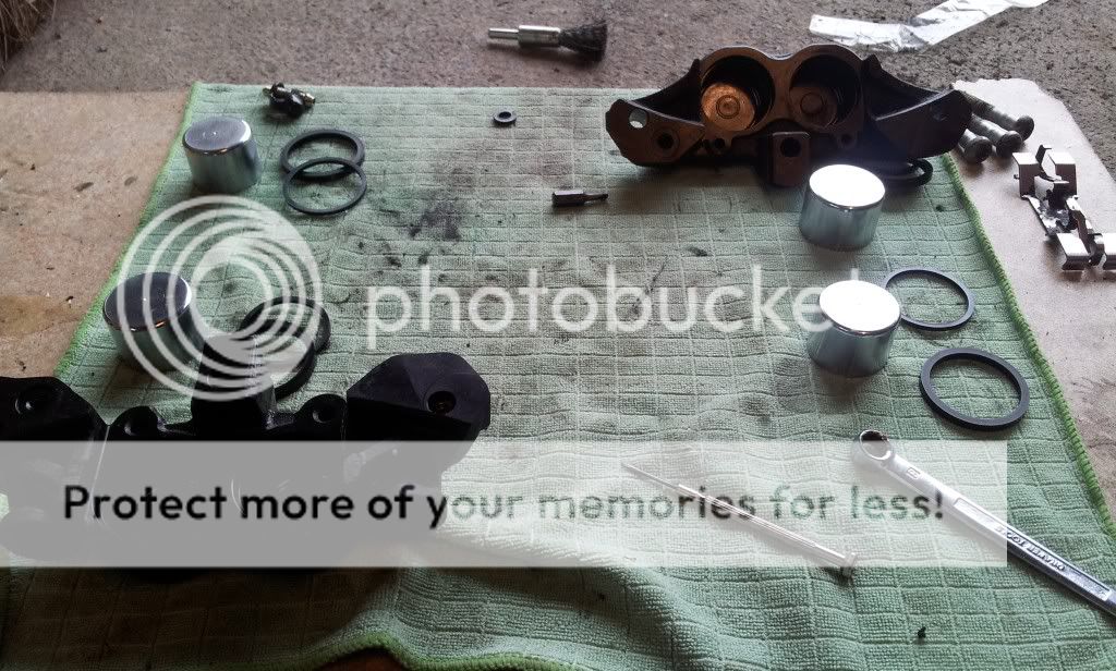

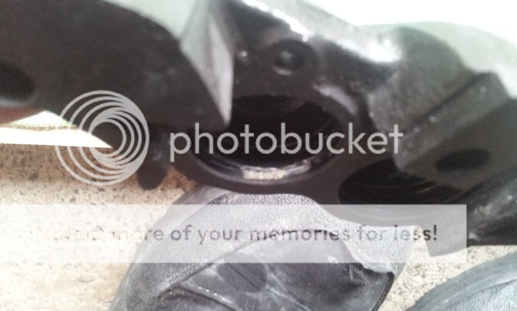

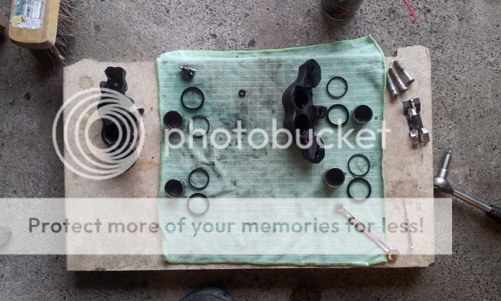

next job was to strip and clean the R/H front caliper, i did the L/H one last week and it's not my favourite job so couldnt be arsed to do them both at the same time Laughing . They were ready for doing though as there was a fair bit of winter crud behind the dust seals, the oil seals were fine though.
https://i762.photobucket.com/albums/xx269/salty2121/cbr%20wheels/2012-04-07110538.jpg
salty buildup behind the dust seal groove
https://i762.photobucket.com/albums/xx269/salty2121/cbr%20wheels/2012-04-07110602.jpg
all cleaned and ready for re assembly
https://i762.photobucket.com/albums/xx269/salty2121/cbr%20wheels/2012-04-07112946.jpg

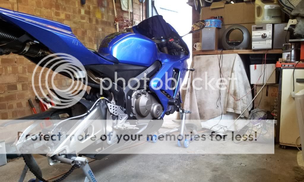

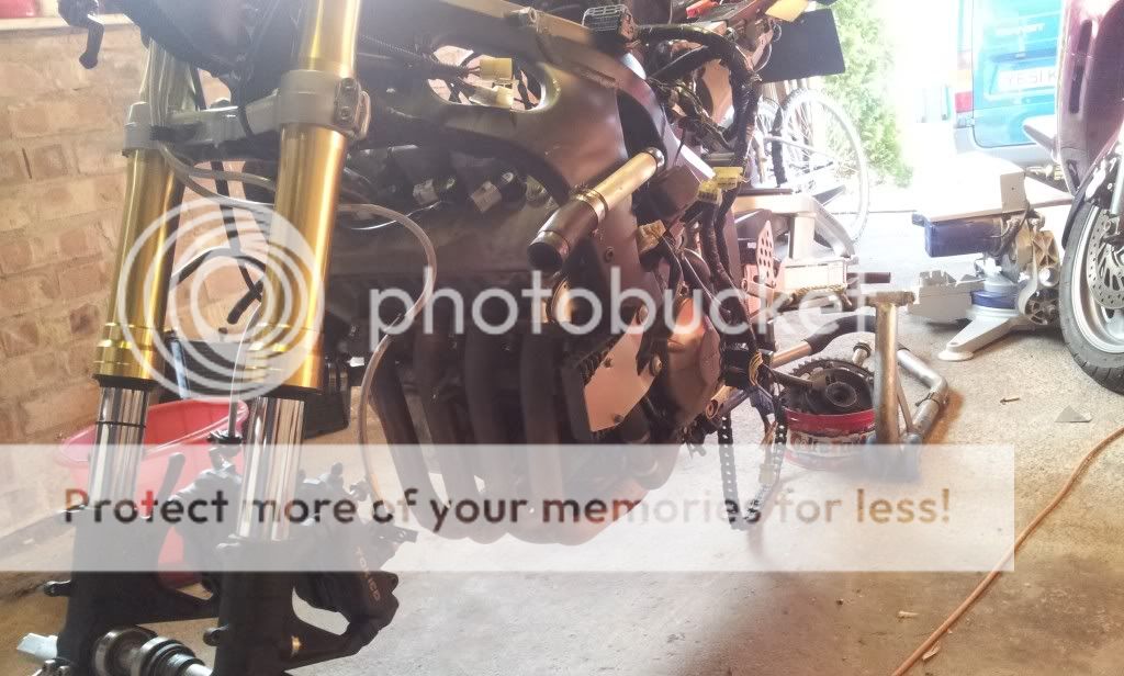

wheels and caliper refitted and put the old fairings back on for now as i hav'nt riddent if for a while and was itching to get out on it Laughing
https://i762.photobucket.com/albums/xx269/salty2121/cbr%20wheels/2012-04-06184457.jpg
https://i762.photobucket.com/albums/xx269/salty2121/cbr%20wheels/2012-04-06184524.jpg
https://i762.photobucket.com/albums/xx269/salty2121/cbr%20wheels/2012-04-06184543.jpg
My fairing kit is still sat in parcelfarces depot so wont be seeing them till next week, will update again when they arrive

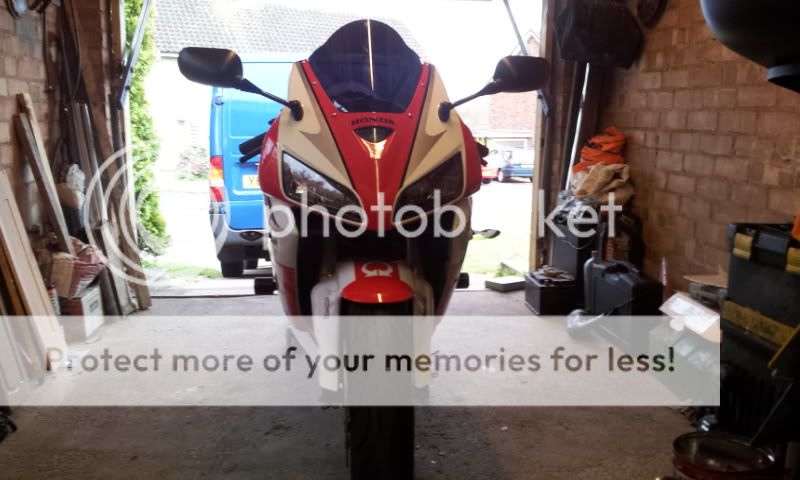

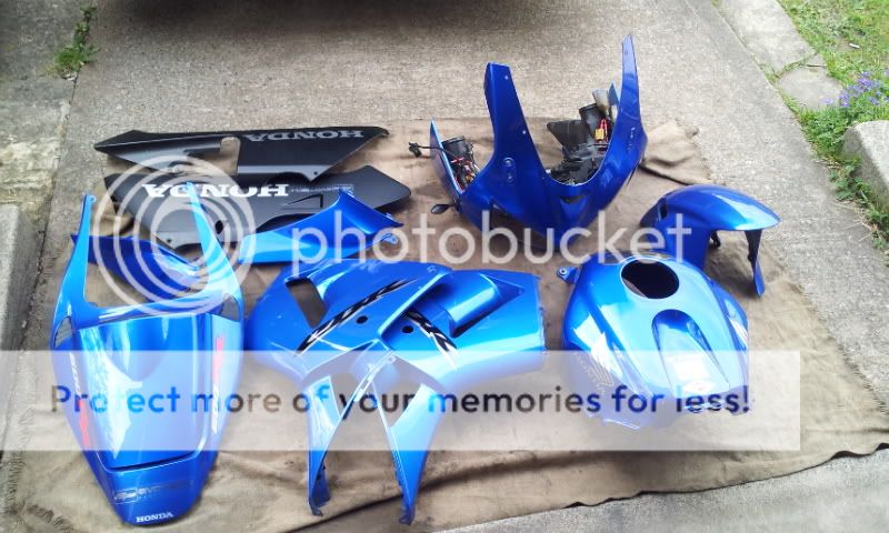

parcel arrived!!!
downside is customs decided i needed to pay £190 Evil or Very Mad
I think they must have made a mistake somewhere so i'm looking into that and will hopefully see some of it refunded by around 2015 knowing what there like Confused
On the upside they have made a really nice job of the paintwork and i'm dead impressed with it and hopefully it will fit as well as it looks. Not started fitting it yet but will be up at the crack of dawn and will have it done by tomorrow afternoon.
https://cdn.bikechatforums.com/files/002_128.jpg
https://cdn.bikechatforums.com/files/001_208.jpg

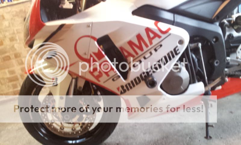

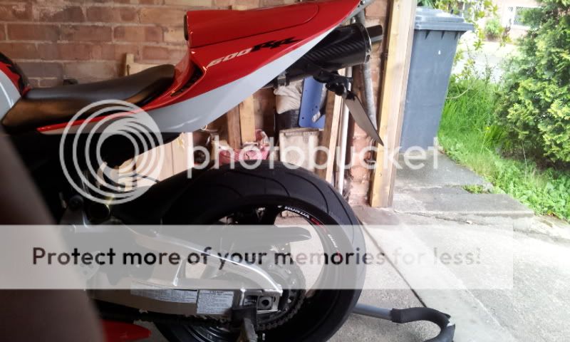

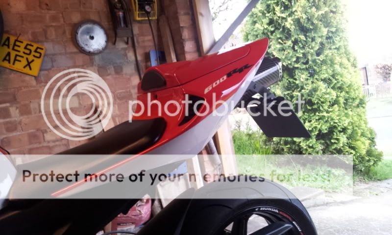

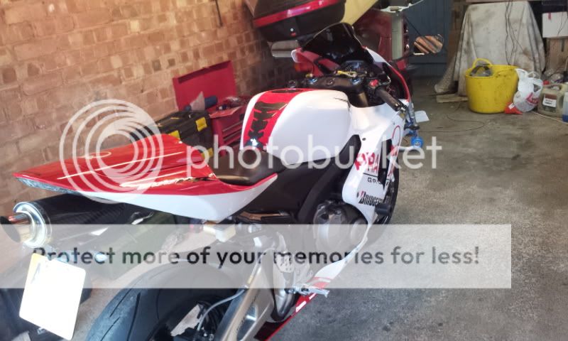

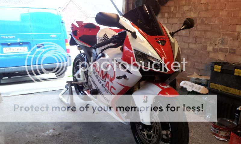

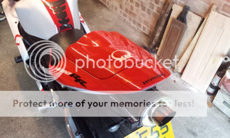

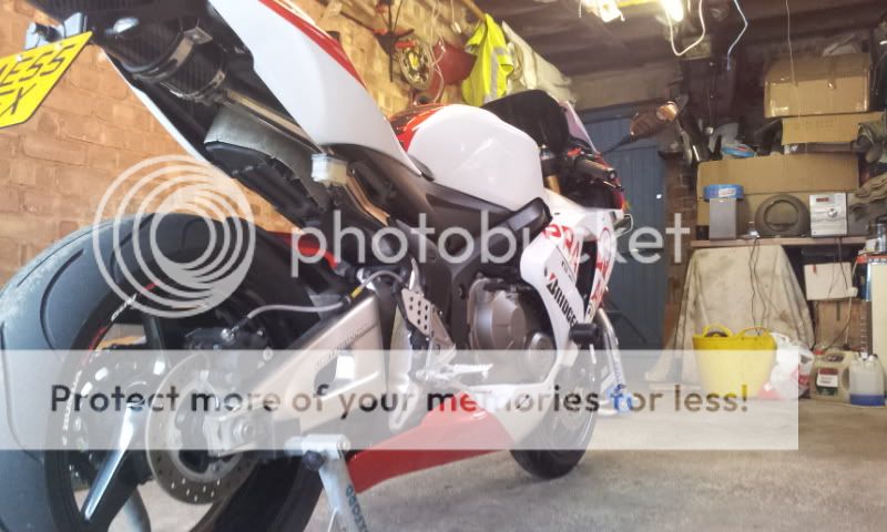

just finished putting the fairings on, as expected i had to clean some paint out a few holes and do a bit of jiggling to make it all fit together properly but nothing drastic.
Also put some stickers on the wheels to finish it off which fit in quite nice i think.
out with the old
https://i762.photobucket.com/albums/xx269/salty2121/cbr%20fairing/2012-04-14101736.jpg
https://i762.photobucket.com/albums/xx269/salty2121/cbr%20fairing/2012-04-14101800.jpg
in with the new
https://i762.photobucket.com/albums/xx269/salty2121/cbr%20fairing/2012-04-14172306.jpg
https://i762.photobucket.com/albums/xx269/salty2121/cbr%20fairing/2012-04-14172254.jpg
https://i762.photobucket.com/albums/xx269/salty2121/cbr%20fairing/2012-04-14172320.jpg
https://i762.photobucket.com/albums/xx269/salty2121/cbr%20fairing/2012-04-14172338.jpg
https://i762.photobucket.com/albums/xx269/salty2121/cbr%20fairing/2012-04-14172350.jpg
https://i762.photobucket.com/albums/xx269/salty2121/cbr%20fairing/2012-04-14172356.jpg
https://i762.photobucket.com/albums/xx269/salty2121/cbr%20fairing/2012-04-14172408.jpg
https://i762.photobucket.com/albums/xx269/salty2121/cbr%20fairing/2012-04-14172453.jpg
https://i762.photobucket.com/albums/xx269/salty2121/cbr%20fairing/2012-04-14172506.jpg
anthony_r6
Joined: 31 Mar 2011
PostPosted: 18:12 - 14 Apr 2012    Post subject: Reply with quote
The new fairings look incredibe. Great stuff!
Shaane
Joined: 28 Jul 2007
PostPosted: 18:29 - 14 Apr 2012    Post subject: Reply with quote
Looks absolutly lovely mate. A friend just put the Sterilgarda race colours on his and that's just as nice Smile Thumbs Up
Previous: 1992 DT125R
Current: ~ 2005 ZX6R C1H
Valentino Mossy
Joined: 13 Jul 2003
PostPosted: 20:51 - 14 Apr 2012    Post subject: Reply with quote
Very nice !!! Love the colour change !!
