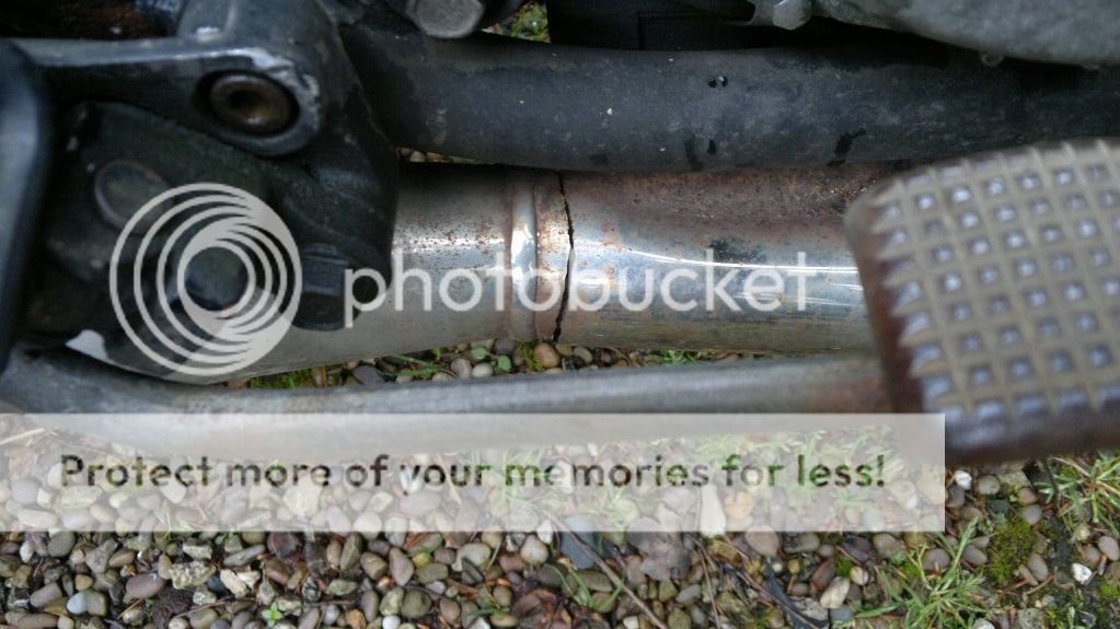

Thought the old Kawasaki GT550 was sounding a little fruity this morning.
Just checked and found exhaust snapped.

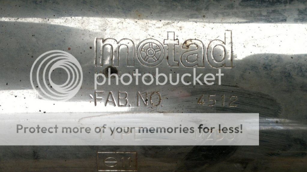

Rear section, it's a Motad 4 to 1 system.
Just wondered if it can be welded in the short term (cash flow problems) to get me by. It's my default work transport atm so can't afford (literally) to be without. Can also consider somewhere in Leeds (east side, Harehills, Cross Gates, etc. preferably) if any recommendations.
I know a complete new system is around £316 (wemoto - same as motad list price) and I can't source just the rear (after in becomes 1 from 4). Not much I can see on eBay (looked for gpz550, z550, etc.). I know an old GPZ550 is sat at a repair shop but he's wanting to sell who'd bike rather than bits. So how much would that be?
Any recommendations welcome.
Please excuse fone camera pics...

You can get that welded an an exhaust place
Should be one nearish to you and they should be able to weld it really cheap

Cheap option...
Exhaust wrap and a soup/bean tin.. Or beer can to hold it in place. Thumbs Up
I doubt that any exhaust centre would weld that exhaust for you. They are usually only interested in selling new systems.

they would weld it, but will load the price, if you can get it off and to leeds road area of bradford pm me

looks to ba a pretty clean break and should be able to repair it easily, not sure about welding but i reckon i could temporary repair it for you i see you pretty close hit me with a pm if i can assist you.

I have repaired a motad with a similar problem, but it wasn't just a simple weld - the metal had rusted very thin, too thin to weld, particularly with a chrome coating.
I fixed it by sleeving it with some mild steel pipe I had, in the same internal diameter of the external diameter of the exhaust. I cut a 1 inch sleeve, then cut it into two halves (2 half circles). I clamped the sleeve sections tight around the crack with a few mil of space at the joins, welded them together, then left it clamped to cool. It tightened up as it cooled, and left me with a good tight seal.
Ugly, but functional. Better to sleeve on the outside, if you sleeve on the inside you're creating a restriction in the airflow.

...with either exhaust paste, or silicon sealant (the clear stuff) stuffed into your crack!! Twisted Evil

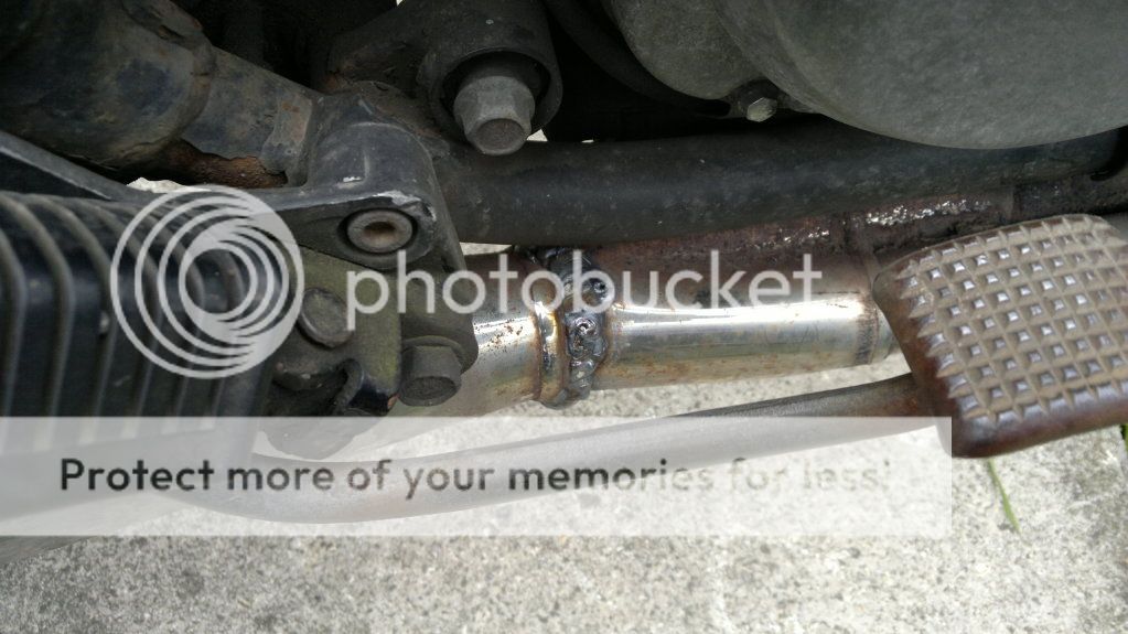

Now all welded at local MOT place. Cost 30 of my hard earned beer tokens. May not be pretty but it works, suits me and that's all I need. Whether I could have got it done for less is now just water under the bridge, just glad it's sorted.

PostPosted: 16:31 - 02 Jun 2012    Post subject: Reply with quote
Jesus! I'd have done it better than that for free!

PostPosted: 17:01 - 02 Jun 2012    Post subject: Reply with quote
Was that done by Stevie Wonder?

PostPosted: 17:55 - 02 Jun 2012    Post subject: Reply with quote
£30 for that mess? A tenner would have been a liberty.

PostPosted: 18:04 - 02 Jun 2012    Post subject: Reply with quote
Looks pretty bad,
You might want to go over that with some Hammerite, It will rust like mad.
Paint will make it look better too.

Warped did it Via Bluetooth/WiFi.

PostPosted: 20:26 - 02 Jun 2012    Post subject: Reply with quote
he obviously blew holes in it with a mig welder
That should of been tig welded.
Did the exhaust even come off the bike?

PostPosted: 23:20 - 02 Jun 2012    Post subject: Reply with quote
It's a very untidy, though functional, repair. If you want it to last then you aught to consider fabricating additional support brackets at either side of the weld.

PostPosted: 11:37 - 03 Jun 2012    Post subject: Reply with quote
at least it's 'fixed', welder i assume has parkinsons disease?
You mean he forgot how to prep and weld?
I personally think he is just autistic.

PostPosted: 15:57 - 03 Jun 2012    Post subject: Reply with quote
All the guy wanted was a quick fix to get him on the road. The exhuast looks like its about to get changed soon when money is available so it looks like job done to me.

PostPosted: 16:24 - 03 Jun 2012    Post subject: Reply with quote
Could you possibly sand it down so it's slightly less bumpy?
