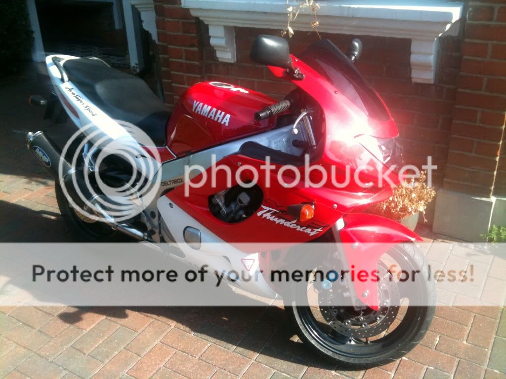

It started with my first bike bike, the Yamaha Thundercat YZF600R and ended with two crashes a bus crushing the remains being stolen, abandoned and recovered.
It started out its life with me looking like this
https://i878.photobucket.com/albums/ab349/slyrob/4893af6e.jpg
but unfortunately that did not last....

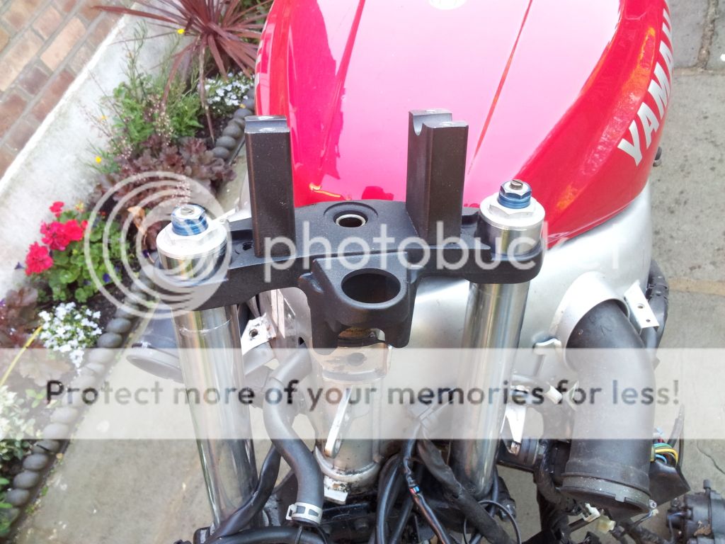

spare fzr yokes/risers sprayed badly with left over high temp paint and matt lacquer. Renthal ultra lows on the way from busters.

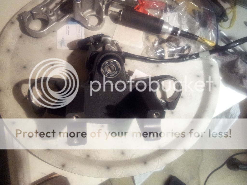

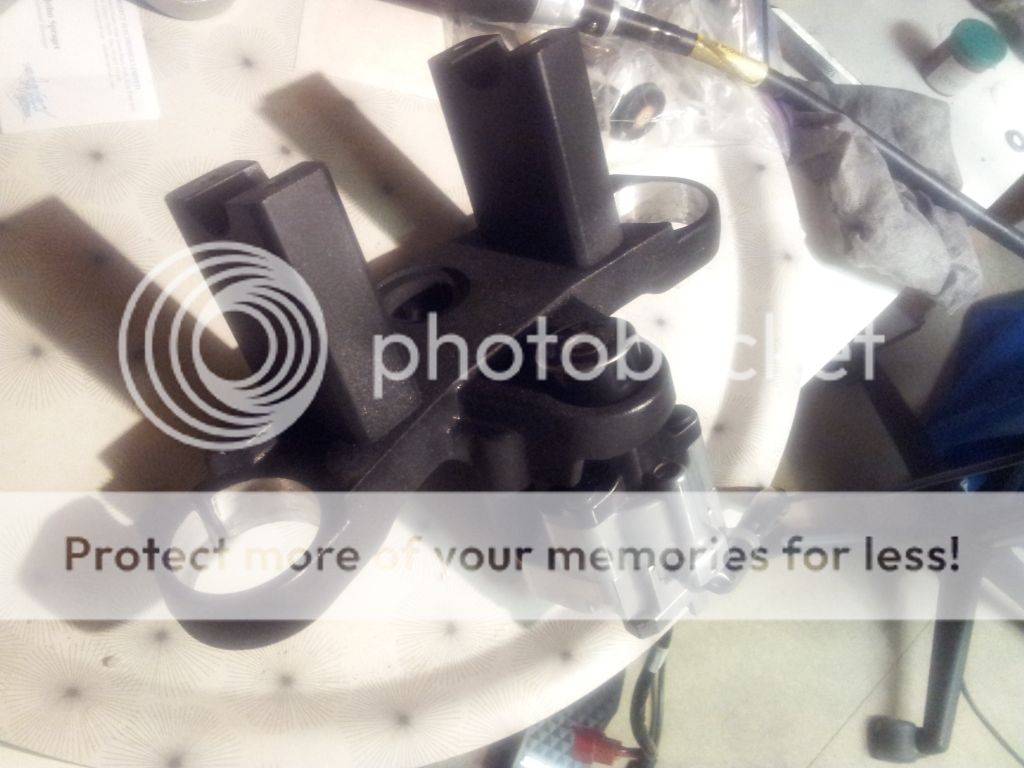

Also forgot to mention that removing locks from the old yoke was an absolute nightmare of a long arsed grinding session last night. Had I known it would take this long I would have just drilled holes in my own yoke instead of keeping it in case i want to go back to clip ons.
However, I cleaned up the ignition and used a pendant drill to polish out the scratches in the plastic round the keyhole so that the text could be read again.
https://i878.photobucket.com/albums/ab349/slyrob/2012-06-11161211.jpg
https://i878.photobucket.com/albums/ab349/slyrob/2012-06-11161233.jpg

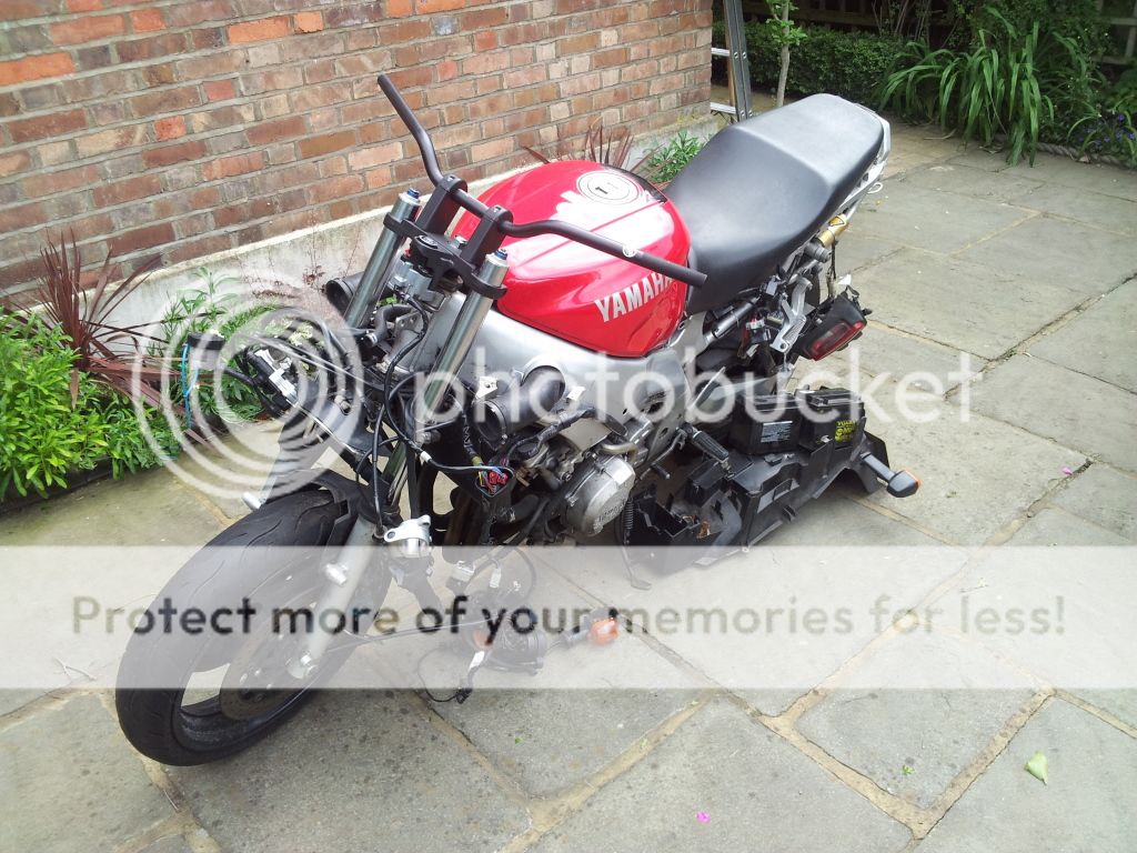

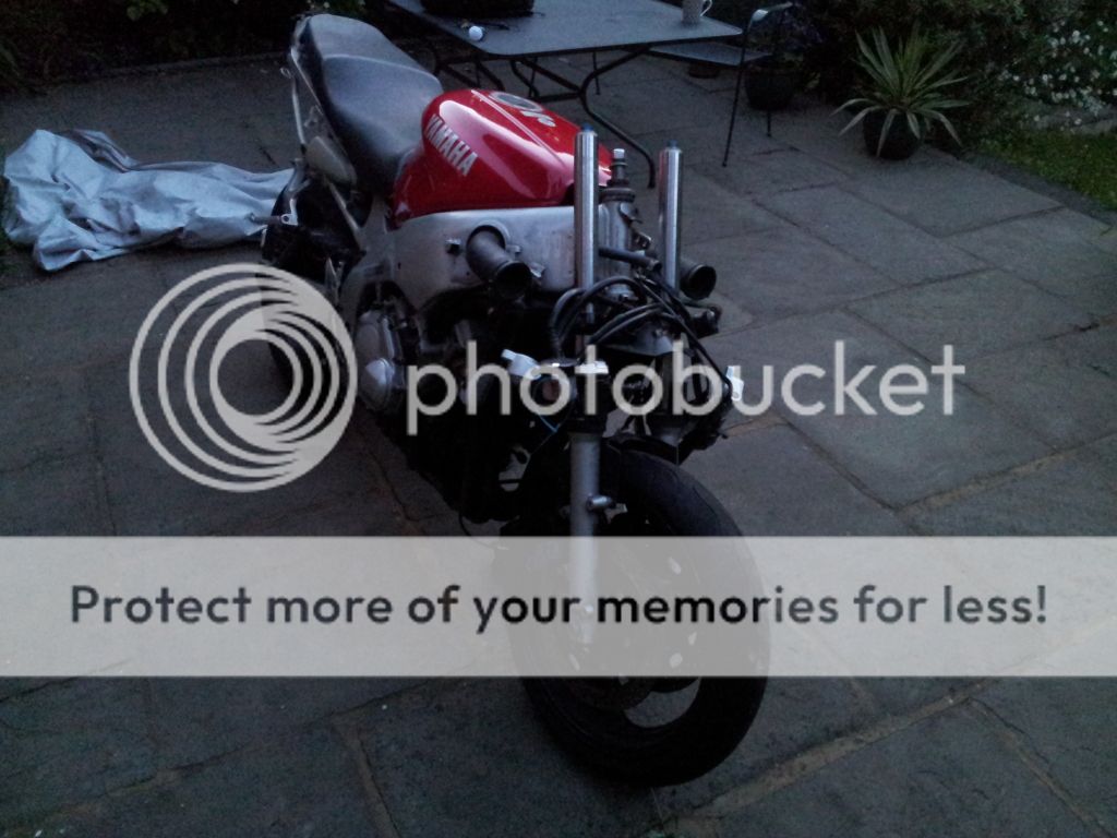

as it stands
https://i878.photobucket.com/albums/ab349/slyrob/2012-06-09213910.jpg
https://i878.photobucket.com/albums/ab349/slyrob/2012-06-09213901.jpg
https://i878.photobucket.com/albums/ab349/slyrob/2012-06-09213852.jpg
https://i878.photobucket.com/albums/ab349/slyrob/2012-06-09213837.jpg

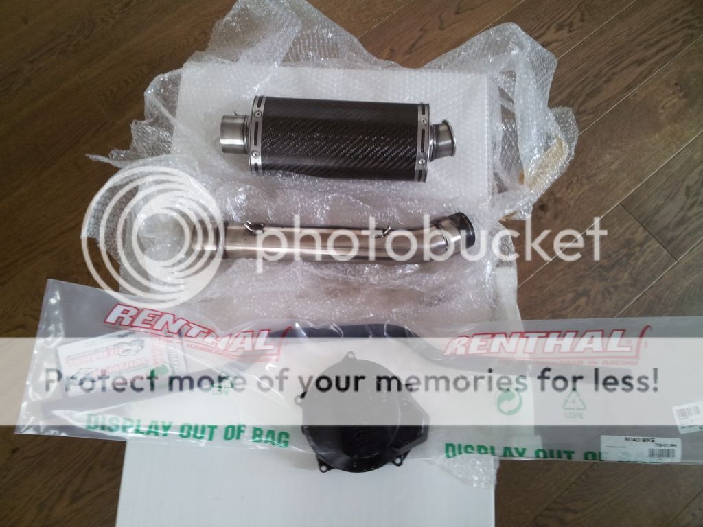

https://i878.photobucket.com/albums/ab349/slyrob/2012-06-13141311.jpg
happy delivery day!
although the stator cover will need a fair bit of work as its been badly welded by its previous owner but is still in less pieces than mine!

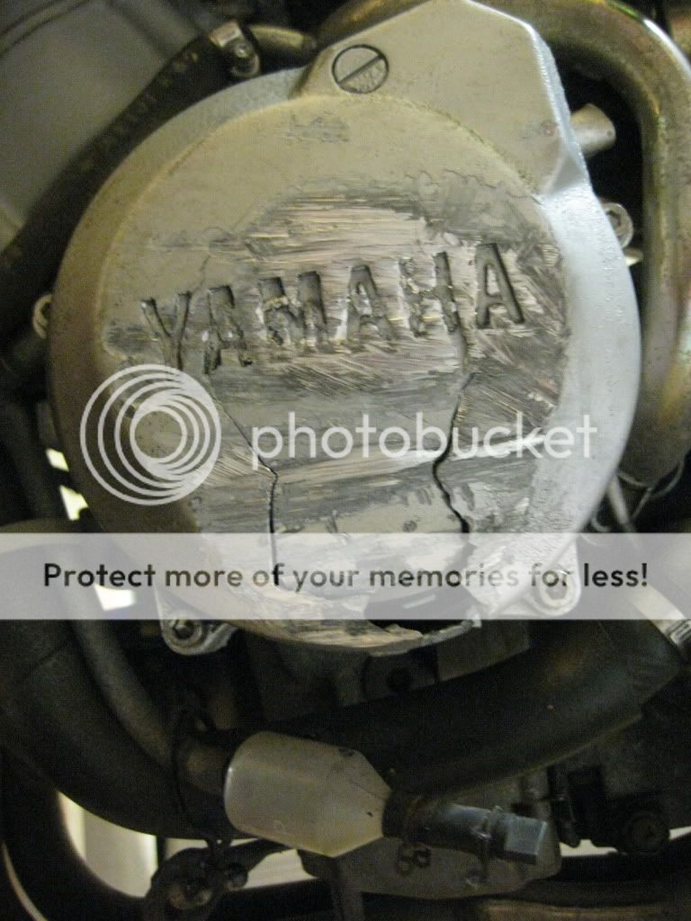

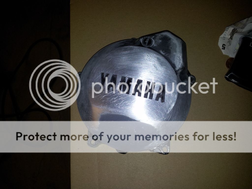

slyrob
Joined: 03 Jan 2010
PostPosted: 04:38 - 15 Jun 2012    Post subject: Reply with quote

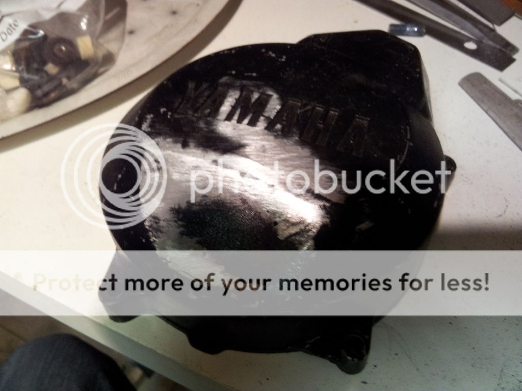

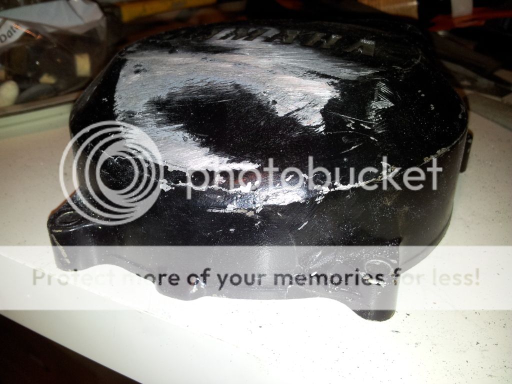

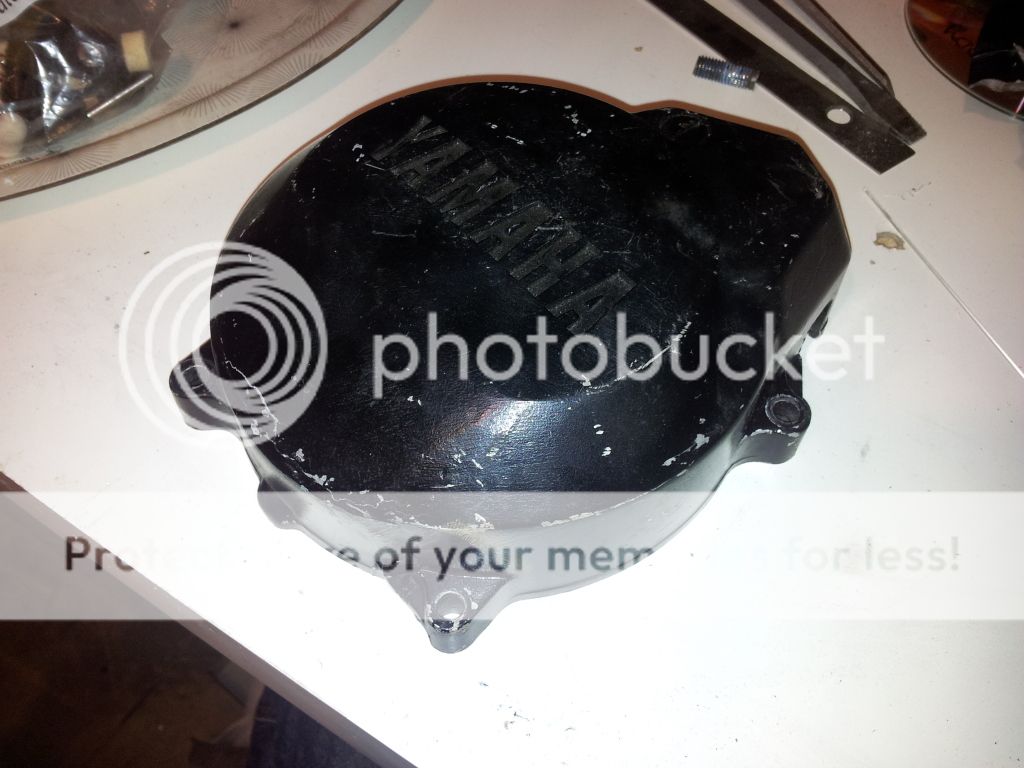

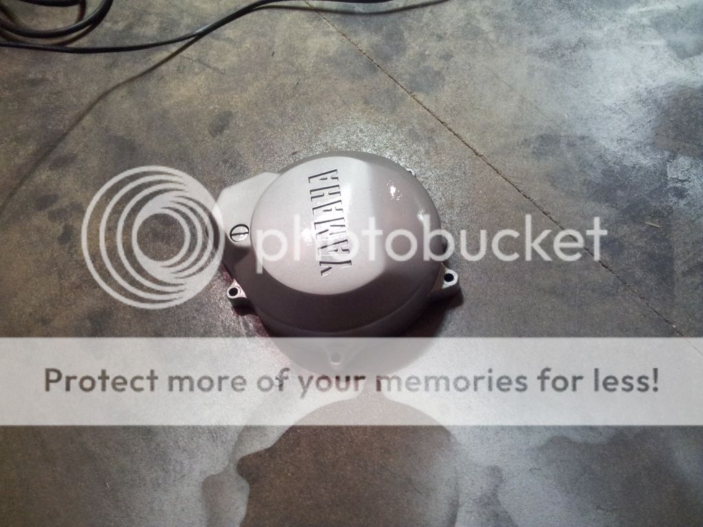

so that stator cover......
https://i878.photobucket.com/albums/ab349/slyrob/2012-06-15020554.jpg
the surface of this cover was all over the place so first i filed it over the surface of the metal to find the high and low spots
https://i878.photobucket.com/albums/ab349/slyrob/2012-06-15020911.jpg
https://i878.photobucket.com/albums/ab349/slyrob/2012-06-15020924.jpg

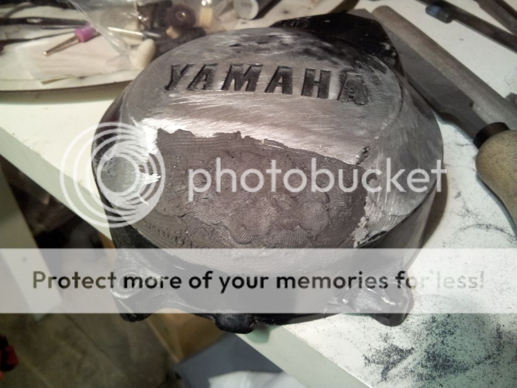

and revealed a fair bit of damage at the bottom edge where someone's attempt at a weld up had clearly failed.
Lots more filing and sanding followed.
then some more......

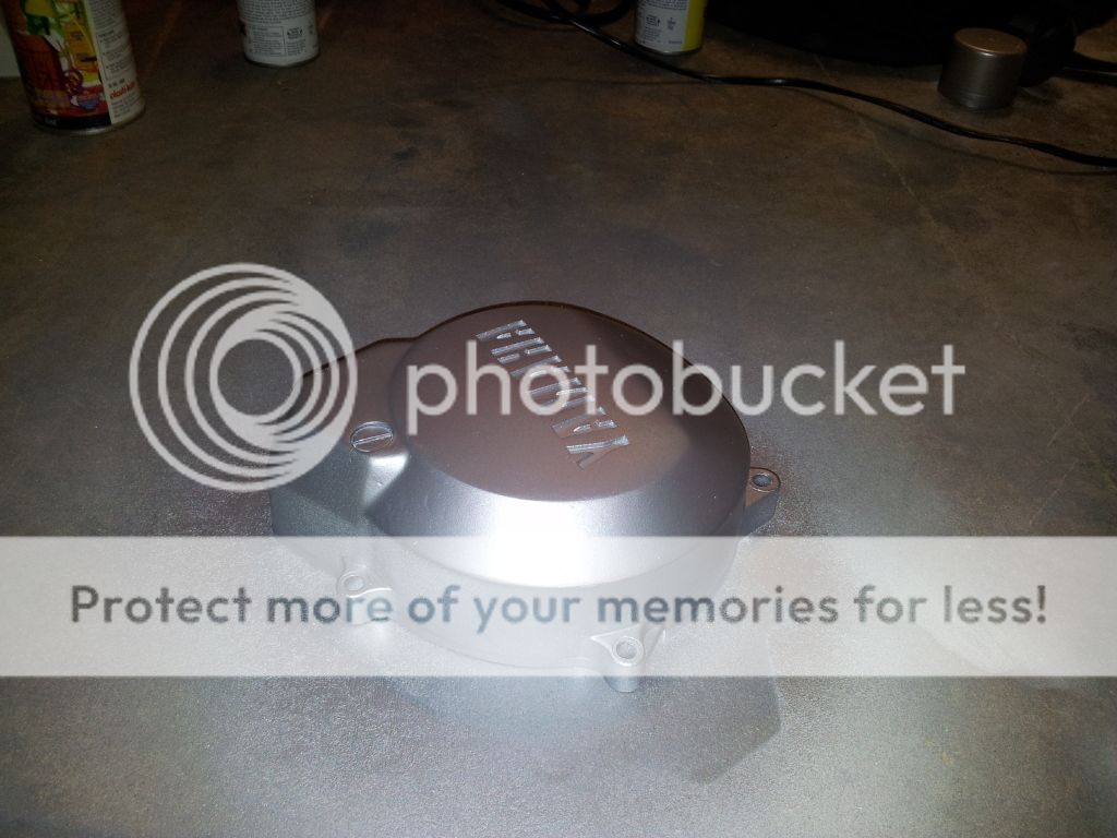

I then used about 2cm of a roll of epoxy metal putty to fill the low points and missing bits of the cover.
https://i878.photobucket.com/albums/ab349/slyrob/2012-06-15023636.jpg
more filing and sanding followed...
https://i878.photobucket.com/albums/ab349/slyrob/2012-06-15031656.jpg
then some more..
https://i878.photobucket.com/albums/ab349/slyrob/2012-06-15032640.jpg

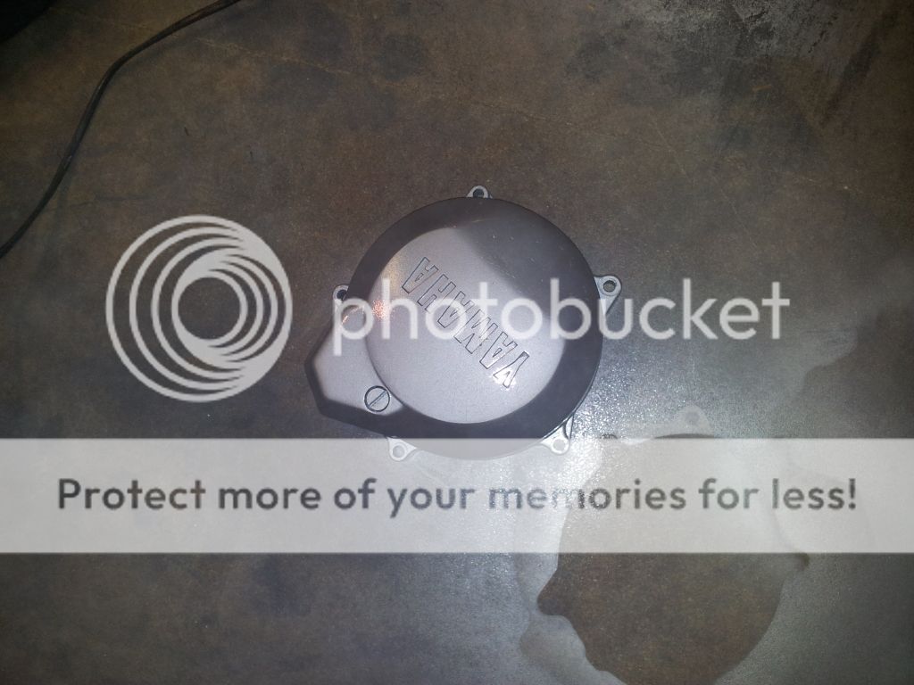

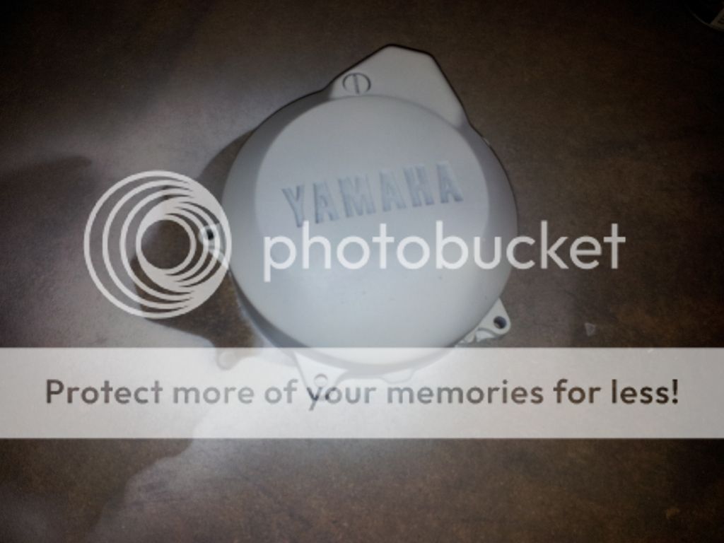

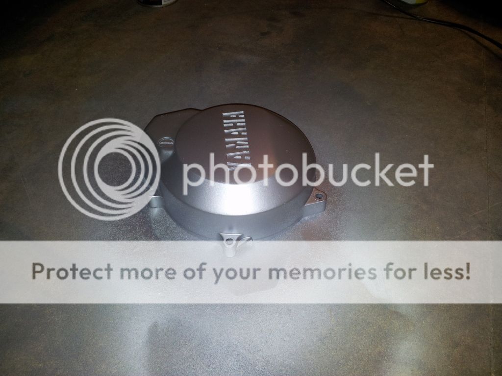

when I had sufficiently flatted it out and filed back in the original contours I used rattle can primer
https://i878.photobucket.com/albums/ab349/slyrob/2012-06-15040158.jpg
then silver stove paint
https://i878.photobucket.com/albums/ab349/slyrob/2012-06-15040443.jpg
https://i878.photobucket.com/albums/ab349/slyrob/2012-06-15040455.jpg
then enamel clear coat
https://i878.photobucket.com/albums/ab349/slyrob/2012-06-15042237.jpg
https://i878.photobucket.com/albums/ab349/slyrob/2012-06-15042254.jpg
The finish is reasonable considering I couldn't be arsed to sand between coats etc. but I shall be hopefully taking a more serious approach when I take on the bodywork.

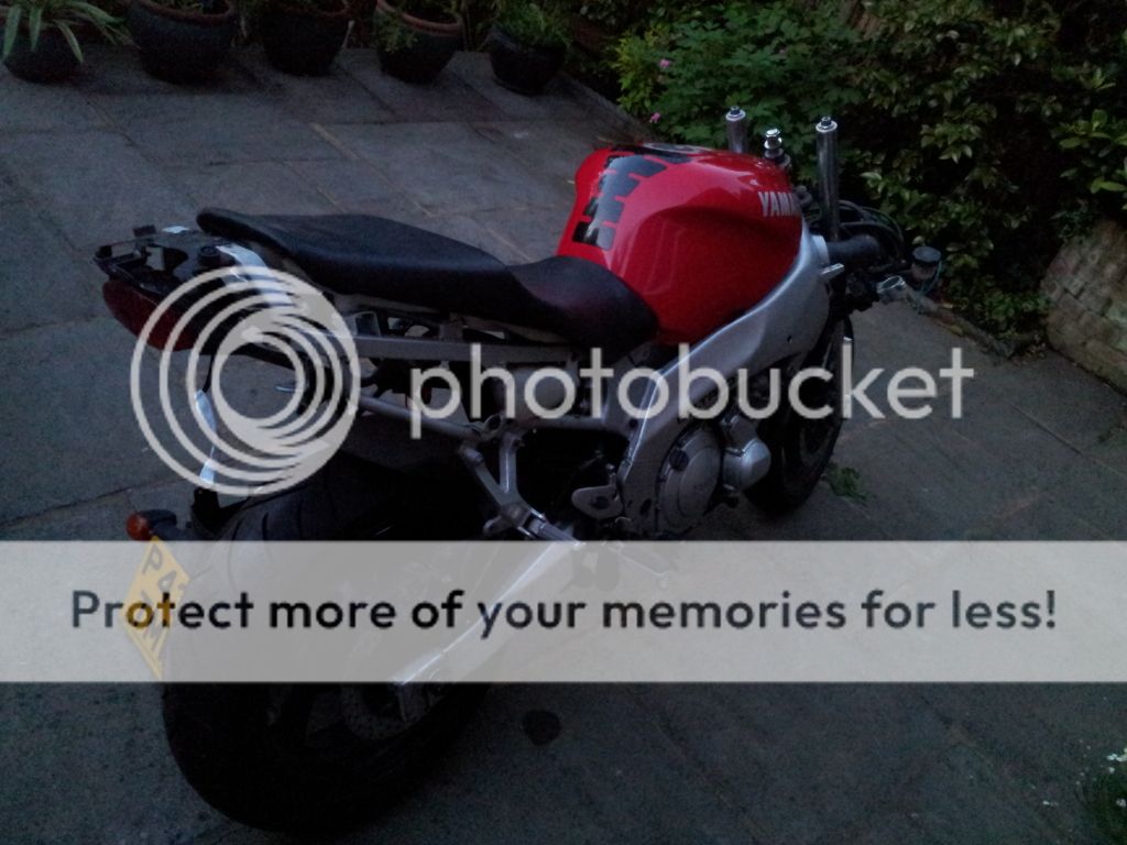

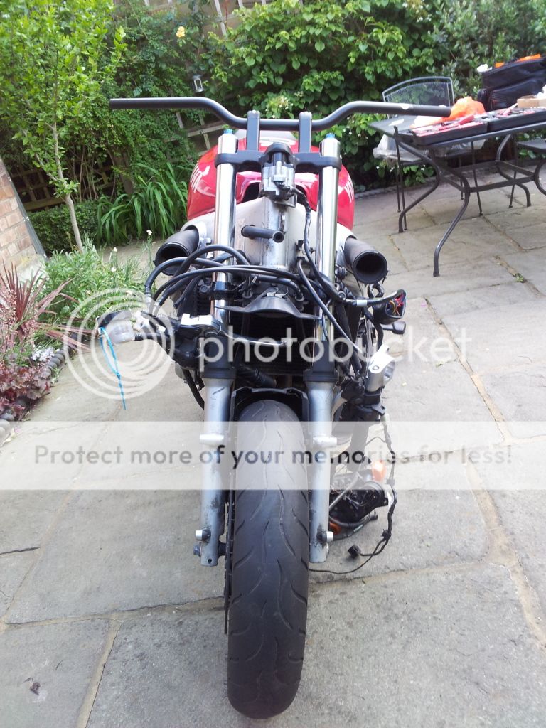

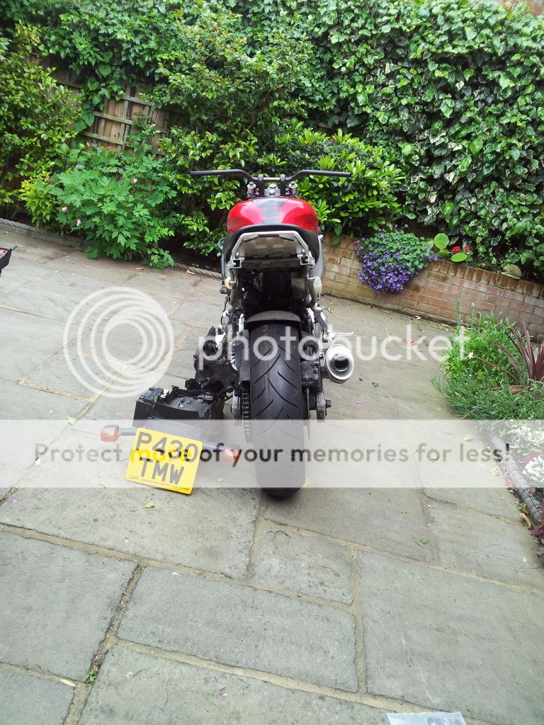

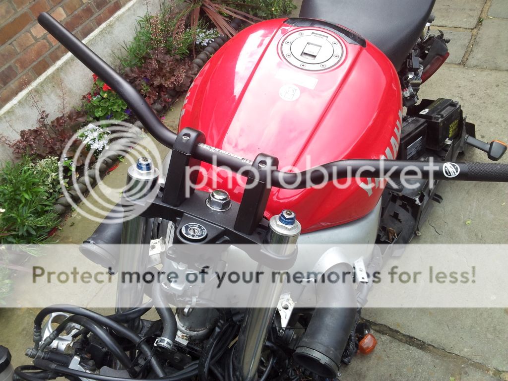

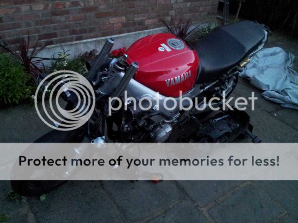

cheers, couldn't resist trial fitting the bars and exhaust
https://i878.photobucket.com/albums/ab349/slyrob/2012-06-16172122.jpg
https://i878.photobucket.com/albums/ab349/slyrob/2012-06-16172128.jpg
https://i878.photobucket.com/albums/ab349/slyrob/2012-06-16172438.jpg
https://i878.photobucket.com/albums/ab349/slyrob/2012-06-16174128.jpg
https://i878.photobucket.com/albums/ab349/slyrob/2012-06-16174140.jpg

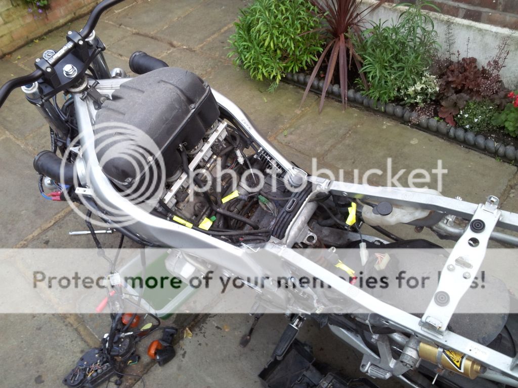

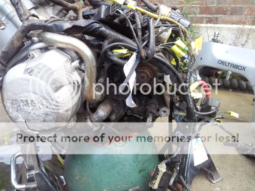

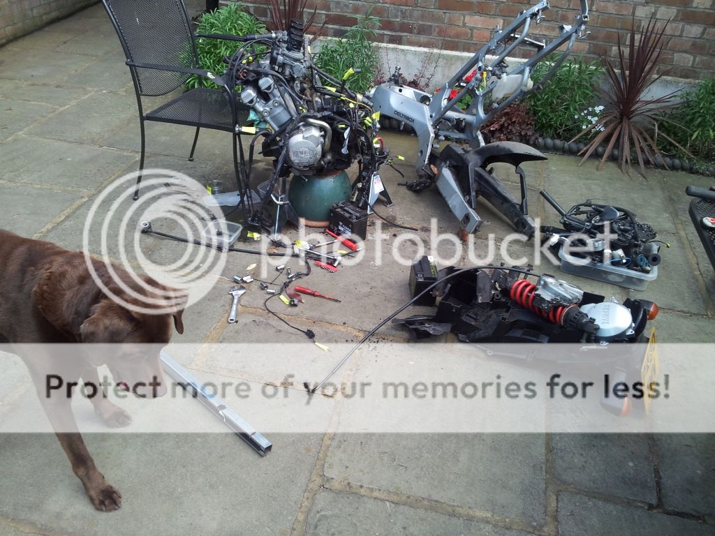

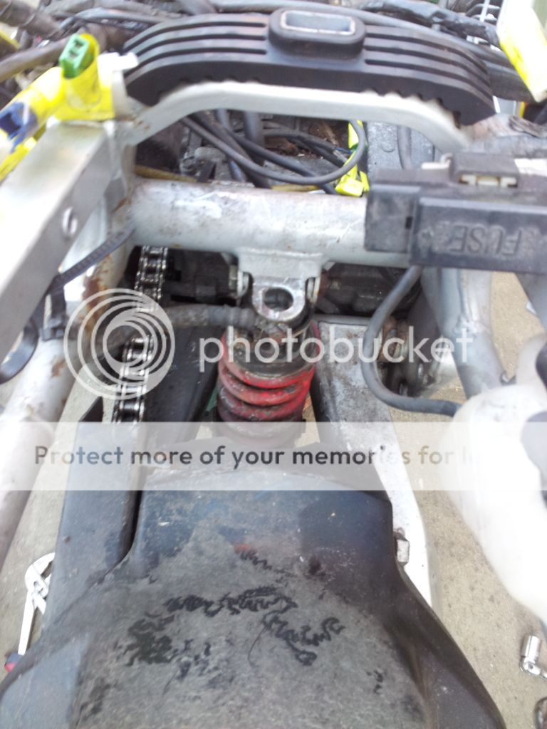

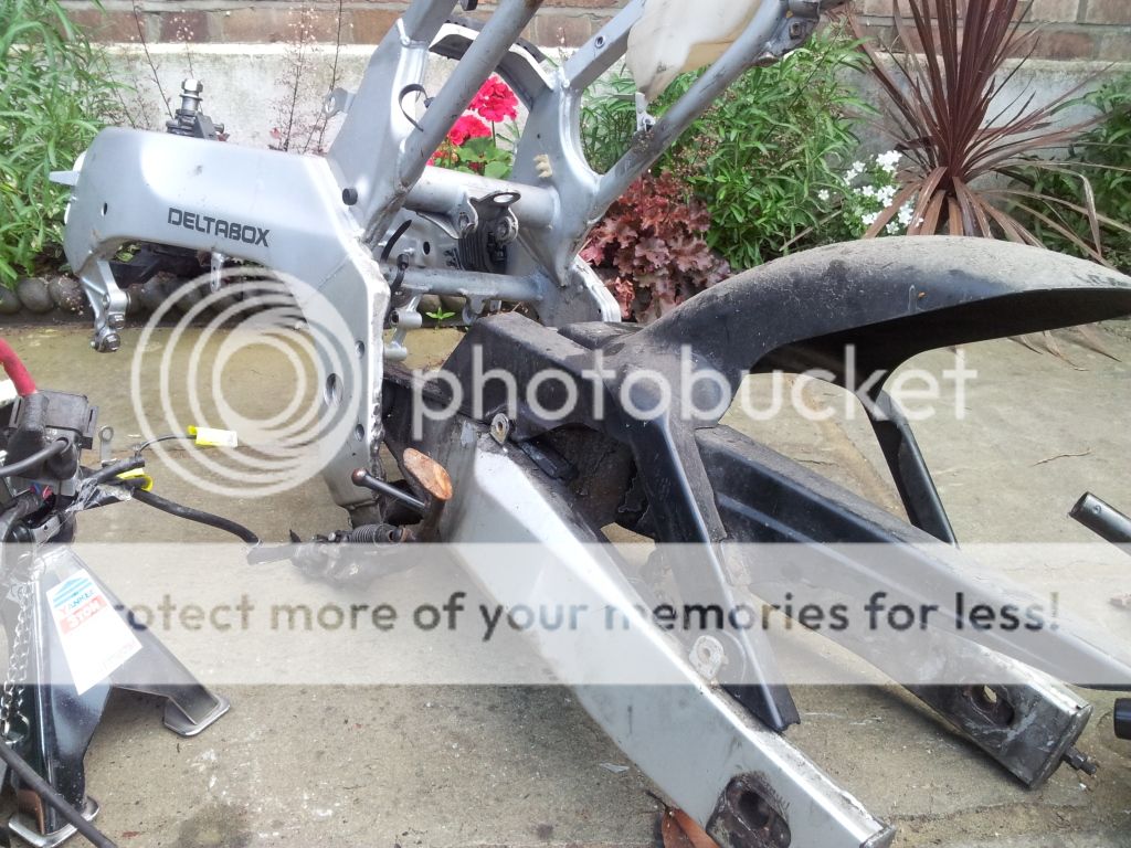

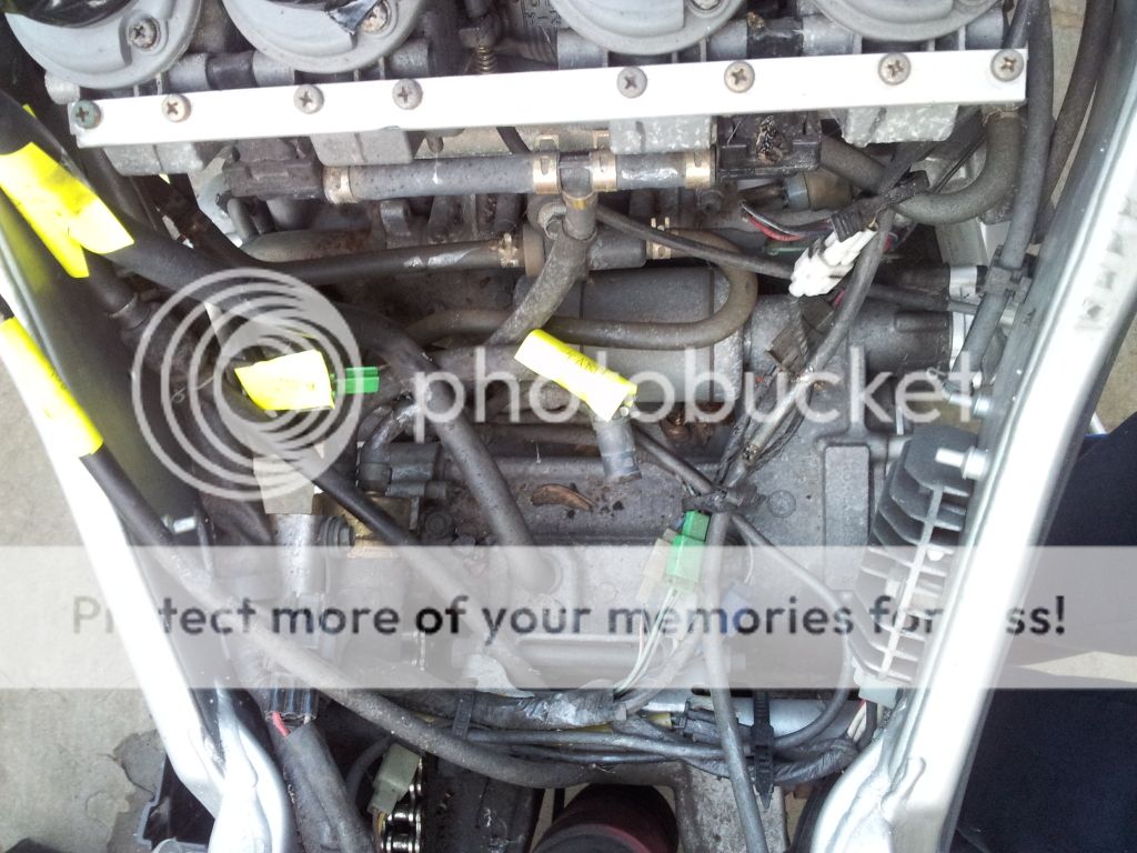

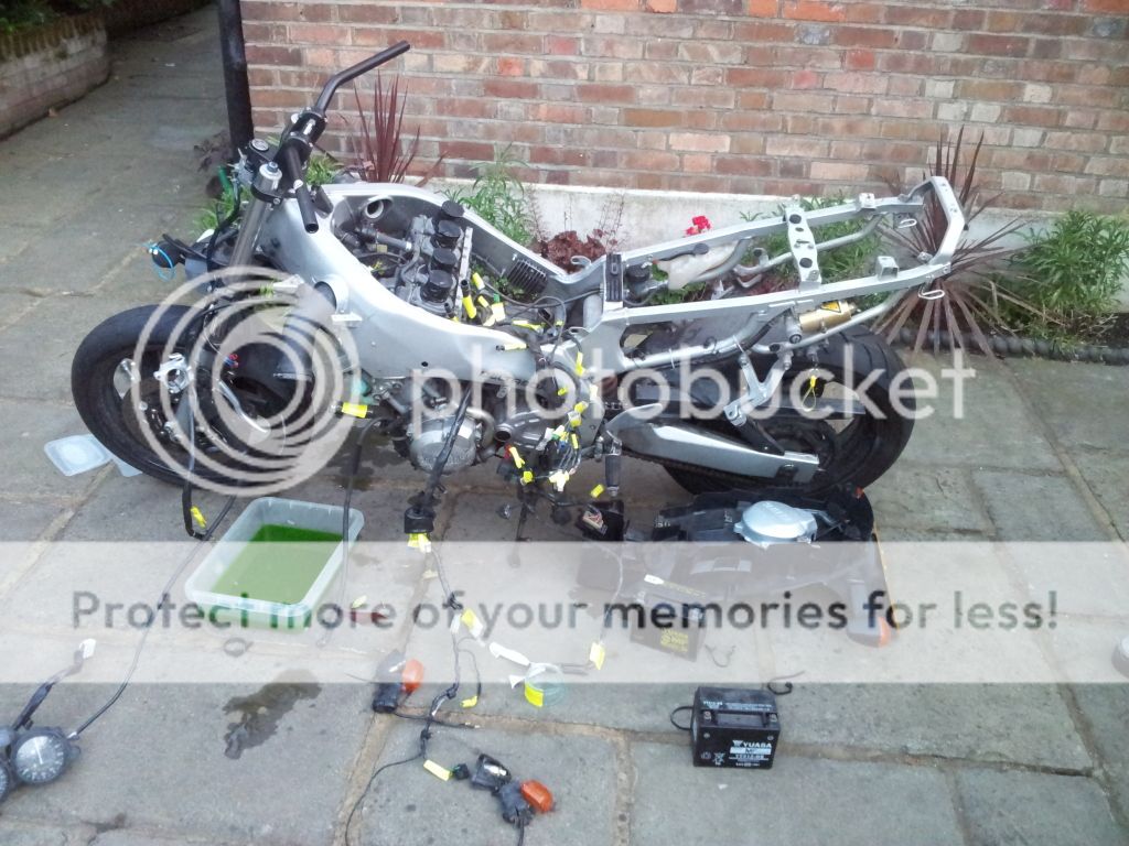

update.....

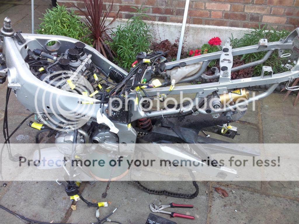

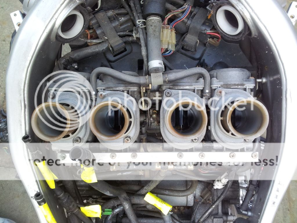

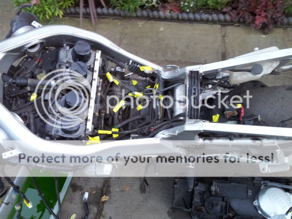

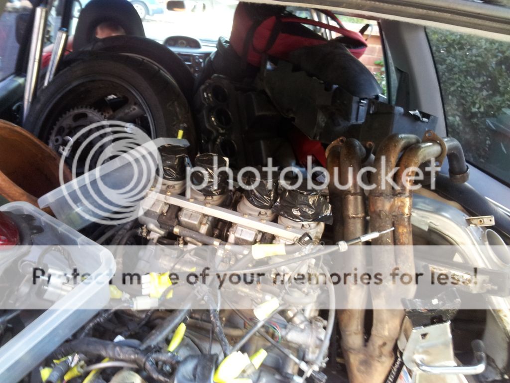

seeing as we were graced with an evenings worth of fine British summer yesterday I thought I would get off my arse and do something with the cat.
Having never stripped a big bike before I'm a little nervous so everything is being labelled and parts and bolts are going into pots with labels on so hopefully when it comes to putting it all back together again I may have a chance of doing it correctly.

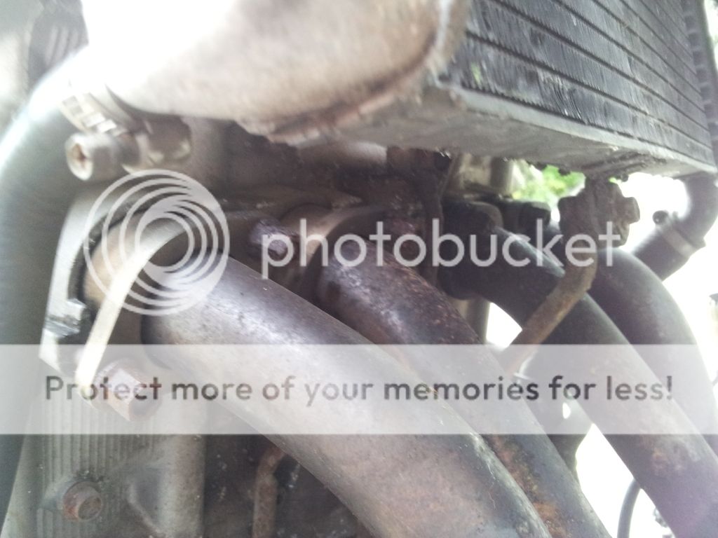

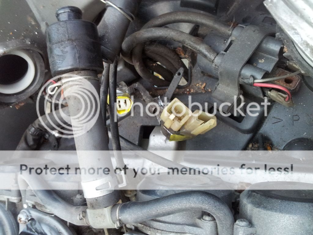

First issue was taking the headers off..
https://i878.photobucket.com/albums/ab349/slyrob/2012-07-15191926.jpg
nuts were rusted up a treat and two studs snapped during removal Sad
any advice regarding that situation welcome.
https://i878.photobucket.com/albums/ab349/slyrob/2012-07-15195427.jpg
https://i878.photobucket.com/albums/ab349/slyrob/2012-07-15200025.jpg
https://i878.photobucket.com/albums/ab349/slyrob/2012-07-15210952.jpg

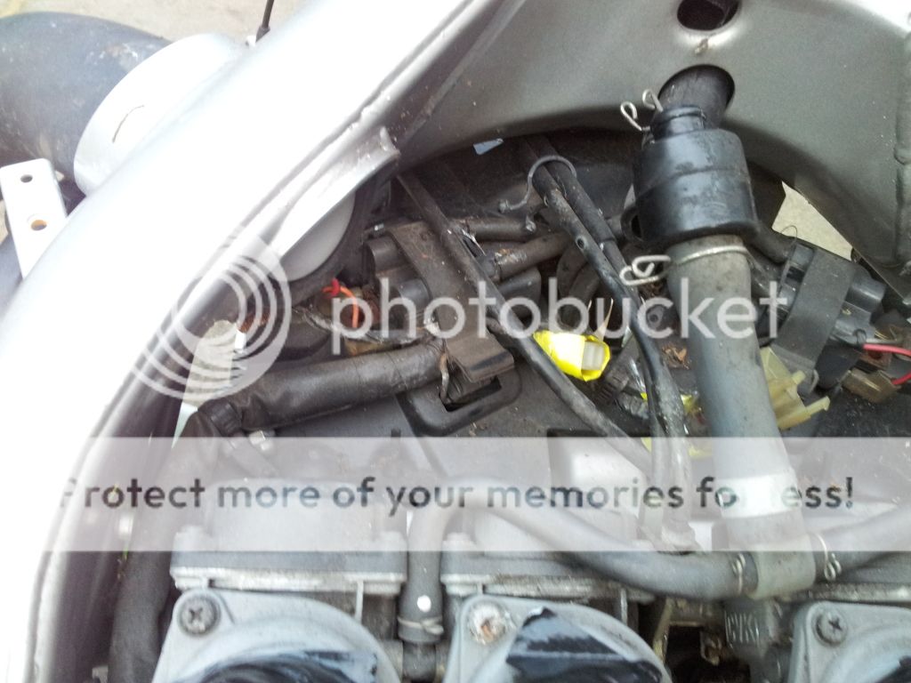

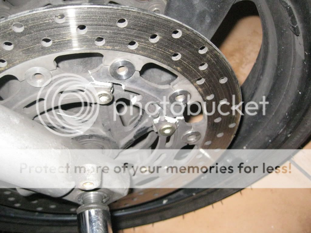

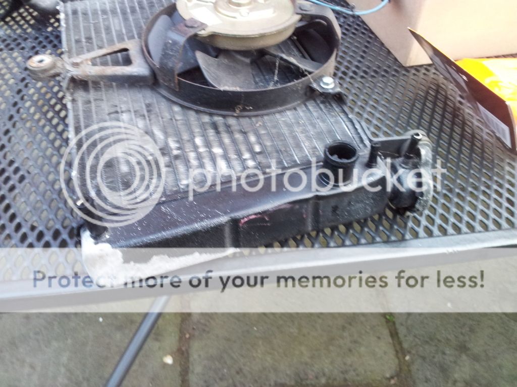

also noticed the radiator has a fair sized ding in it but no leaks
https://i878.photobucket.com/albums/ab349/slyrob/2012-07-15204007.jpg
https://i878.photobucket.com/albums/ab349/slyrob/2012-07-15204954.jpg
https://i878.photobucket.com/albums/ab349/slyrob/2012-07-15204958.jpg
https://i878.photobucket.com/albums/ab349/slyrob/2012-07-15205002.jpg
https://i878.photobucket.com/albums/ab349/slyrob/2012-07-15205238.jpg
https://i878.photobucket.com/albums/ab349/slyrob/2012-07-15210335.jpg

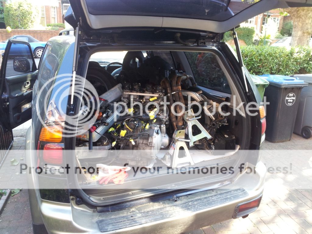

NEW PLAN..... as of today I have taken tenancy of a GARAGE
Dance!
so as the bike comes apart it will be transported in the car to its new safe haven where I can work in the dry at night with lights Mr. Green
also apologies for some of the more boring pics, its more reference material for me than anything

Hi with the broken studs are they sticking out far from the head? if so you could use a stud extractor to remove them but I would recommend that you lubricate and leave them for a few days while spraying them once in a while with WD40,plus gas or the stuff I generally use at work called rusty penetrant which is really good. Your cat looks really good naked like someone else said it reminds you of the speed four

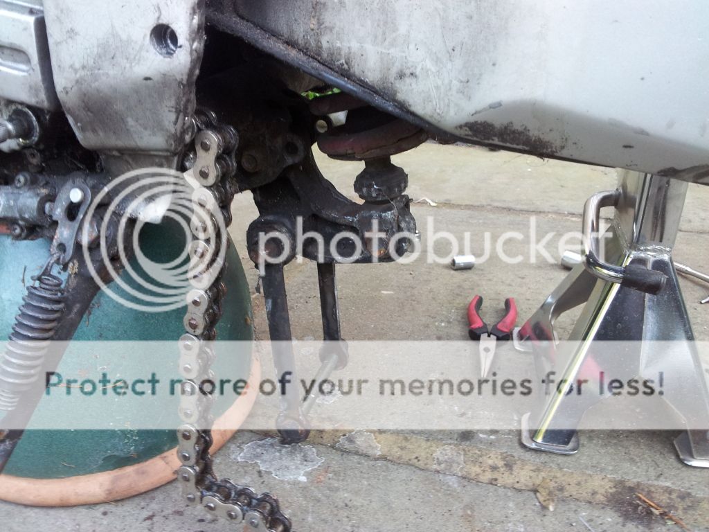

update:
surprisingly other than the header studs, everything else on the bike has come apart with no issues or damage Thumbs Up
handy plant pot was just the right height to support the bike along with axle stands for removing the front end and rear wheel, not sure how my mother in law will feel about this but its too late for regrets.
https://i878.photobucket.com/albums/ab349/slyrob/2012-07-22193122.jpg
swing arm pivot and links though looking a tad crusty came apart no hassles
https://i878.photobucket.com/albums/ab349/slyrob/2012-07-22193127.jpg
shock looks rough but will have to do until funds allow for an upgrade
https://i878.photobucket.com/albums/ab349/slyrob/2012-07-22193135.jpg

found out that I didn't have a 22mm socket so the frame and swing arm stayed together for a bit
https://i878.photobucket.com/albums/ab349/slyrob/2012-07-25172627.jpg
And although not as impressive as other 'bike in a car' images found on this site, I was still happy with the results!
https://i878.photobucket.com/albums/ab349/slyrob/2012-07-26171754.jpg
https://i878.photobucket.com/albums/ab349/slyrob/2012-07-26172541.jpg
and so the project moves to its new indoor home........
