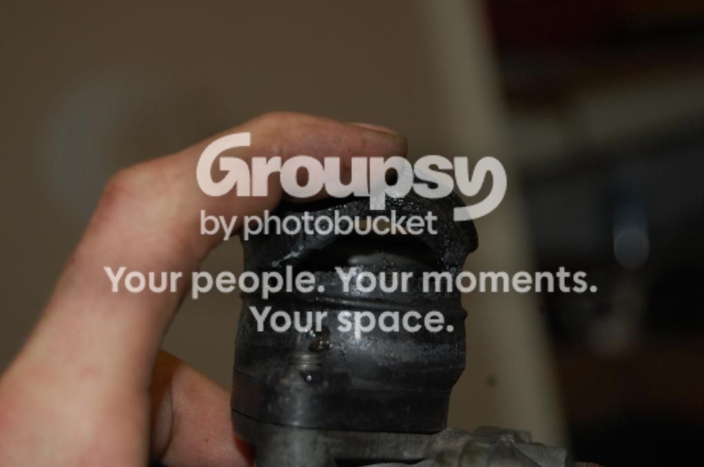

Just for a laugh, this is what im dealing with for carb rubbers, its been like this for 2000 miles, and i have to re repair it nearly every week now, its painfull starting it in a morning, but once its been repaired it does work for a while, then suddenly just opens right back up again lol
https://i1158.photobucket.com/albums/p615/supra3turbo/DSC_6674.jpg
I know all my problems stem from the exhaust and rubbers being fooked, but i also know that when i got it the rings and pistons looked ok, but as i said, one side the rings were seized in the piston, i freed them off and made do, but seeing as i have the money, thought id slap a new set in there, with nice fresh gaskets.
Another "problem" is the head gasket i bought last time required me to take some metal lugs out to fit it, it said so in the instructions, do i go for the same type of gasket, honda genuine i think it was Smile

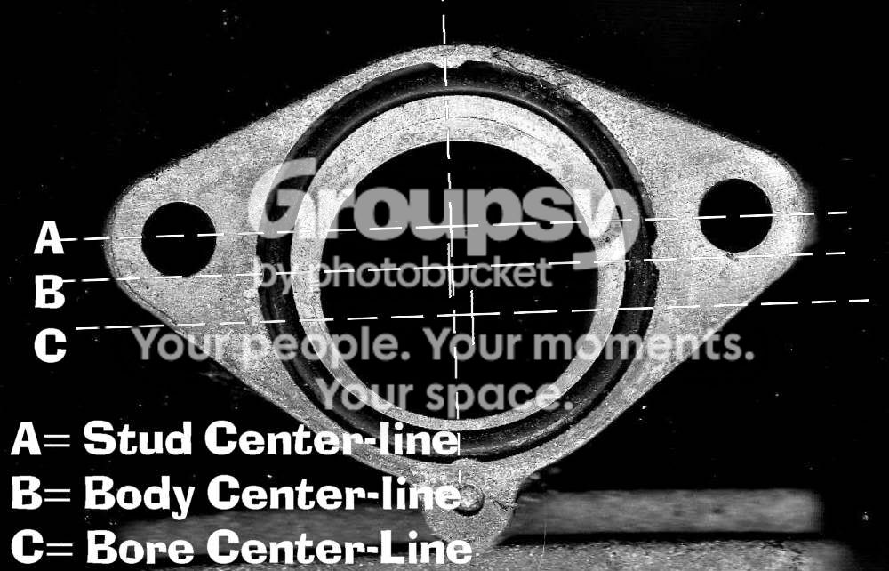

That's the bit your linked to.
https://i178.photobucket.com/albums/w269/teflons-torque/XX-Forum%20Posts/c-flang.jpg
This is the flange of the carb it has to bolt to.
Note that there are three non co-incident centre lines. The stud holes are off-set from the main body centre by about 6mm. The actual carb-bore (on PD24) is off-set about another 6mm beneath that.
This is the 'trouble'. There are many carb-manifolds out there, but the PD series all have this stud-flange off-set, so you have to look for rubbers that mount to Keihin's and the PD series specifically.
Then you have the niggle that on the CB you have two-banked carbs, and the carbs are attached to individual manifolds on two piece manfolds comprising, the isolation rubbers and inlket 'stubb'.
Most instalations bolt a single carb to a one piece inlet manifold.
Trouble here then is first he mounting angle; Super-Dream's carbs are angled quite significantly 'in' from the engine, even the earlier T-Shock's stubs aren't compatible, angling the carbs 'out'. Then there is the small difficulty of fitting them, one manifold will always mask access to the inner nuts to attach the other! And they will lack balence ports.
Maybe if enough of us get together we could find a rubber moulding Co to make a batch of replacements?!?
