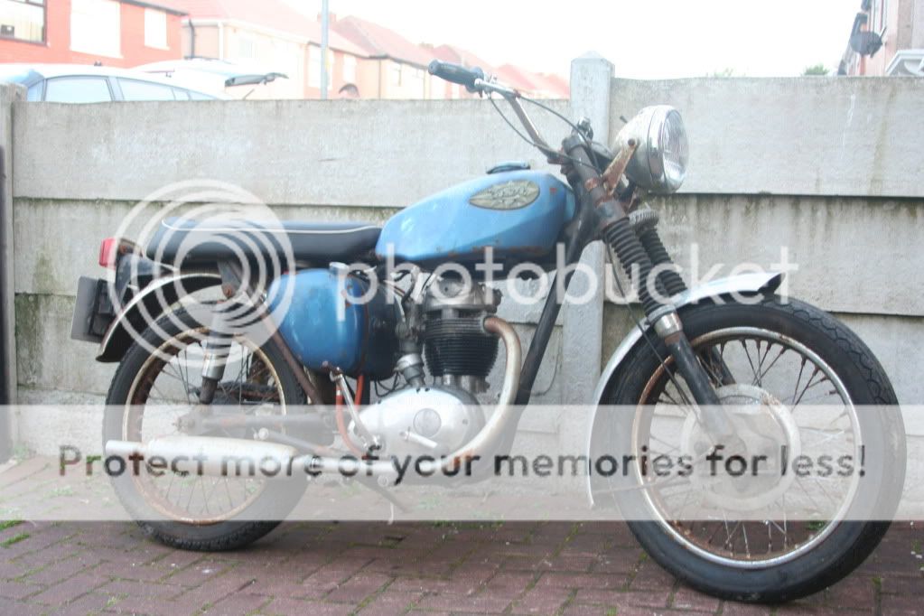

Well, went to see a lady about this bike she had in her back yard for a number of years, she didnt know alot, she said "its a bsa, and its rusty"
Sadly it wasnt a goldstar, i half expected it to be a bantam, but instead it was a 1963 bsa b40 (350)
Alot of it isnt original, the tanks from a b25 Starfire, its got different headlight, tail light and mudguards on it, so im not sure what to do with it yet, any ideas?
Also, wheels are shot, i either need replacement rim/spokes, or get one from another model ect.
cleaned out the carb and managed to get it to fire and kick flames everywere, so its a start!
Any ideas, or were to source parts from would be great!

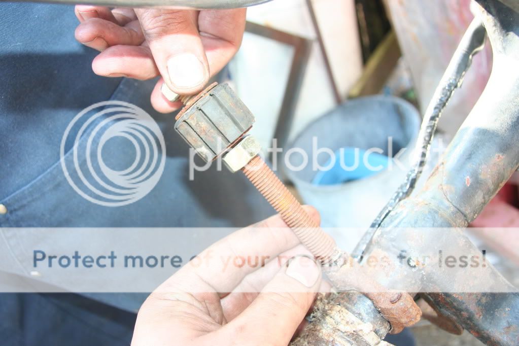

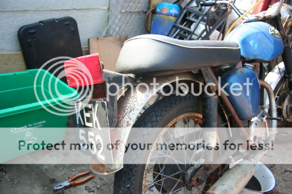

Time for abit of an update!

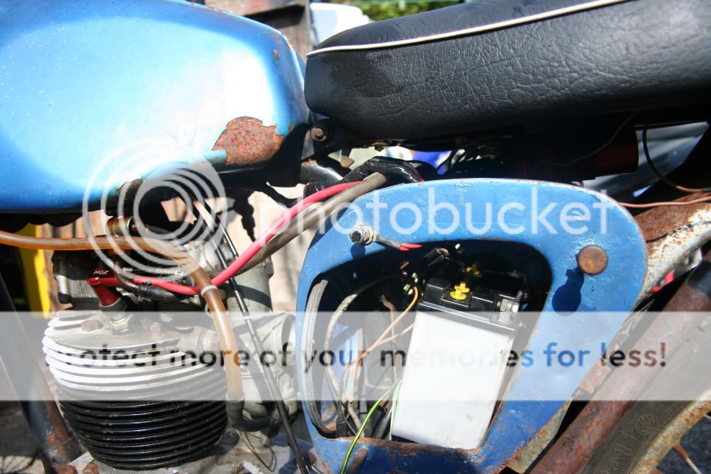

Managed to get it running today, started first kick after mucking out the clutch, carb and setting the timing, theres abit of a "knock" when you lean it over, and theres some play in the layshaft, so that will have to be sorted!
Some pretty Orrible wiring!

none original rear light/mud guard
https://i48.photobucket.com/albums/f215/stesewell/1963%20bsa%20b40%20project/2.jpg

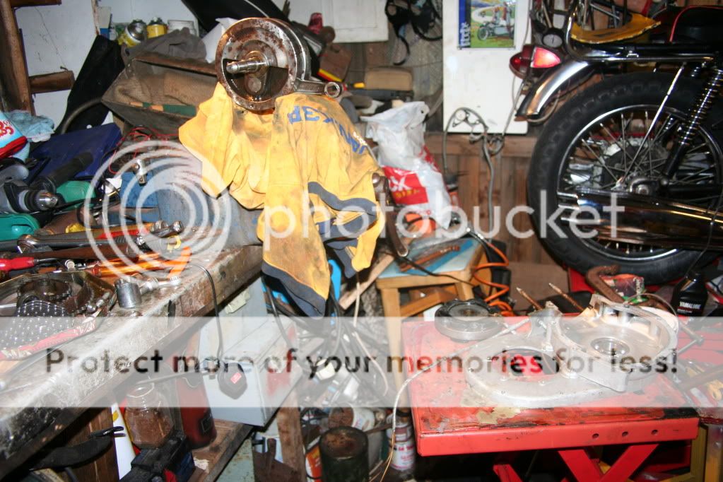

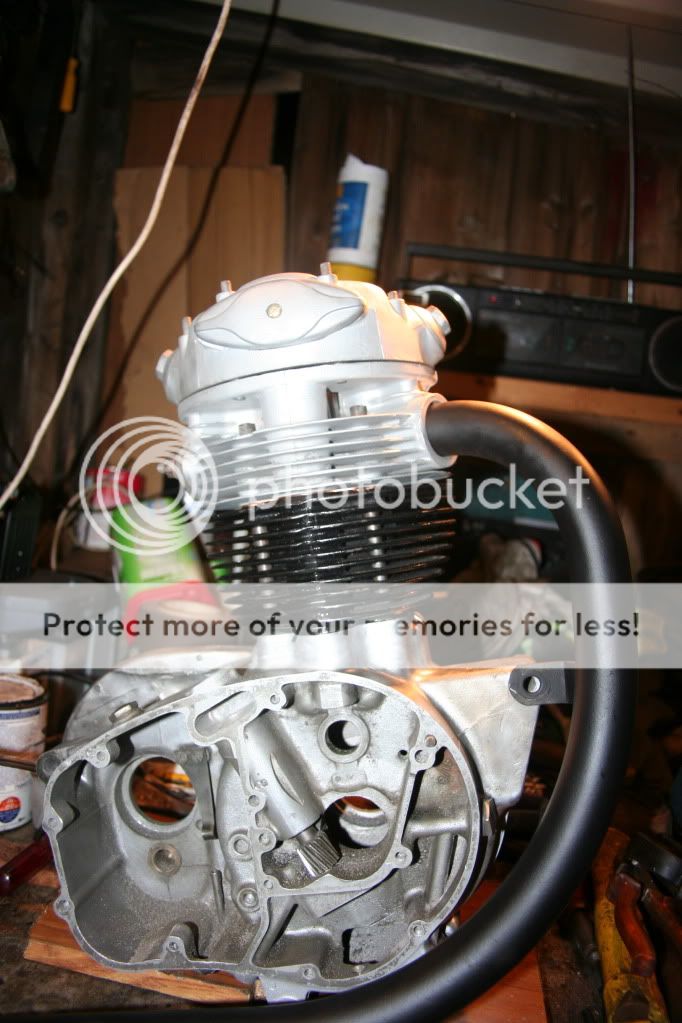

motor out, looking less like a bike now!
https://i48.photobucket.com/albums/f215/stesewell/1963%20bsa%20b40%20project/4.jpg

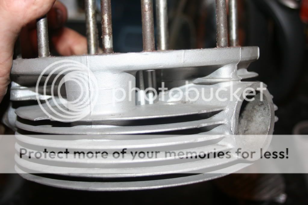

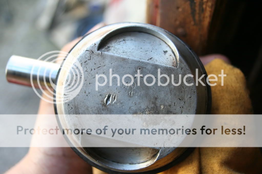

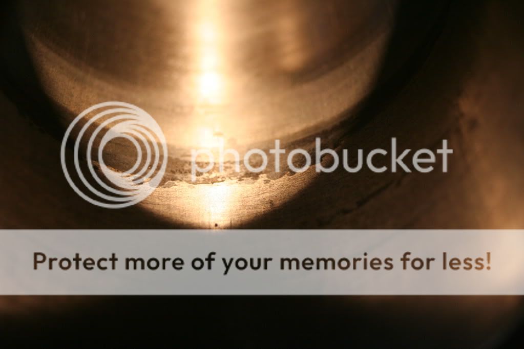

after stripping the motor, theres abit of damage to the bore, im guessing its were its been stood and corroded away.
https://i48.photobucket.com/albums/f215/stesewell/1963%20bsa%20b40%20project/5.jpg

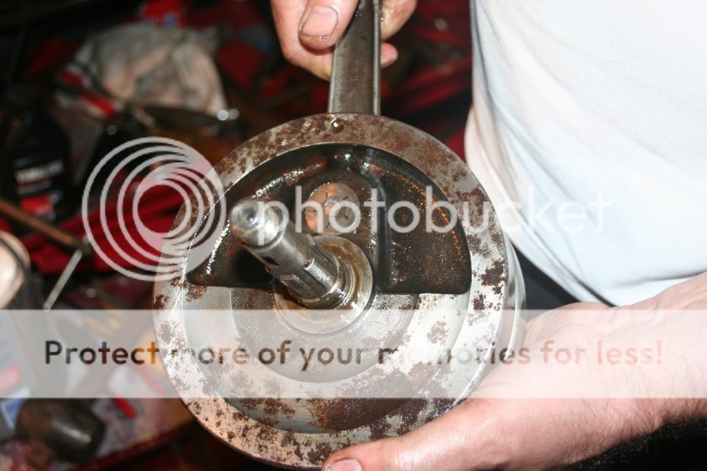

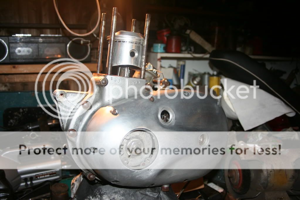

seems the pistons 40thou over size too.
https://i48.photobucket.com/albums/f215/stesewell/1963%20bsa%20b40%20project/6.jpg

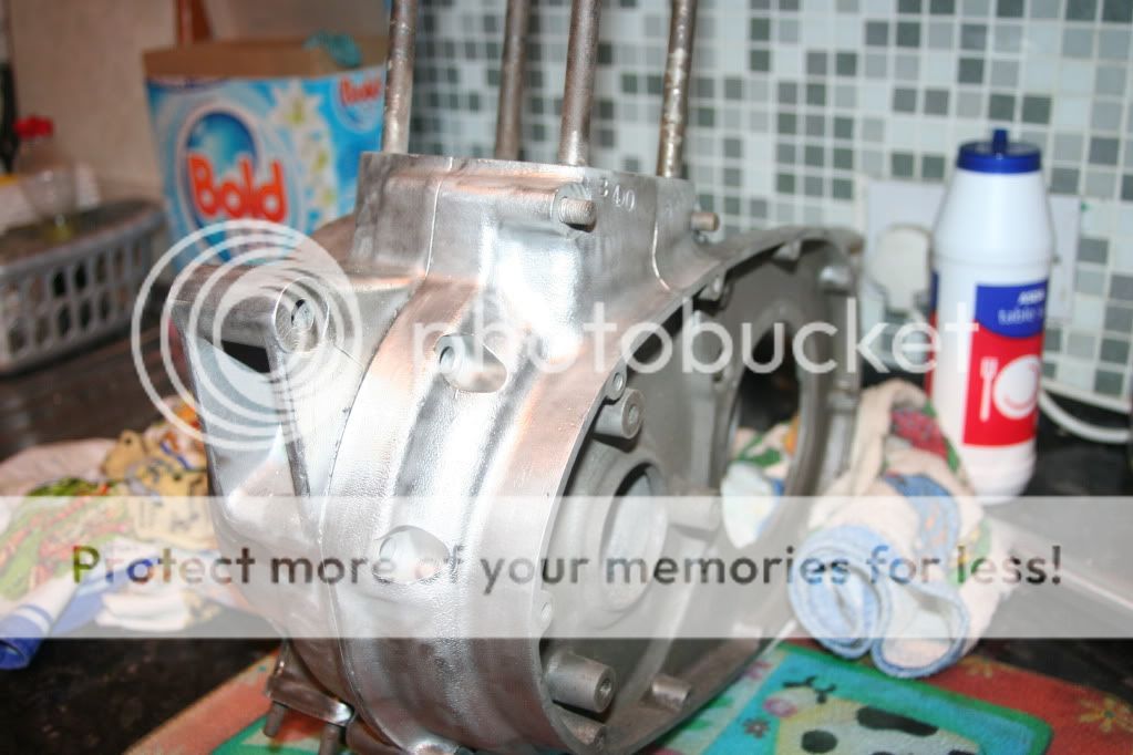

started to clean it up, further strip down tomorow!
https://i48.photobucket.com/albums/f215/stesewell/1963%20bsa%20b40%20project/7.jpg

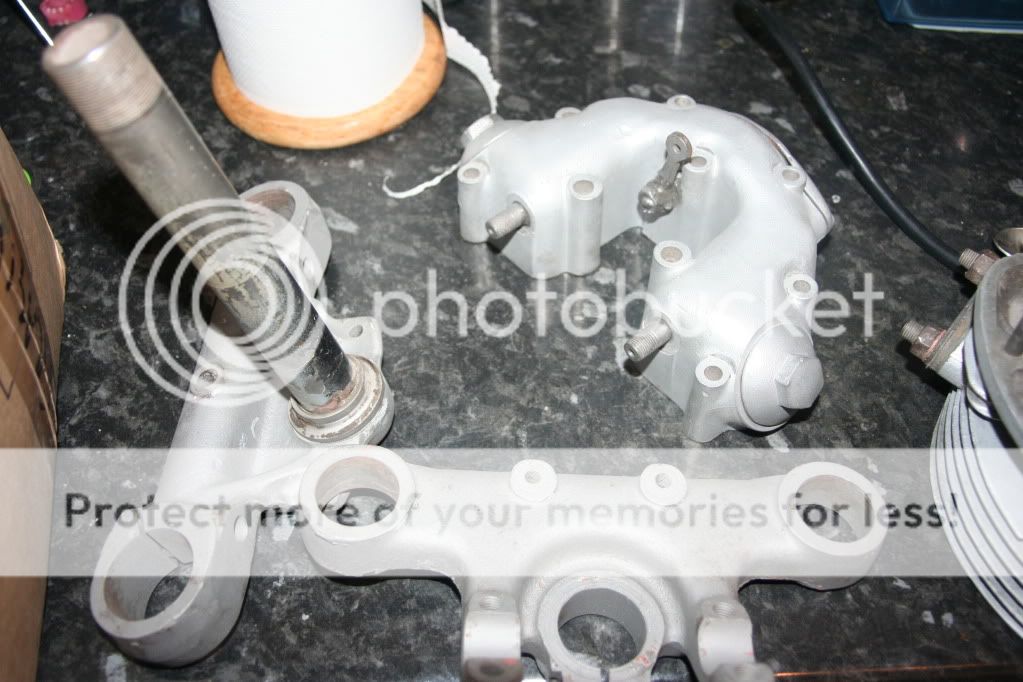

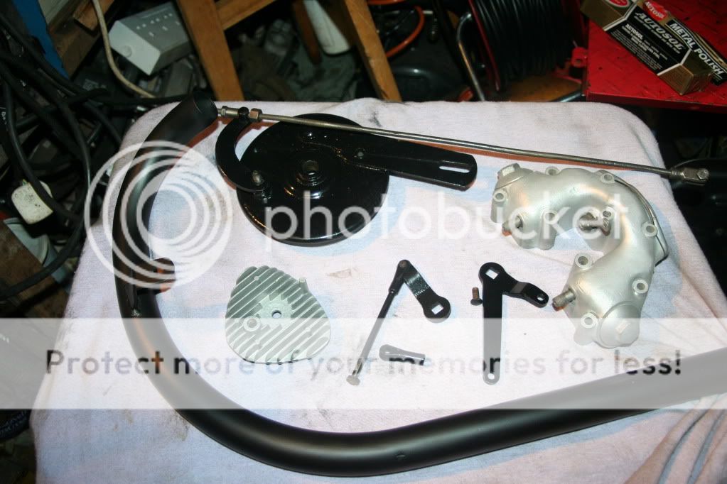

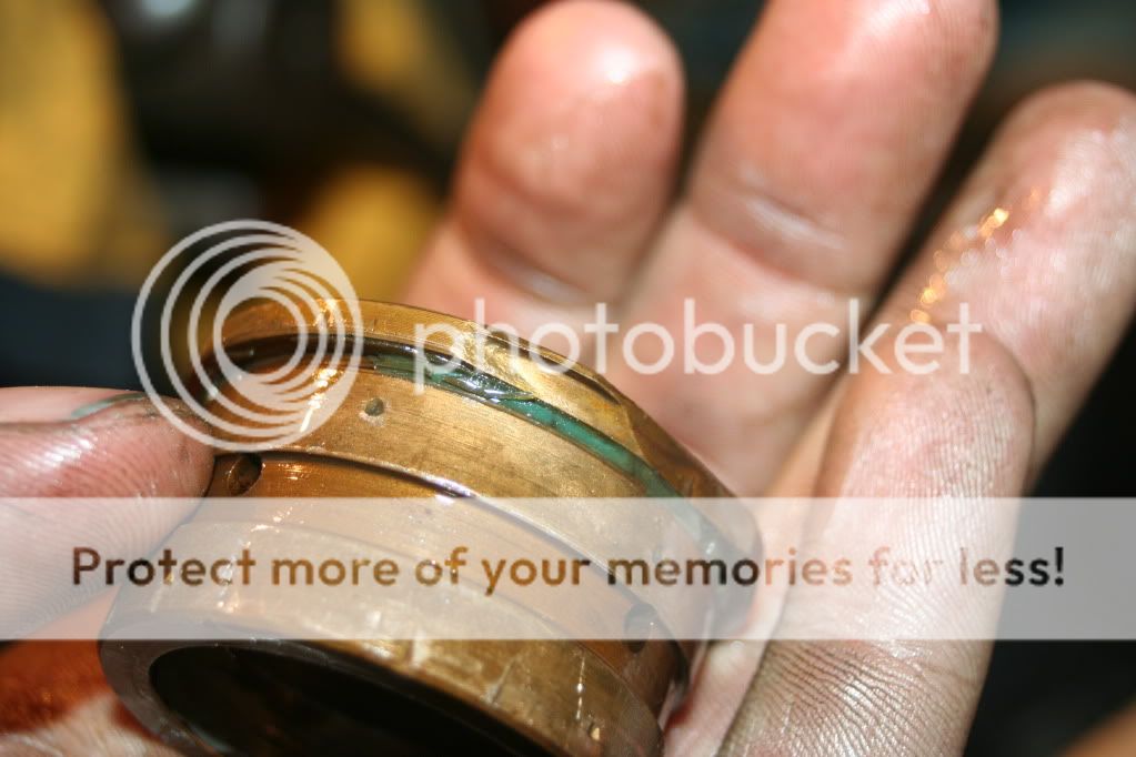

Got the motor fully stripped down now, with abit of a list of what i need, as i thought the bronze crank bush is completley shot, it looks like its picked up on the crank and spun round, its marked the castings, so im not sure what im going to do with it yet, ive heard rumours that you can get roller bearings to fit, ill have to dig around!
heres some pictures!
the Bronze bush, that supposed to stay in the crankcase!
https://i48.photobucket.com/albums/f215/stesewell/4a.jpg
The nurled up bush, its even got pop marks were someones tried to make it stay in the casings... sigh.
https://i48.photobucket.com/albums/f215/stesewell/a3.jpg
luckily theres no play in the crank, but its abit rotten.
https://i48.photobucket.com/albums/f215/stesewell/a2.jpg
and a random shot.
https://i48.photobucket.com/albums/f215/stesewell/a1.jpg
so whoever built this last clearly had no idea! now its time to start hunting for motor spares, going to rebore the barrel at work, so im going to be after a 80.5mm piston for it, not sure whats going to be the best place to be honest, if anyone knows of a company that might be able to help it would be much apprechiated.

Well, time for an update, not too much really, few new bearings and bushes arrived recently, got the frame, motor and few other bits bead blasted on my day off.
https://i48.photobucket.com/albums/f215/stesewell/1963%20bsa%20b40%20project/IMG_0331.jpg
created myself abit more work cleaning the shit out,but its worth it imo
https://i48.photobucket.com/albums/f215/stesewell/1963%20bsa%20b40%20project/IMG_0333.jpg
https://i48.photobucket.com/albums/f215/stesewell/1963%20bsa%20b40%20project/IMG_0336.jpg
head
https://i48.photobucket.com/albums/f215/stesewell/1963%20bsa%20b40%20project/IMG_0328.jpg
And i couldnt resist putting it together to see what it looks like!
https://i48.photobucket.com/albums/f215/stesewell/1963%20bsa%20b40%20project/IMG_0342.jpg
I will be assembling the motor next, ive just finished porting the head a little, lapping in the vavles, and fitting a 60thou over sized piston to get read of a horrible rust mark in the barrel.
Oh, and i intend on taking it with me to barbon hill climb this year for a little bit of a giggle Very Happy
