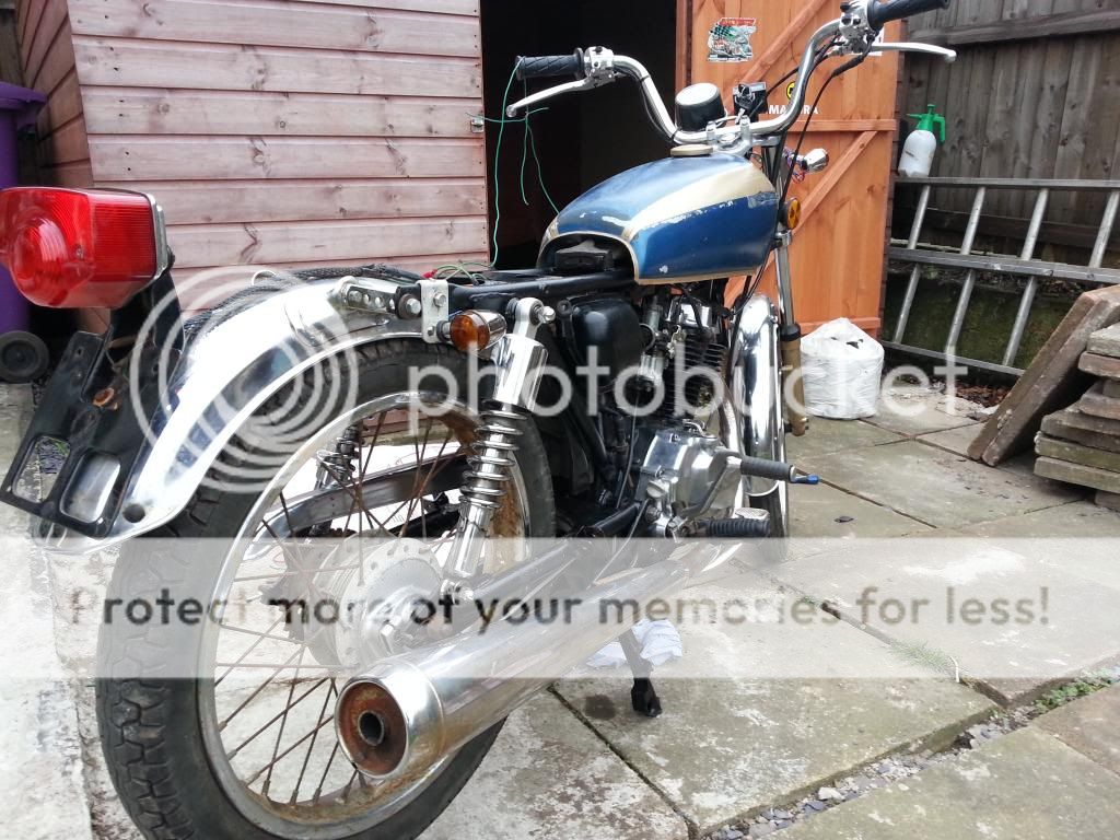

she is still in a bit of a mess.....
https://i25.photobucket.com/albums/c81/mudcow007/20130303_154741_zpsb3bd5b1c.jpg
toppetsaha
Joined: 07 Jul 2012
PostPosted: 22:43 - 04 Mar 2013    Post subject: Reply with quote
ooohhhh .... stick a set of flat handlebars on that Thumbs Up
