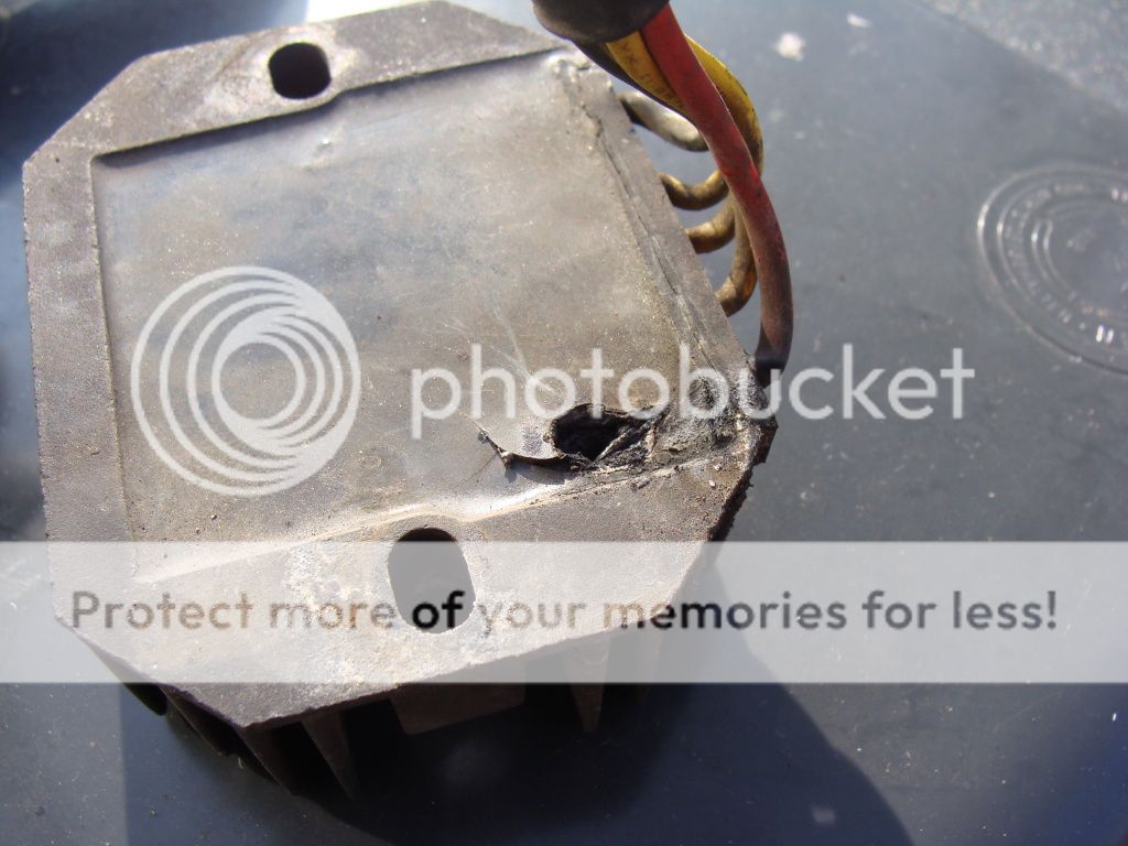

PostPosted: 19:51 - 03 Apr 2013    Post subject: Reply with quote
With the car running, the alternator is forcing amps into the batteries. Cars run higher ampereage than bikes and so the bike battery and reg/rec cant handle what's being pumped into by the car. I fried a battery/reg/rec doing this.
With the car off the bike merely draws all it needs from the car battery.
It's the difference between drinking from a fire hose and a normal drinking straw.

PostPosted: 23:57 - 03 Apr 2013    Post subject: Reply with quote
https://i1247.photobucket.com/albums/gg630/haroman6661/DSC05723.jpg
This is what happens when you jump from a running car.
