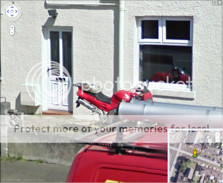

Put the footpegs on upside down.
Stick an axle stand under one. Push the bike over onto it, put the other stand under the other.
Support whichever end drops down with a car jack.
Here's my VFR750 on google earth putting my money where my mouth is:
https://i48.photobucket.com/albums/f216/stinkwheel/street1.png
Thanks stinkers. I've got the coordinates for your hoose. The bears will be round with a van at the weekend. Thumbs Up
Any Real Reason on why to put them upside down Question
Whenever I have to lift up the CG (Ok it is light) I just shove one under the right or where it would go and then the other by the sidestand. Push the bike to the right and push the other jack under the footrest after lifting up sidestand with my foot.
Never had any problems doing it that way.

Front pegs are hinged to allow them to scrape on the ground and not upset the bike. Smaller bikes only have a solid bar running through so no need to turn.

Ah makes a lot of sense, thanks for explaining that Thumbs Up

Stinkwheel's Idea is a good un Thumbs Up
