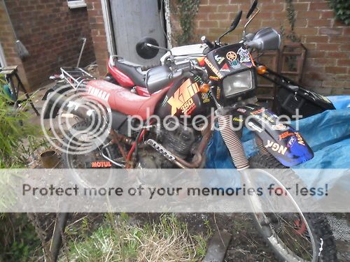

I’ve been wanting to get into muddy riding for ages, and I’ve been looking for a bike in budget for quite some time. Unfortunately I think I got overexited and climaxed prematurely.
Last weekend I went to view this heap
https://i35.photobucket.com/albums/d170/tristanthe/xt.jpg
1988 XT350
Beforehand I had priced up every consumable and was confident that even if I replaced all of them I could still have a decent green laner for a decent price, so when I viewed it my main concern was checking the frame was solid not rusted through, which it is, just covered in surface rust. Knocked a few quid off as the rear rim had aids
https://i35.photobucket.com/albums/d170/tristanthe/Snapbucket/B8DAC442.jpg
And the oil stinks of petrol.
Anyway money changed hands and the exty slipped into something a little more comfortable.

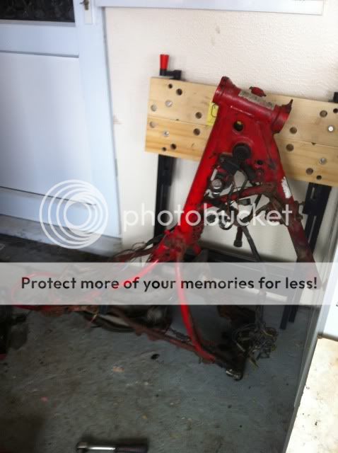

All going quite well. No major issues and a few nice surprises – frame is fine in the covered areas and the steering head bearings are very new, Next I found this travesty
https://i35.photobucket.com/albums/d170/tristanthe/Snapbucket/A7987E33.jpg
footpeg hanger is welded to the frame (brake lever is attached to the back of it, swingarm spindle is behind it and passes through the engine) so it needed to be removed. After asking for advice in the workshop I decided to try and chop it off, but first I would remove the top half so I could remove the swingarm, engine etc, to make it easier to turn the frame over and mitigate the chances of catching anything expensive.
https://i35.photobucket.com/albums/d170/tristanthe/Snapbucket/66EE56F2.jpg
That’s pretty much the last thing you want to be doing to a bike you bought 2 days ago.

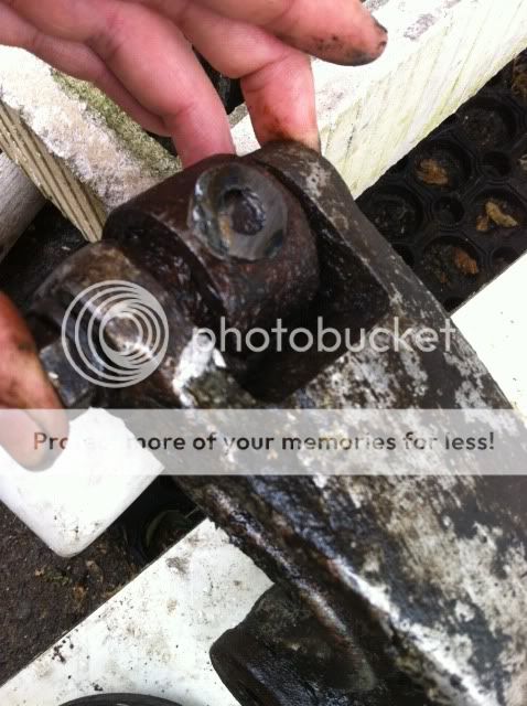

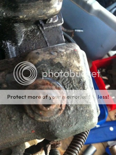

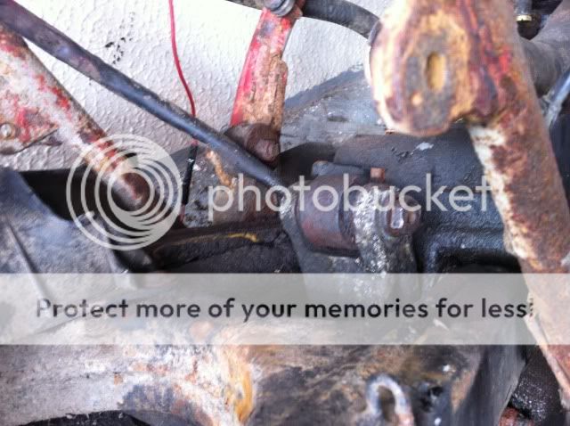

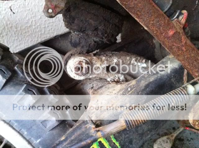

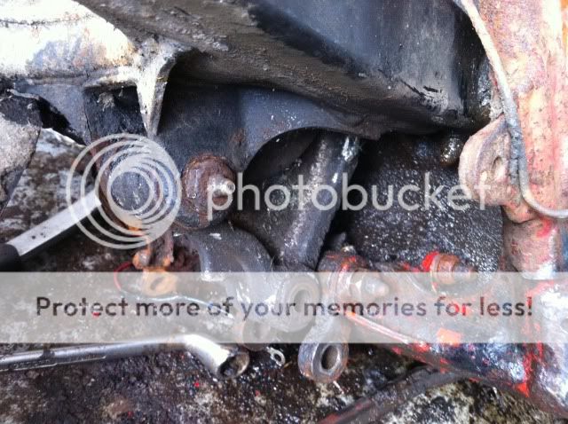

The swingarm pivot bolt and the 3 linkage bolts are completely seized in their bearings
https://i35.photobucket.com/albums/d170/tristanthe/Snapbucket/77D67CFD.jpg
https://i35.photobucket.com/albums/d170/tristanthe/Snapbucket/B72FFB1B.jpg
https://i35.photobucket.com/albums/d170/tristanthe/Snapbucket/2FC12BB9.jpg

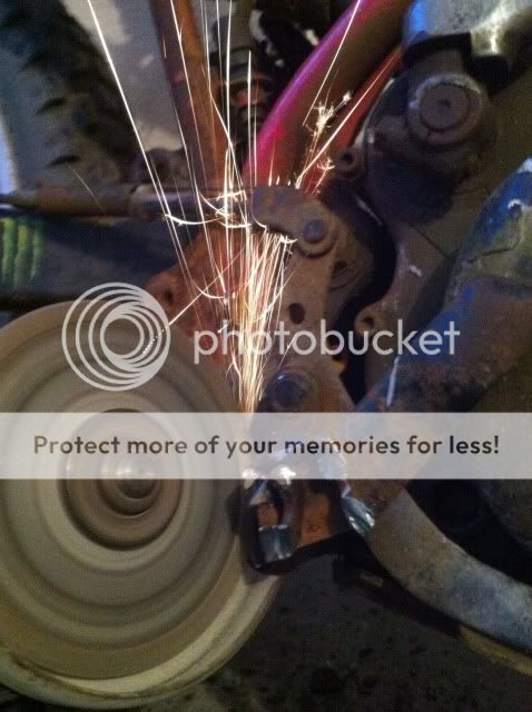

Given how fucked the shock was I just chopped through it to get a bit more access
I’ve managed to get the swingarm pivot bolt to rotate, initially with a fucking big breaker bar, but now it’ll turn with my crappy impact gun, but only for 10s at a time before my teeny compressor runs out of puff, so I’ve ordered an electric impact gun which should be able to handle spinning it constantly. I’ve also been soaking it in plusgas constantly, so current plan is to get it spinning constantly, then tap it and maybe apply heat to the swingarm. If that doesn’t work the angle grinder comes out again and I’ll butcher the swingarm, replacements are fairly cheap.

However, I can't see why it can't be sorted if you spend enough time on it. The best way to get through them shock linkages free is by cutting it off on both sides with a hacksaw. Once free knock out the collars, remove dust seals and then using a similar sized socket and hammer, knock out the bearings. If you take them to a local bearing shop it shouldn't cost to much to get replacements.
You'll probably find with the swingarm that its the bolt seized to collars so you can turn the bolt as the collars move in the rusty bearings but obviously can't remove the bolt, what you need for that is lot and lots of HEAT. Put the nut back on the spindle if you want to protect it and then hit away with a BIG hammer.

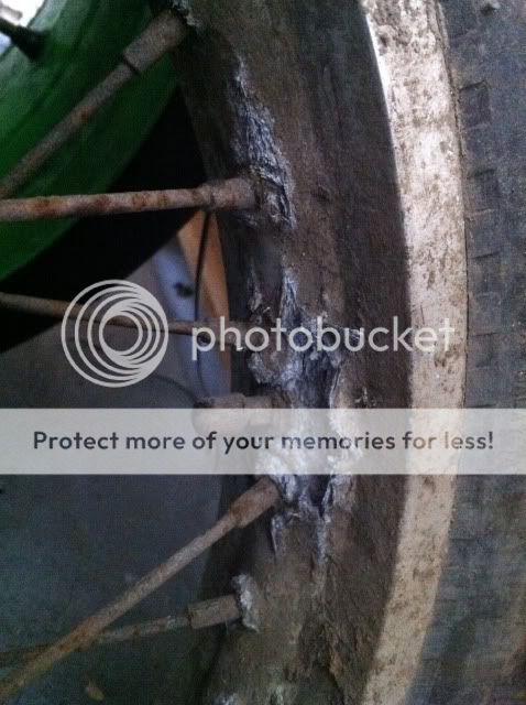

Is the engine at least a good runner or does it have the aids also? Razz The back wheel is interesting, never seen that sort of damage before.

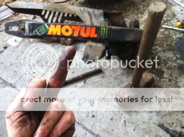

PostPosted: 18:13 - 30 Mar 2013    Post subject: Reply with quote

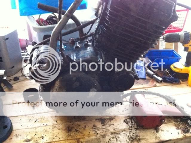

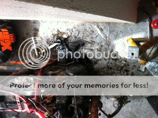

https://i35.photobucket.com/albums/d170/tristanthe/Snapbucket/9C1D154C.jpg
Fuck you swingarm spindle
many many many hours to get that out, then ten minutes to get the engine out
https://i35.photobucket.com/albums/d170/tristanthe/Snapbucket/BC500BA9.jpg
https://i35.photobucket.com/albums/d170/tristanthe/Snapbucket/374E44B9.jpg
(rear mudguard captive nuts are spinning so they'll get drilled out later)

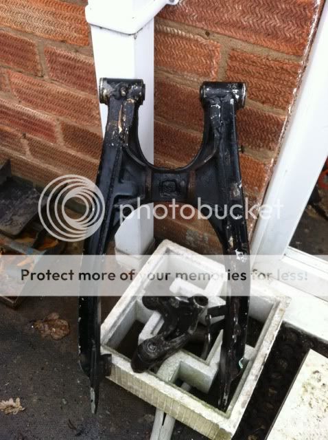

also cleaned up the swingarm, which is in decent nick, I expected terminal rust holes
although the linkage has more aluminium aids
https://i35.photobucket.com/albums/d170/tristanthe/Snapbucket/934905BC.jpg
I'll keep an eye out for a new one.

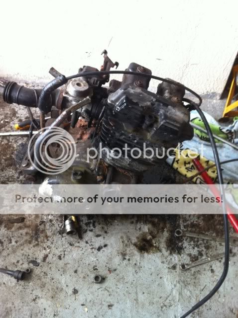

Next step is to see what kind of derpgasm the engine's had. As I mentioned the oil stinks of petrol so I'm expecting rings aren't sealing at the least. Plus there's the oil leak.
