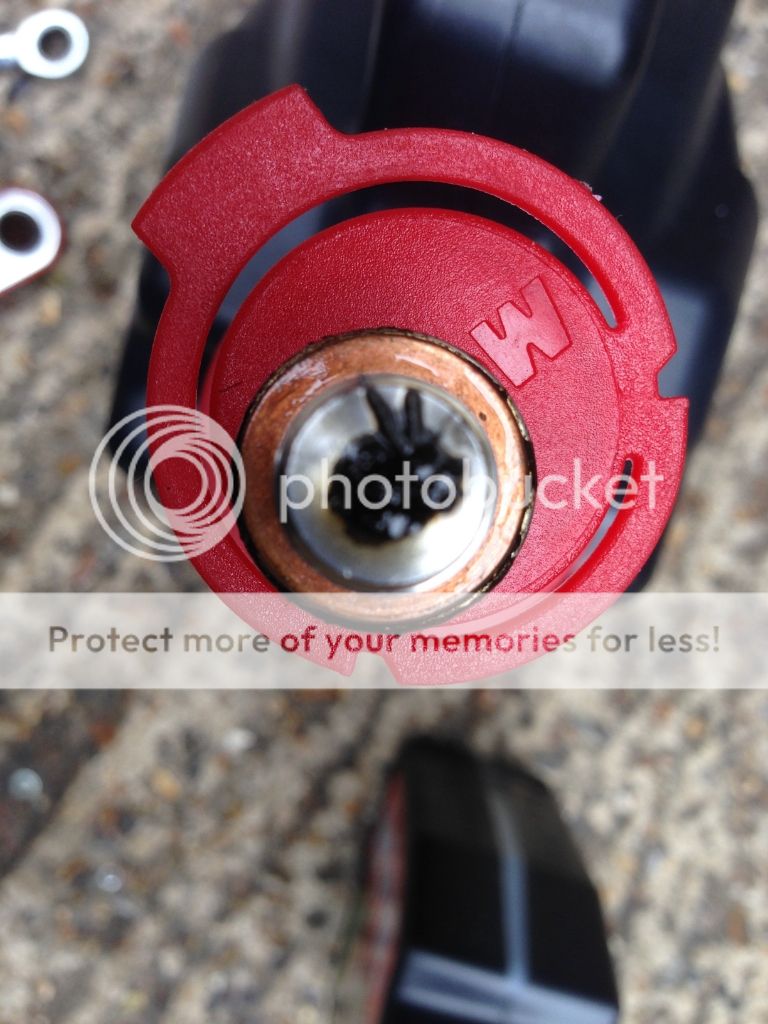

Changed the oil in the ER6 yesterday, it's had two oil changes in my ownership, immediately after I got it then a few weeks later as i changed the filter after effectively a 'flush' with fresh oil. Hence they were quite close together. I should've changed it before now really, I've done about 3K and put in a magnetic sump plug at the last change. On the sump plug when it came out were about 3 or 4 strands of what I can only describe as fine wire brush like pieces of metal. 1/2 inch'ish long.
I'm going to change it again in about a month or so and see then. Should I be worried, other than that it's all ok. No issues at all.

I took a pic, but the phone focused on the edge of the plug so not clear, not the actual swarf, I'll upload anyway.

Joe wrote:
Never picked up any big bits of metal, but quite often a sort of charcoal grey colour very fine dust/sludge.
In addition to the bits I mentioned, I had some of that sludge. Here is the pic, as you can see camera focused on the top of the oil!

This is what magnetic drain plugs are for, it's the microscopic shavings from quite normal wear that tend to form strands due to the magnetic lines of force. The time to worry is when the bits on the magnet are big enough to see as metal flakes.
