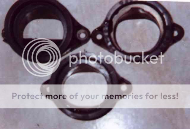

They had however left the standard restricted intakes in there. See top left in this photo.
https://i1291.photobucket.com/albums/b545/paddynewman/tl1000_manifold_restriction2_zpse951bddb.jpg
I set away with a drill and a file to remove the solid crescent of shit rather than pay Mr Suzuki £90. Worked perfectly Laughing

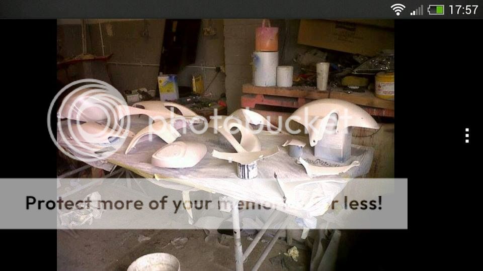

Loaned it to Doovy so he could have a bike after he sold his and unfortunately someone damaged it. Didn't bother me too much, although I had to comfort Doovy who was gutted! The guy paid out for the damages in cash though so I can't really say anything bad about the situation Thumbs Up
This is the damage caused.
https://i1291.photobucket.com/albums/b545/paddynewman/tldamage_zps7def0b63.jpg
With the money the guy paid me after I priced up all the parts and bits I could either buy the panel required or pop a little more cash in and get the full respray. I chose the latter. Means I get the repair done, it becomes mint again and everyone is happy!
This is the current status
https://i1291.photobucket.com/albums/b545/paddynewman/tlwhi_zps0563e499.jpeg
