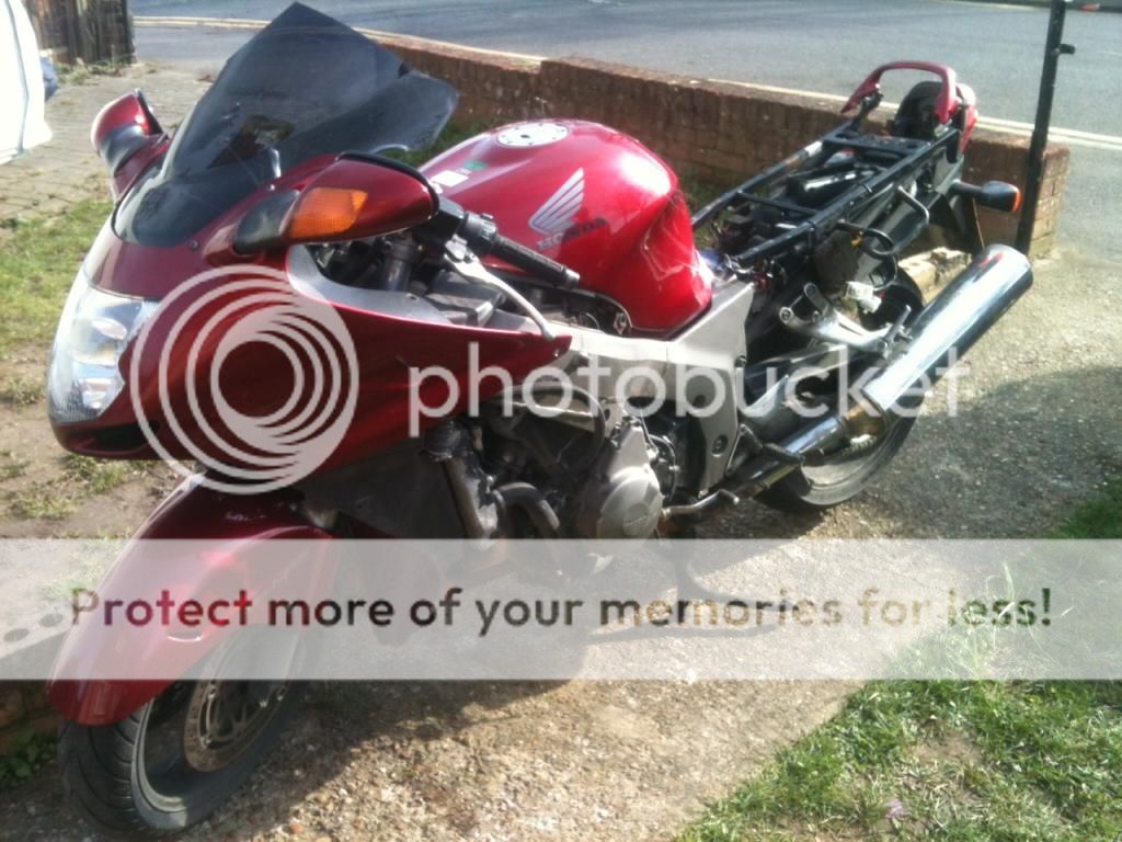

I am a right spaz with electrics so this is way over my head. Still not been able to get a spark plug out as they are buried underneath a plethora of plastic and wiring. I would hope it is just spark plugs, as the bike bumps (or at least did prior to me taking the rear plastic off) but then the battery was failing to charge.
Oh the joys...
Oh and pic... sorry, grabbed quick one before work.

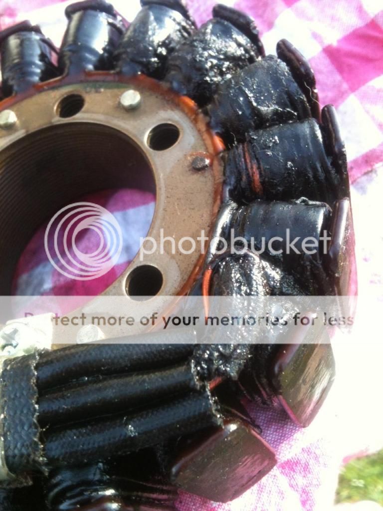

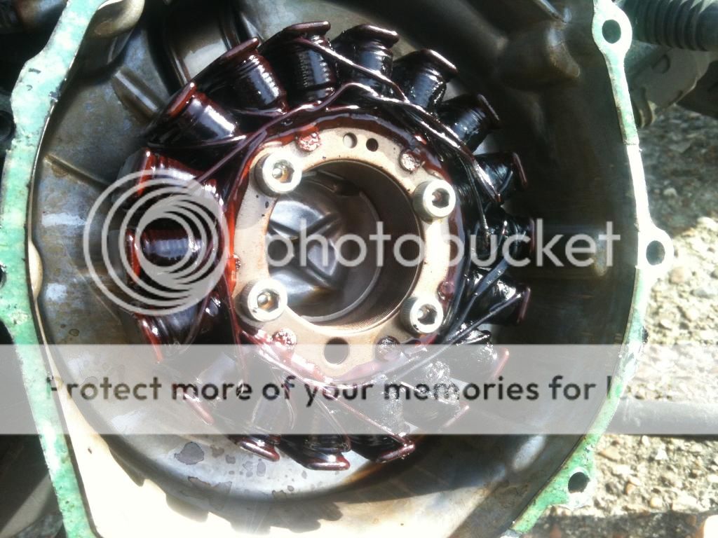

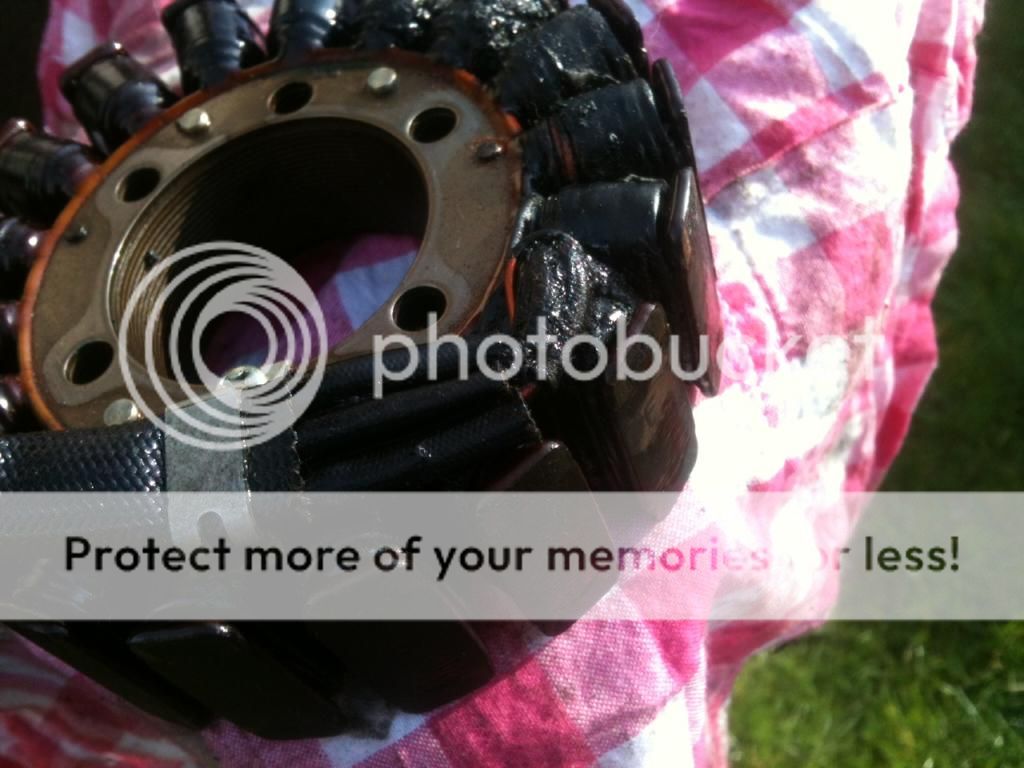

PostPosted: 15:52 - 08 Mar 2014    Post subject: Reply with quote
Tried everything.
Resorted to the strip down...
https://i1291.photobucket.com/albums/b545/paddynewman/bb/image_zps3836be2b.jpeg
https://i1291.photobucket.com/albums/b545/paddynewman/bb/image_zps969afc2f.jpeg
https://i1291.photobucket.com/albums/b545/paddynewman/bb/image_1_zps9a89a24c.jpeg
https://i1291.photobucket.com/albums/b545/paddynewman/bb2/image_zps697def15.jpeg
https://i1291.photobucket.com/albums/b545/paddynewman/bb2/image_1_zpse980b6a8.jpeg
Oh stator, you so crispy. Wub

PostPosted: 15:56 - 08 Mar 2014    Post subject: Reply with quote
So was that caused by being gently dropped?
Pete.
PostPosted: 16:01 - 08 Mar 2014    Post subject: Reply with quote
Looks like it's been rubbing on the rotor. Are the windings actually knackered? They don't look it. Try a phase-to-phase ohm test.
