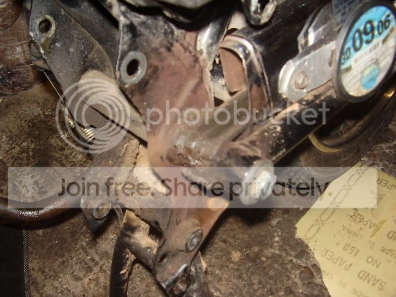

Hi, Whilst my bike is off the road, i have decided to clean the whole bike up a bit as it was looking a bit manky in those "hard to reach" places
This is the bolt which is causing me some grief now

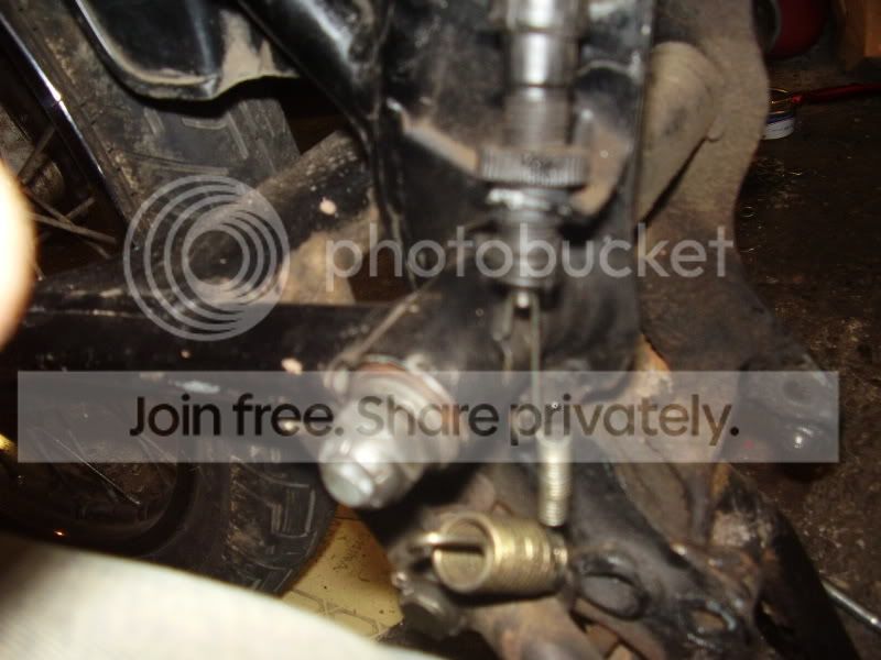

The nut on the other side (also helps to hold the exhaust) comes off nice and easy.

Tried hitting it but not that hard as to damage the threads
Any ideas?

bit of heat mabye that can help or loads of penertration fluid, tried putting a decent socket on it and jumping on the ratcheted one swift kick or hit can help disloge it more than pulling hard

Heat, penetration fluid (there's far better stuff than WD40) or impact driver.

Don't hit the bare spindle, put the nut back on as far as you can but leaving a bit of space behind it so it can move, put a piece of hardwood or soft alloy, if you've got it, over the nut and hit that. If the nut is nearly full on you can give it a fair clout without damaging the threads.

There's a couple of old threads about getting those bloody things out. When they get stuck, they get proper stuck because they rust into the bushes or bearings burried pretty deep inside the swingarm. That means "gentle" methods won't work on it and you have to resort to a sledgehammer and accept you're going to end up breaking something.
Although I did once get one out by soaking it diesel for 2 weeks Smile
Unless you are really comitted, just leave it as is and work around it.

I had the exact same problem a few months ago. The only way i got mine out was using a Hydraulic Pusher/Puller.
If you can borrow one of these u'll have it out in under 10 minutes.

had the same problem on my CRM. simon (babykat250) took the frame to college and removed it with their gear.
it'll likely need replacing anyway if its that stuck so try a 3/8th extension against the end of the bolt and hammer it out.

Is the bolt seized and wont turn, or is the spindle seized and cant be hammered out?

Its the actual spindle that goes through the swingarm and through the frame, The nut is free
Ive got it to move about 1 - 2 mm by hitting it hard with a hammer on the thread side, but its still Very stuck

I did'nt have any problems with removing my rear spindle, just some good hard taps with a hammer. Hit it, dont just tickle it Laughing
You could always place a piece of wood against the metal so as not to damage the threads too much. I found that using something like a socket head or extension was handly for hammering it out once its 'enetered' the frame, then just wiggle and pull with clamps from the other side.

Fill the gaps on both sides of the spindle with penetrating fluid, knock it back in, wait a few hours, try again.
If you get another mm out of it, repeat until it comes out/you get bored Smile

Its just as whoesthedaddy says, but are you trying to do it with the rear wheel in place (going by picture)? If so your gonna really struggle.

The wheel was out when i tried it, but put it back in after i had 1/2 given up with it Smile
Then taken some snaps / cried for help Embarassed
Well its moved about 2 inches, but its still stupidly tight, ive just put it back and will leave it for now, Thanks for the help and advice

If you've moved it 2" you have no problems, it's when they don't move at all is the time to worry.
