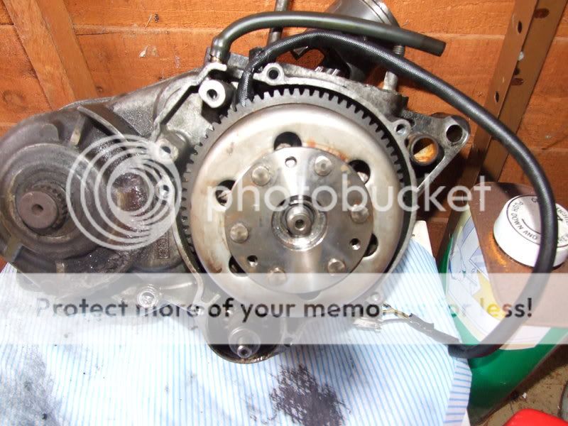

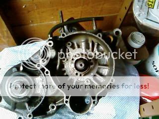

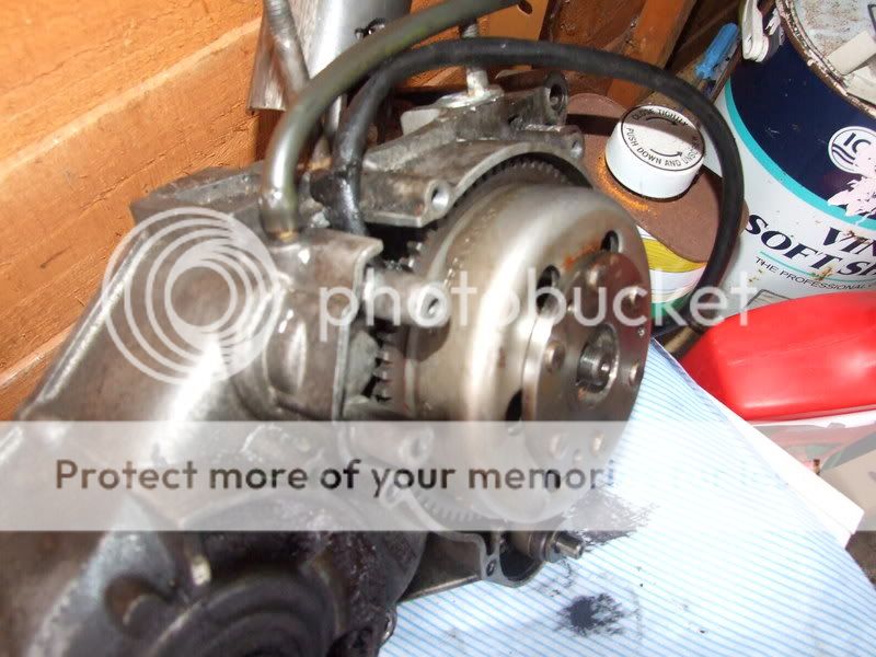

here it is! thanks
https://i77.photobucket.com/albums/j76/pit_bike/Picture004.jpg
https://i77.photobucket.com/albums/j76/pit_bike/Picture005.jpg
https://i77.photobucket.com/albums/j76/pit_bike/Picture006.jpg

the only thread is on the crank axel. none on the fly wheel its self!
the first one looks the right one but how does it work because its pushing against the fly wheel. or does it push the crank out?

On some of those pictures there is a big metal plate supplied with the puller. You need to bolt the plate onto the flywheel, then the puller attaches to the plate. i.e. the puller on it's own (first link) isn't enough.
Looks like you would get away with using a general purpose puller (see other thread!)

Bit of a bodge way of doing it, but put a nut onto the crank (so it protects the thread) then whack it with a hammer/brick/heavy object.
May require WD40 and a crowbar.
Try not to damage anything.

i did this recently on a little 33cc engine, talked about it here
https://www.bikechatforums.com/viewtopic.php?t=138723 (already linked by big-ham)
I did it by holding the engine in the air by the flywheel (easy on an eninge that small ) and hitting the shaft with a hammer, after soaking in in WD40. Just let the engine drop onto something soft. You can see the tapered shaft/key in the last pic on my thread.

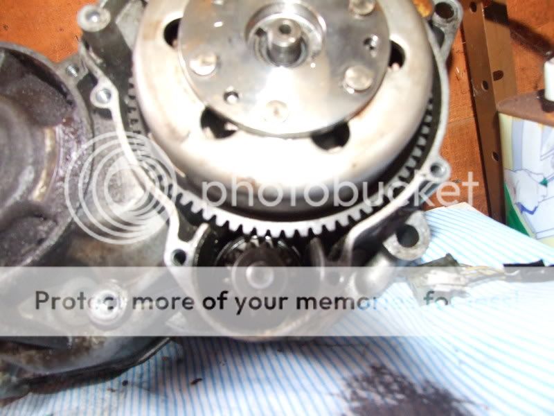

i have now got the flywheel off. but i carnt get the crank out haha. the crank bearing was siezed but i freeed it up. i have hit the crank with the bolt on and it shired the bolt off. the crank threads are ok though. any advise?

https://i77.photobucket.com/albums/j76/pit_bike/SP_A0511.jpg
i want to reuuse the crank. so i dont want to bodge it!
