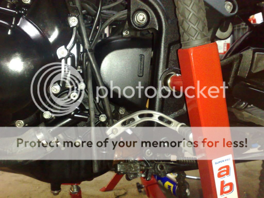

I agree with Keith, all the bikes I have had have had 2 hoses coming from the bottom of the tank that go to the bottom of the bike you should see them hanging down slightly. Lift the tank up then put it down but as you are putting it down get somebody to pull on these lines gently to keep them taught this should stop them being kinked.
https://img.photobucket.com/albums/v295/chris-red/06052009225.jpg
Here is a picture of mine from the Speed Four.
