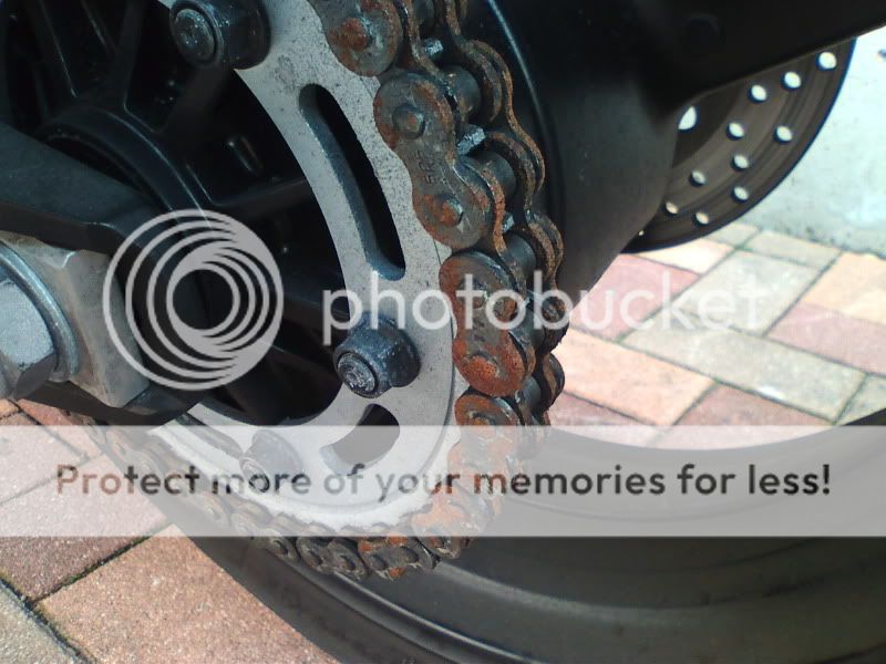

Today I noticed my chain had rusted slightly.
I sprayed chain lube on it. Is it ok or not? Should I remove the rusted surface? If so, how should I do it?
I didn't think it rusts only in 4 months, and I was told once that I spray lube too much, I didn't spray intentionally but it was wrong.

You should have seen the state of my chain during the winter. Once I wasn't using the bike for a week and when I got back on it, you couldn't see a single bit that wasn't covered in rust on the chain. Yours is still in a pretty good condition compared to that.
To be honest I wouldn't worry about it too much, try to wipe off as much as you can, lube it, ride it, and it will be good as new. (well, almost) Oh and check for stiff links .

Give it a good scrub with some WD40 and a brush or a rag. Then wipe the WD40 off and put some more chain lube on Thumbs Up

I wouldn't use wd40 on a chain.
It is only surface rust, give the chain a good covering with chain lube and take the bike for a ride. That should get rid of the worst of the rust Smile

As WD40 is a penetrating oil it will remove the grease from inside the X/O rings.
If you need to clean the chain, then I use cheap engine oil on a rag, and then wipe the chain.

WD40 gets inside the o rings and removes the grease which will shorten chain life, just lube it, I clean mine with petrol and one of these.

WD40 is safe to use on O-Ring chains, the O rings are sealed and it does not get inside. I always use it to clean my chains and it does not shorten the life of my chains. WD40 guys say it is safe to use to clean chains too.
WD40 does not even damage rubber even if it did happen to get to the O-Rings...
PostPosted: 17:34 - 26 Apr 2010    Post subject: Reply with quote
If the WD40 is getting past the O ring, the O ring has already failed.
