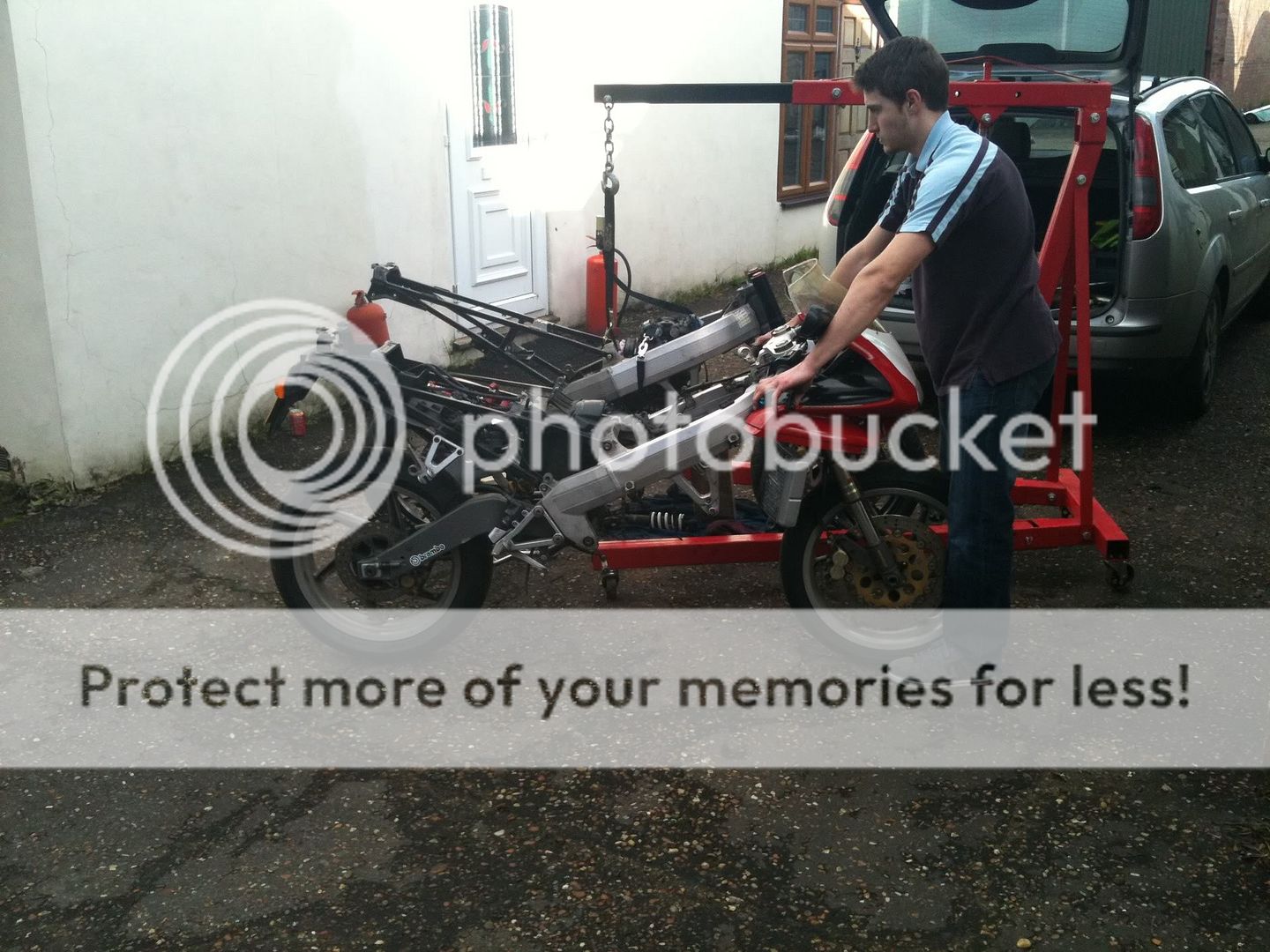

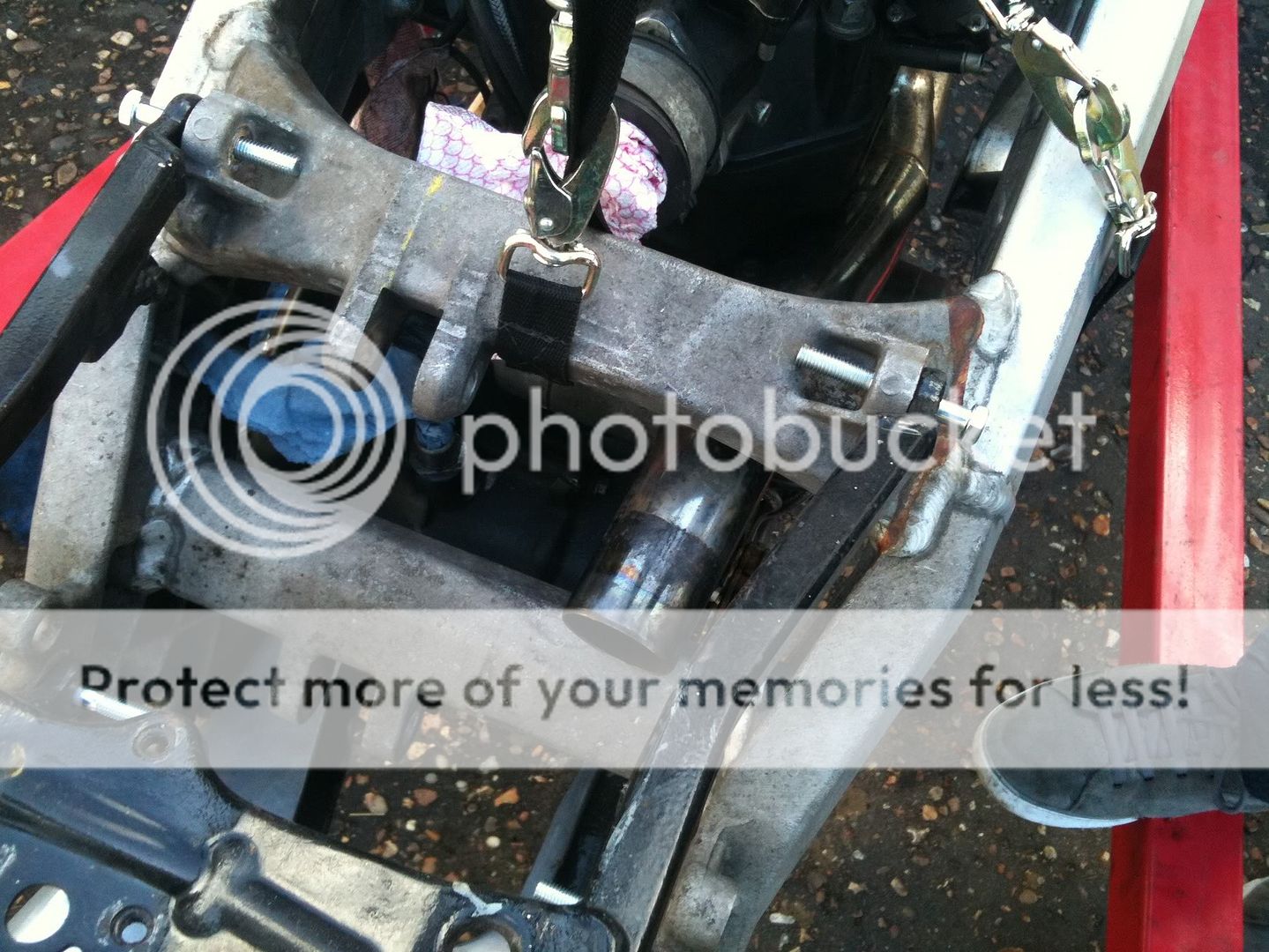

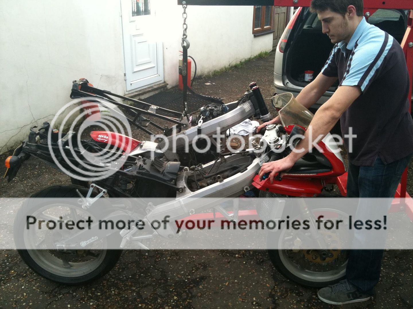

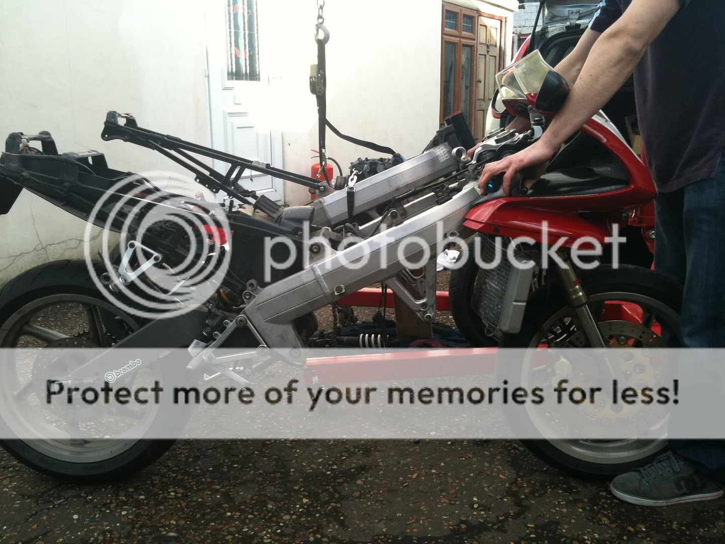

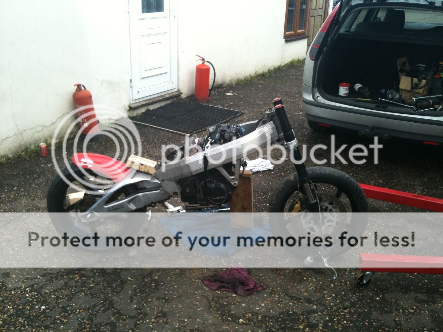

i might as well start the thread now then.
yes it a Mito KTM frankenbike.
so kind of sheer fortune meant that this project is a goer.
on ebay the other day i saw a KTM LC4 640 engine and though, yeah that looks good but the sprocket is on the wrong side to the Mito (which i already have) so i also found an aprilia RS125 front and rear end.
so me and chris-red went to pick it all up and had a go at bolting it together, bearing in mind i hadnt measured anything or investigated wheather or not this would work.
the RS125 swing arm fits in the Mito frame with around half inch of play. the swing arm wraps around the rear mount of the KTM engine like it was designed to fit it. Like a glove (in an ace ventura voice) and the engine also sits within the frame with small gap between what i think is possibly a water pump housing and the inside of the frame. the RS125 front end we put on just to see how it all looked.
so heres some pics adter about 2 hours work

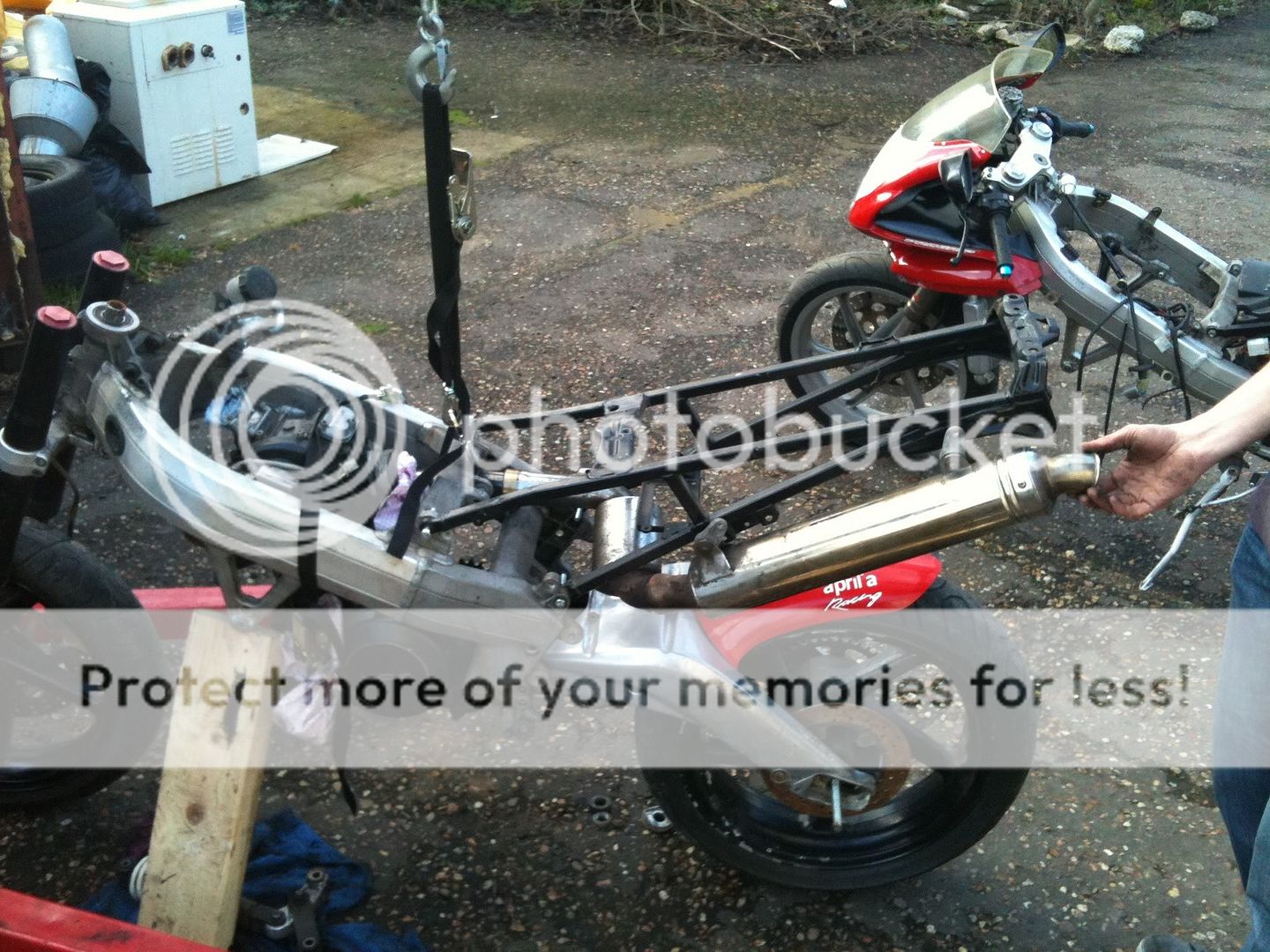

Exhaust Routing
