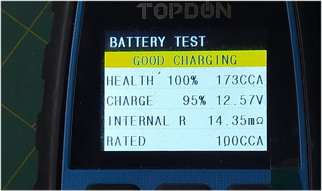

My Battery analyser has been a very useful tool for checking car/van/bike batteries
especially this time of year when temps drop and battery weakness can manifest itself.
A year or two ago it help prove a mates new battery didn't have anything near the cranking amps
it should have had, so a replacement was given (and immediately tested of course)
It's also useful to check if those spare batteries are worth the space they occupy and just been checking some of mine.
I keep a few old bike batteries for bench test/experimends and stuff and this one still exceeds the stated CCA so it stays
